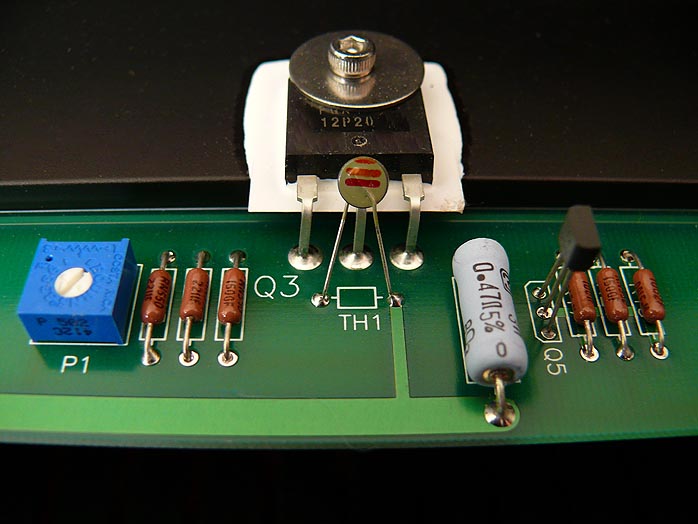

When setting the bias on my F5 I used tape to hold my DMM k-type thermoprobes to the heat sink and FETs. It occurred to me that the k-type probes are probably just a thermistor on the end of a wire. I know there are a lot of different types of thermistors but I was wondering if it's possible to just clip onto the F5 thermistors to get an on FET reading or will the DMM throw off the temp compensation circuit and vice versa the temp compensation circuit would throw off the reading of the DMM? Depending on the thermistor couldn't we have a table of resistance values to map to temperatures?
1) not everyone has temp on their dmm or a separate IR temp gauge.
2) wouldn't it be a more direct reading of the FET than through a heat sink? Putting tape over the thermoprobe tip to adhere it could help retain heat and throw off the reading.
3) could be a check point for the thermistors and give visibility into what's happening in the heat compensation circuit.
4) isn't it easier to clip a couple of leads to the thermistors than placing a thermoprobe by tape? With tape I worry whether it's touching or if there's a slight minuscule gap, also, slight movements with the cables could move the probe tip.

Thanks ZM for the reply. Yeah, I just thought it might be cool to check the thermistors instead but I guess palm to heatsink is practical enough. My curiosity still has me wondering how much of a difference there is between heatsink temp and the thermistors.
I also recall asking last year about placing the thermistors touching the FET casing vs the drain leg because I had read on the FET spec sheets that the drain leg gives the highest temp and I noticed the First Watt pics show the thermistors touching the drain. But it's more practical to just have them touch the casing instead with no chance of shorting the FET.

The faster the Thermal path from the heat generator to the heat sensor, the more quickly and with less overshoot can the sensor react to the change in heat in the generator.
For that reason many have looked at fitting output stage sensors closer to the heat generator. Sanken and OnSemi have a range of devices with the sensor inside the output device package. Cordell and others have written up how much this improves accuracy of the sensor correction strategy. Self looked at mounting the sensor on top of the metal To3 device.
The Thermistor of an F5 is just such a sensor.
It should, for best correction performance, be inside the output stage devices.
The next best is glued to the Drain lead at the point where it exits the package. If this gives too much correction for changes in heating, then the solution is NOT to move the Thermistor to a longer delayed thermal path.
The proper solution is to change the tempco ratios so that the correction matches the change.
To date I cannot recall anyone suggesting changes to the resistor:thermistor resistance ratios to change the tempco.
Pass did bring out a modified topology of where the Thermistor fits into the feedback circuit. This may have been prompted by looking for a better tempco to more accurately sense the changes and make the necessary correction.

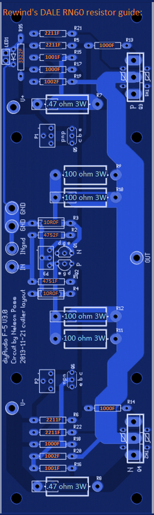

For the lazy f-5 builder:
Cvillers F-5 v3.0 pcb board is nice, but differs from the Cviller v2.0 BOM in the DiyAudio.com shop. I lost a night of happy amp building because of this "update", so I spent the next night going through the resistors and flexing my skills in MS paint.
The guide is based on the non-turbo F-5 amplifier schematic in the Nelson Pass F-5 Turbo article, using Dale RN60 resistors. The .zip file contains an Excel file with the schematic and a list of resistors, if you want to double check. You should!
I used this site to search values: http://www.datasheets360.com/part/detail/rn-55-d-1001-f/-746750307682916945
