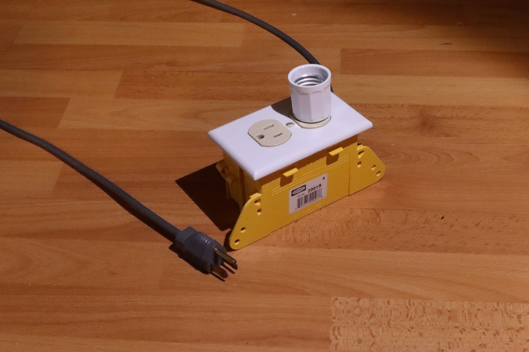

And I have no variac, can you describe what is lightbulb mains lead?
Dim Bulb Tester.
Use for first power up. It is a current limiter in case you have a short circuit in your amplifier. If your amplifier passes the dim bulb test, you can then power up without the Dim Bulb Tester.
Here is some information on buillding one. My tester is similar in construction except I omitted the on-off switch.
How to: Dim Bulb Tester

Thanks a lot. I had built and have been using the same setup Benmah, only except I was stupid to have forgotten to hook it up on my very first power up. Thats when the fuse went off. I will never start without it until all set up.
By the way what would be the ideal bulb wattage for this amp??

After you've followed 6L6s post in #2087 please share your results. I look forward to hearing that you've got a wonderful sounding amplifier.
:cheers:
Well dear Allin. It seems like I will have to wait until I visit my friend’s shop in another city (who owns several DMMs), as I have only one dmmeter and a digital oscilloscope, and I doubt that the scope will be useful for this purpose. ☹️
