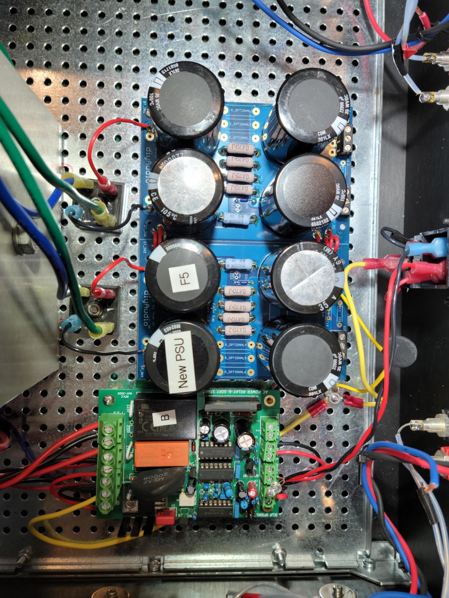

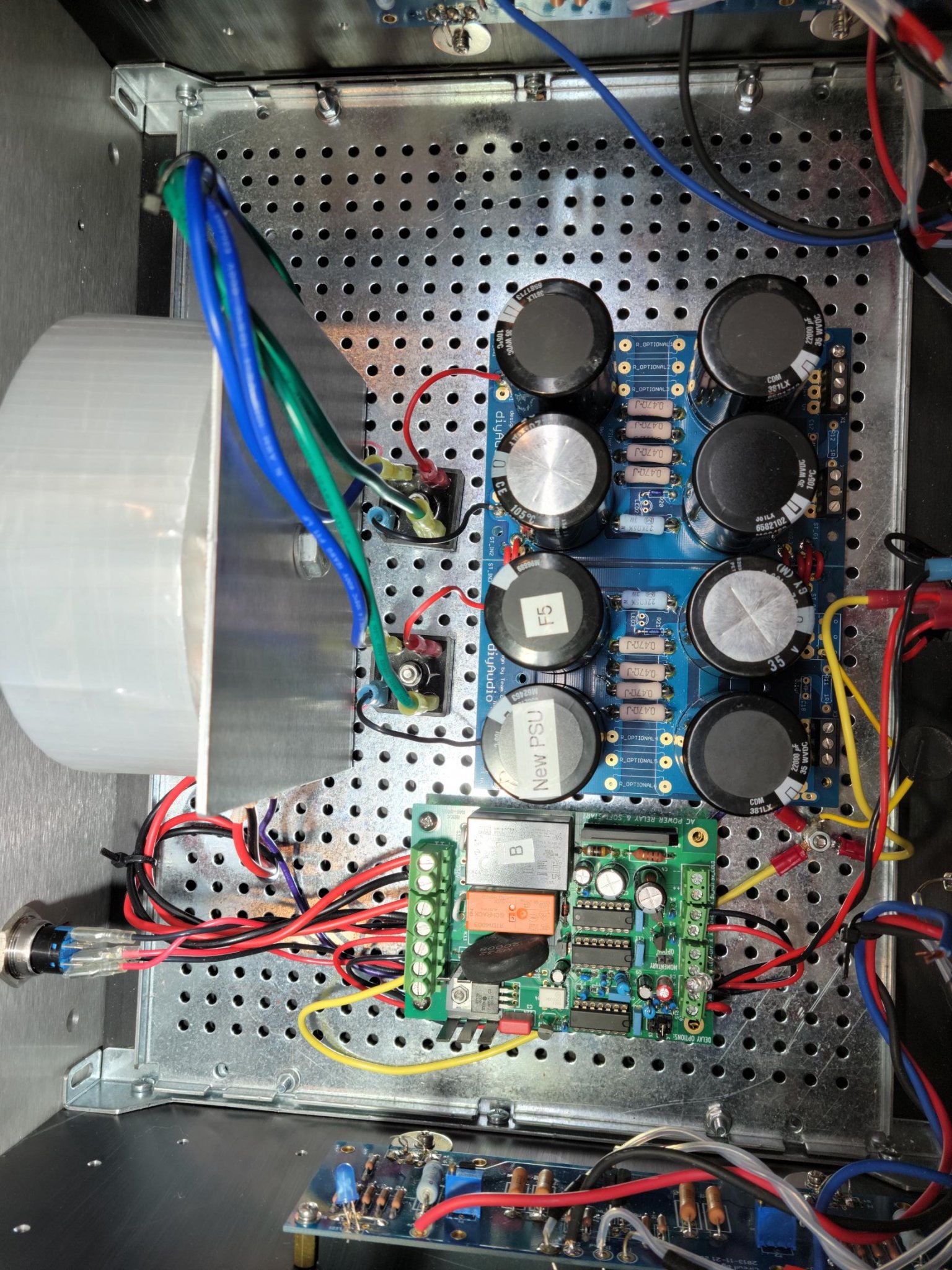

This is where it all began for me, building my first First Watt amp.
I recently ported over everything od that build to a 4U case. The 5U was too big.
But when I turn it on [amp boards not connected], the 3A slow fuse blows.
I thought it was the IEC, but It'sallinmyhead spent some quality time with me and now I've got a diyAudio IEC installed.
Before the fuse blows, the slow-start CB LED lights up, when I push the on button, that lights up and I hear a click from the slow-start CB, which tells me that is all working correctly.
I swapped out my original PSU board for a new one, but no dice, fuse still blows.
I'd appreciate some fresh looks at this.

walk it back.
unhook everything.
hook up the slow start board and see if fuse pops. No fuse pop.
add x-former and see if fuse pops. No fuse pop.
add rectifiers and see if fuse pops. No fuse pop.
add PSU board and see if fuse pops. [New PSU] Fuse pops. I swapped in the original PSU board that that blew a fuse too.
I have two PSU boards. One from the original F5 board, and one I built to swap in to see if the first PSU board was the issue.
Both PSU boards blow the fuse.
6sX7, thanks for the guidance
Joined 2004
The bolt holding the transformer isn't touching the front of the case by any chance is it?
Amp boards not connected so it's either the xformer or the PSU or the slow start. I can't see if you have a shorted turn (xformer mounting bolt is making contact on the other side) but I would bet on a problem with the slow start. Try bypassing that first ... process of elimination.

Great, I will look into this, it might very well be the culprit in my case. And how should P3 be adjusted? Thank you.

That totally seems to solve my fuse-blow issue. I really appreciate it. I would never expect such a detrimental effect of that adjustment.
Center P3. You can come back to that later.
Dear andynor, I made the correct adjustments on P1 P2. But amp is not working. The test speakers I use give extremely weak sound out, as if I would have directly connected the source to the speakers. And the heatsink is dead cold even after 10-15 min working. Where should I start my checks? Measure voltages at the legs of power mosfets? What should the values be? When I first powered on without pot adjustments the fuse had gone off. Do you think some of the fets fried?
