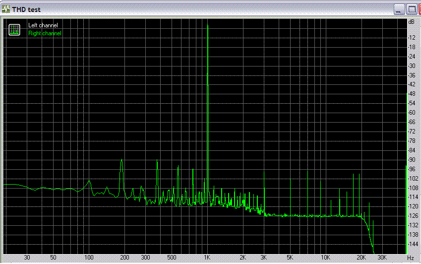

MJL21193 said:Looking at the scale the higher harmonics are about -100db, including the 4th. That's a long way down.
Are you sure this is hard to listen to?
That is quite far down, but those order harmonics are not natural and the ear/brain is amazingly good at detecting them.

Subtract from that the measuring devices native distortion (in this case a sound card) and that drives it down even further.
This is a relatively high power class AB amp. That test was taken at ~4 watts output.

planet10 said:
Yes... looks like a PP amp with little or no 2nd order, but a fair amount of 4th and some higher. Anything above 3rd the ear really finds objectionable, and the lack of 2nd means the 3rd isn't as well masked. An ideal spectrum would have some 2nd, a bit less 3rd, and vanishingly small higher order components.

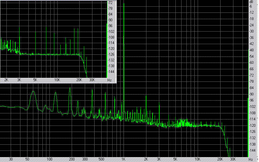

My amp, RMI-FC100, at the same output power - 4W rms
planet10 said:Yes... looks like a PP amp with little or no 2nd order, but a fair amount of 4th and some higher.
I didn't look closely enuff at this chart. Spectrum charts are usually produced with a linear scale so that all the harmonics are equally spaced... i just looked at the shape and didn't note that the charts posted have log scales making them trickier to interpret. Both have close to equal 2nd & 3rd. Above that John's have some much higher order spikes i'd be inclined to assign to the test gear, but need further investigation.
roender, your chart has a 20k fundemental... do you have one with a 1k fundemental?
On yours 2 is close to 3 then 4 is close to 5, and 6 close to 7. That they exist at all with a 20 k fundemental is a tibute to your amps bandwidth. If the fundemental was 1 k those last 2 might prove quite annoying.

Sorry for the confusion Dave. Default for RMAA is log, so that's how I presented it.
Attached is the sound cards distortion (used to make the measurement on the amp).
I was trying to say that class AB is fine at low level output, with very good, low distortion sound.
Not bad to listen to at all, on any speakers.
MJL21193 said:Sorry for the confusion Dave. Default for RMAA is log, so that's how I presented it.
Not a problem... i'll know to look closer next time... that card adds enuff of its own to make critical analysis tough, but it does look the source of the real high order stuff.

RMAA is not perfect. It gives a fair idea of of noise floor, THD, frequency response, dynamic range, IM+N, but in the end you need to deduct the sound cards performance.
It's good enough to judge an amps real world performance, as it can be tested while connected to a real speaker load.

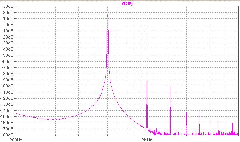

Here is one... (i've seen reference to the level, but can't remember)... this is a Class A differential amp based on an ST70.
SE amps will typically have more 2nd and less of everything else. 2nd can be quite large before audible, 3rd is OK as long as the amount of 2nd is higher, 4th, 5th, ... are where things get annoying.
