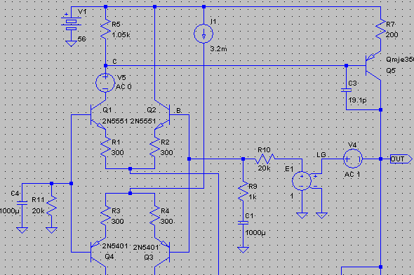

Let's look at the impedance at the collector of the input diff amp of the complementary amplifier, since both Jan and P-A have brought this issue up previously as well. After responding to Dave S about input capacitance, I then changed my mind, thinking that the collector load impedance seen by the diff amp at high frequencies would actually be lower in the conventional configuration than the cascode configuration. I reasoned that since this impedance establishes the dominant open-loop pole, that said impedance would be very low at the input low-pass filter cutoff frequency (probably a hundred kHz or so). While the collector load impedance does establish the dominant pole, there is also a zero in that impedance which causes the impedance to approach a constant value as the frequency becomes large. That constant value turns out to be much larger than the load that a cascode would place on it. So I was right the first time and wrong the second.
Let me clarify how this zero comes about. Below I've shown the original complementary design with a couple of new nodes labeled. I've grounded the input for AC, and placed the node label "B" on the base of the diff amp that's inside the feedback loop, and the label "C" on the collector that drives the Miller integrator. There's a voltage source in that collector whose value is zero. It's there only to probe its current as I(V5) so I can compute the impedance. There's also a node labeled "OUT" at the output. Excitation is at the floating source V4 in the feedback loop connected to the output. Let's look at the open loop voltage gain of the amp as a whole, and the open-loop gains of the diff amp and VAS. Finally I'll look at the collector load impedance. More to come...

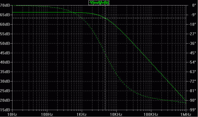

Below is the open-loop gain of the amp. Its value at DC is about 66 dB, nothing earth-shaking. Cascoding the VAS would increase this quite a bit. The dominant pole is at 4.64 kHz. We see a nice single-pole behavior out to a bit less than 1 MHz. No surprises here. Now let's see how this splits up between the diff amp and the VAS. That's when things get interesting...

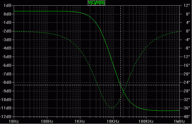

Here's the voltage gain of the diff amp. It is 3 dB down at 4.98 kHz, a little higher than the 4.64 kHz of the overall amp. That's because of the presence of the zero that's causing its gain to approach a constant at high frequencies. I've estimated the zero by finding the frequency where the gain is 3 dB higher than its asymptotic high frequency value. That's about 16.6 kHz.

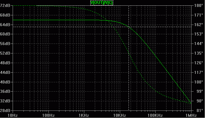

Here's the voltage gain of the VAS. Note that it has a pole, but it's not the open-loop pole of the overall amplifier! It's 3 dB down at 17.6 kHz, while the overall amp is 3 dB down at 4.64 kHz. What's happening here is that this pole is exactly canceling with the zero of the diff amp gain. Let's see how this happens. Now that we know where this pole is, we can use Miller's theorem to get an idea of the impedance seen by the input diff amp collector.
We normally use Miller's theorem to compute the input capacitance as
Cin = Ccomp * (1 - Av)
where Ccomp is the compensation capacitor and Av is the voltage gain of the VAS. However, the voltage gain is now a function of s, Av(s), with a DC gain A0 and a simple pole omegaVAS. So we need to use the more general form of Miller's theorem, in which the admittance of the capacitor is multiplied by (1 - Av(s)) to find the input admittance (taking into account that Av(0) is negative). When we do this, it becomes clear that the input admittance has a pole at the same frequency as the pole of the VAS. Therefore, the input impedance has a zero at the same frequency as the pole of the VAS. So that's where the zero of the voltage gain of the input diff amp comes from - the impedance the diff amp sees has a zero at the same frequency as the pole of the VAS. Since this zero is at the exact same frequency as the pole of the VAS, they cancel exactly, making the open-loop pole of the amplifier the same as the open-loop pole of the input diff amp voltage transfer function. Whew!

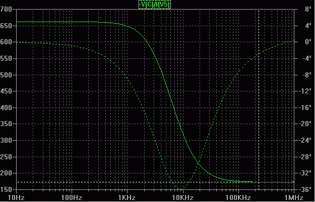

Finally, here is the load impedance seen by the collector of the input diff amp. Note that the zero whose origin was described in my previous post causes it to approach the constant value of 173 Ohms at high frequency.

So my conclusion is that if the input diff amp is cascoded, the collectors will see a load impedance of
26 mV/1.6 mA = 16.25 Ohms
which is much lower than the impedance shown below. So the input capacitance of the amplifier will be lowered by cascoding.

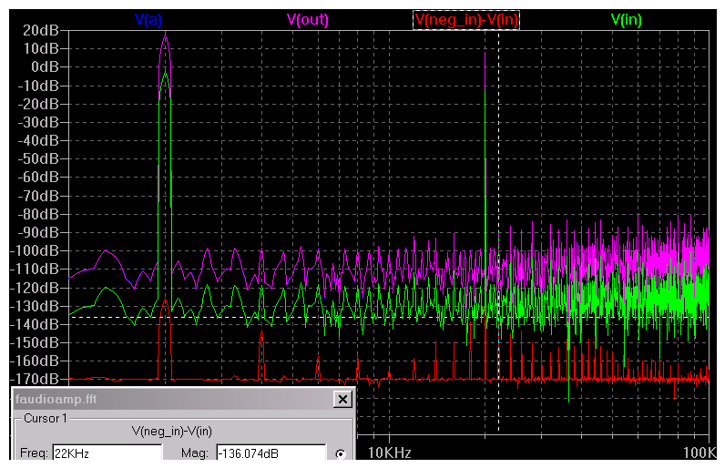

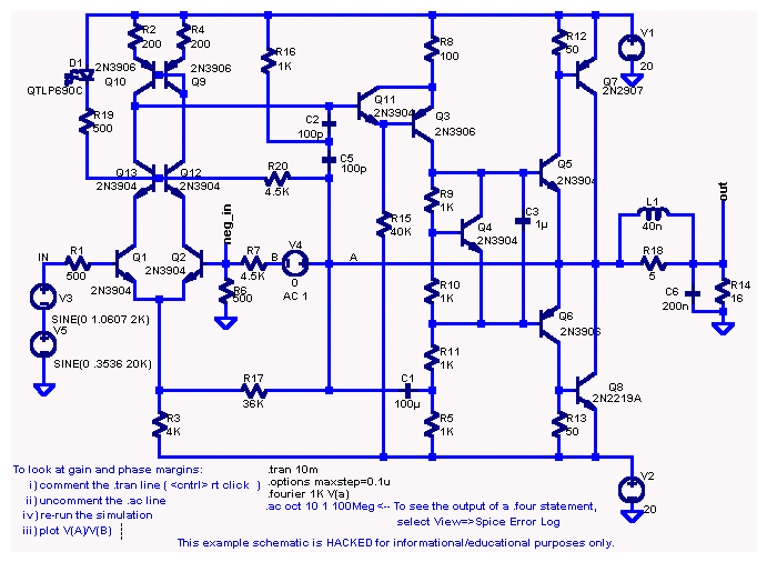

SwCad III analysis shows highest distortion component of –136 dB with a highly asymmetric topology, 2nds higher than 3rds – I think the ridiculously low distortion levels in this example should demonstrate the futility of much of the earlier argument over the influence of symmetry on distortion, the subject is too subtle and sensitive to too many design variables for the present level of discussion/simulation to have any hope of revealing “deep truths” – read Cherry!
I started with the SwCad audioamp.asc example circuit; changing the quasi-comp output to complementary Sziklai pairs, Super Paired the VAS, current mirrored the Diff pair and added input cascodes (just to show comments about input cascodes increasing distortion to be as mistaken as anything else I’ve seen in this thread – read Hawksford too!) doubled ps V for +20 dBV output ( increased Rload, still looking good for 2N2219/2907 output Qs – sot-223 with good heat sinking could actually handle the pwr)
LT SwCad III gives higher fft res with the usual (in my Pspice experience) tweaks:
crank the tol values in the Control Panel>Spice menu ‘til it don’t work and back off a little
set max step size < 1/200 of your highest frequency in the .tran statement

You can still see the SwCad Vin sine source has some numerical hairiness that raises the distortion floor above where we might want to be able to see. Fortunately we can “notch out” the fundamental and extend our resolution by simply looking at the differential input voltage at the amplifier’s input.
The input is 4:1 2KHz + 20KHz with a peak amplitude of 1.414 V to fool SwCad’s fft into calling it 0 dB and give us dBV. The lowest trace is the differential input voltage and the distortion component fft peak values correspond to the distortion components rms values re the input peak amplitude of the composite waveform; 2Khz input component is –2.5 dBV, 20KHz –17.5 dBV, the input signal level and distortion measured at the input are all raised by 20 dB by the amplifier’s closed loop gain of +10, leaving the distortion at the output re peak output level the same as the input referred measurement

cascode on LTP pair
The cascode decreases input capacitance by eliminating the Miller effect. This is beneficial, because the Miller capacitance is a function of voltage and can hence introduce common mode disto if driven from a high impedance (1-2 k as in feedback network is probably enough to make the effect visible).
As Andy pointed out, this results in less input filtering, and hence more RF dirt may get amplified. The solution is to but a bigger cap into the input filter => higher internal bandwith, less distortion, same external bandwidth.
Cascode operation is best thought of in current mode (as Andy proved with his simulations). I don't think the input transistor cares about the low collector load impedance. Actually, you arrive at this low impedance because voltage swing is limited (R=delta U / delta I), but it doesn't have much meaning.
The cascode transistor passes on the current, the only error source being its own base current. Distortion-wise, we only have to think of the change in beta over the collector current modulation we have, so this is probably less than 1/10000. I am not sure whether this is significant additional distortion.
On the other hand, the input transistor now operates at almost constant voltage, which greatly reduced the early effect and hence improves its linearity.

Sajti,
I have not yet built an amp with an input cascode nor listened to it (except for a buffered OPA627 in my preamp, which does have a cascoded FET input), so I won't argue with your subjective findings.
What Jonathan means is that the base of the cascode transistor should be decoupled as close to the transistor case either to a good AC ground or (preferably?) to the emitter of the input transistor. Coming to think of it, in some transistors this near zero impedance on the base might actually invite oscillation, so a 10R resistor between cap and base might actually be a good idea.
When I built my current main amp years ago, I used a 20 MHz analog CRO at home, and was wondering about a few effects I could not explain. What a difference it was when I took the amp to work and checked with a 400 MHz scope!
And please let me stress again: thinking in terms of a resistive load on the input collector is the wrong way. Forget for a moment about LTPs and a VAS which needs current drive. Assume you have a single transistor in common emitter configuration, maybe with a little emitter degeneration. The voltage on the input makes the transistor conduct a certain current. If you have a resistor in the collector lead, the current will cause a voltage drop. As you increase the resistor, the voltage gain will increase, but the current is still almost solely determined by the input voltage. Replace the resistor with an ideal current source, and the resistance will still be final, the gain being limited by the early effect and the collector current.
Now add a cascode transistor. It will pass on 99,5% of the current if hfe=200. The voltage drop is still generated by the current, only that the resistor is now in the collector lead of the cascode transistor. The cascode transistor introduces a little bit of distortion, namely the variation of hfe with current and voltage. This is most likely offset by a huge improvement in the linearity of the input transistor that can now operate at constant voltage.
And last, not least, input capacitance becomes both smaller and more constant.
Eric
