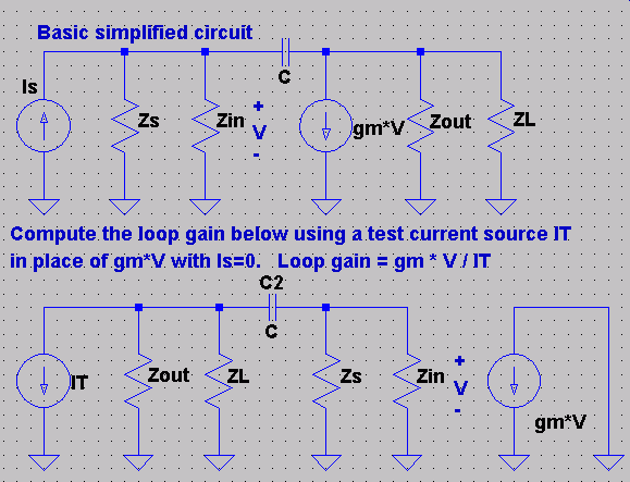

I see I've caused some confusion. I have no scanner, so I tried to describe the circuit in words. Bad idea! :) . I tried sketching out the symbolic circuit with the LTSpice schematic capture and it came out okay. I've shown it below. My thought was not to model the circuit at a device level, but rather to have the simplest possible "macro model" (for lack of a better term) for whatever combination of devices are used in the Vas. My hope was to get a result simple enough that I could obtain some intuitive information from it. So the term "gm" I used is not the device-level transconductance, but rather the y21 value of the composite network. It's only equal to the device gm for a standard CE amp with no emitter resistor.
I do realize that the circuit is very oversimplified, but what was important to me was the core ideas rather than ultimate accuracy.
Regarding the input impedance issue, you mentioned that the important thing was beta. But since hie=(beta + 1)*re, increasing beta has the effect of increasing the input impedance of a common emitter amplifier. So I think we're talking about the same thing, but just thinking about the problem in different ways.
You should be able to verify my loop gain expression using the circuit below.

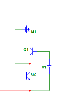

A variant of the Hawksford cascode idea...
Since we were talking about the Hawksford cascode, I thought I'd mention an alternative that does a similar thing. I'd been playing around with simulations of distortion with the Hawksford cascode, and the distortion numbers looked very good. But the behavior of the amp in clipping was not good - it had a tendency to "bounce" off the rail rather than maintain a constant voltage in clipping. I tried using a Baker clamp to improve the clipping behavior, but it doesn't work right when integrated with the bias circuitry for the base of the common base amp. It ends up not working like a standard Baker clamp should, yet increases the distortion considerably as well.
Then I remembered a circuit that Wyn Palmer of Analog Devices used in the AD846 op-amp. I've shown a variant below. I've represented the ampllifier's output stage as an unity gain VCVS. Assuming Q13 and Q9 are matched, the collector currents of Q13 and Q9 will be equal. The collector-base voltages of Q14 and Q10 are nearly equal but for a Vbe drop. So assuming Q14 and Q10 are matched, the instantaneous base currents of Q14 and Q10 are nearly equal. The "cloned" base current of Q10 gets injected into the emitter of Q10, which increases and linearizes the output impedance of Q10, while also making the composite circuit's current gain closer to unity.
The disadvantage of this circuit is of course the increased complexity and need to match devices. The advantage is that the base of Q10 is now at a fixed DC voltage. Assuming the bias voltage source for the base of Q10 can provide the instantaneous current necessary to pull it out of saturation quickly, clipping will be very clean. With the ideal voltage source V5, simulation shows the clipping behavior to be about as good as it gets. Simulated distortion numbers are nearly the same as the Hawksford cascode. So after endless experimenting with the simulator, I think I've finally found the topology I want to use for my amp! :)

That was a nice idea. I just tried it out, and am having problems with bursts of parasitic oscillation on the large-signal sine wave output. I've seen this before with some of the more complex circuits from the Hawksford paper that contain super pairs - for example, the ones that jcx posted earlier in this thread a few months ago. I haven't been able to kill these with base stopper resistors so far. Interestingly, I can make the oscillations go away by switching from modified trapezoidal integration to Gear integration in LTSpice. I had the same experience with some of jcx's earlier examples as well.
I looked this up in Vladimirescu, and it seems that Gear has the effect of suppressing oscillations. He shows an example with a lossless LC circuit for which trapezoid gives the correct steady-state sine wave transient response, but Gear incorrectly shows a decaying sinusoid. Since Gear is incorrect in this case, I suspect that in practice the circuit may not be stable. Even with Gear enabled, when I drive the amp into clipping, the parasitic oscillations start immediately afterward. This circuit does show promise, since when using Gear and not clipping the amplifier, no oscillation appears and the distortion levels are about the same as the Hawksford cascode and the "Palmer cascode" that I posted earlier. (I don't know if Palmer invented this, it's just that the AD846 was the first place I saw it). I'm going to play around with this circuit some more and see if I can kill the oscillations with some other technique.

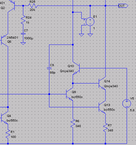

andy,
I'm not certain that this arrangement nulls out the base current of Q10 in theory other than in a dc situation. Dynamically, the Cbc of Q14 will create a non-linear error current which is not cancelled. You could, I suppose, minimize this by cascoding Q14 at the expense of the gain modulation by Vce being different between Q10 and Q14.
It is also worth pointing out that the current gain of the "VAS" in this arrangement is half of that of a "VAS" without the Q13/Q14 circuit. So half the current gain is expended to null a base current at dc.
The absolute dc current gain of the "VAS" is not so important and varies all over the place anyhow with temperature and so on.
Not true. If you look carefully at the schematic, the collector of Q14 is bootstrapped to the amplifier output, not to a constant voltage. It swings one-for-one with the collector of Q14. So the total instantaneous collector-base voltage is different from that of Q10 by only one Vbe drop, even in an AC situation. If it did not track in this way, the simulated distortion reduction wouldn't be comparable to that of the Hawksford cascode, which works on basically the same principle - feedback of the instantaneous base current back to the emitter.
The high beta of the BC550C (typical ~600) seems to give enough current gain to reduce the distortion despite the factor of two beta reduction from the parallel connection. I did try adding an emitter-follower to the circuit inside the Miller feedback loop to increase the current gain, but it did not have much effect on the distortion. In the circuit with an ideal output stage, all harmonics except the second are below -120 dB with an output voltage swing equivalent to an output power of 300 Watts into 8 Ohms. This is with a very low unity loop-gain frequency of about 110 kHz, chosen to give clean square wave response into a 2 uF load capacitor. This gives only about 14 dB of global feedback at 20 kHz (where I computed the distortion). So I'm happy at this point to get a good combination of clean transient response and low harmonic distortion.
Yes I understood this. This isn't my point. Consider the current path through the Ccb of Q10 and Q14 when the output voltage changes. Where do these currents flow? It is the difference in these two current paths that causes the asymmetry, not whether Vbes are matched or not.
Did Hawksford miss this?

Yes, certainly. My purpose with this simulation was to evaluate the contribution of the Vas to the distortion of the overall amp, neglecting the output stage distortion and nonlinear Vas loading. In other words, asking the question "how well can I do with a Vas having a perfect load?". Then proceeding to the next step, asking "how close to this ideal can I get with real-world drivers?". Putting a real output stage here would swamp out the contribution of the Vas distortion to the total amplifier distortion. I'm trying to take this one step at a time.
And with the shunt regulator for the output stage, the Vcb's of Q10 and Q14 will be off by several volts, rather than the single Vbe drop of the ideal case. But clean clipping is more important to me than getting the best possible distortion cancellation from Vcb matching.
As an aside, I'll be using MOSFET drivers as well as a MOSFET output stage like the Holton AV800, so the nonlinear load impedance on the Vas is dominated by the voltage-variable input capacitance of the MOSFET drivers. Drivers will be Fairchild FQP3N25 N-channel and FQP2P25 P-channel. Output devices will be paralleled Fairchild SFH9250L and Fairchild IRFP250B. Feedback for the Miller capacitor will not be from the Vas collector, but from the sources of the FET drivers. I tried connecting the Miller feedback to the amplifier outputs, but got degraded square wave response with capacitive loads (lots of ringing).
I have simulated the distortion with the drivers hooked up, driving the output stage and an ideal unity gain VCVS, with the overall feedback taken from the VCVS output rather than the FET output stage. The purpose of this was to evaluate the effect of nonlinear loading of the Vas, but neglect crossover distortion. I was rather surprised to find that the FETs yielded lower simulated distortion here at 20 kHz full power than loading with MJE340/MJE350 bipolar drivers.

I didn't say anything about Vbe matching. What I was referring to is collector-base voltage (Vcb) matching. This addresses your point. The collector-base capacitance is part of a non-ideal (voltage-variable) collector-base impedance. When the output voltage varies, there will be non-ideal base currents from this (to answer the "where do the currents flow" question). If the compensation transistor is matched to the transistor it's compensating and the instantaneous collector-base voltages of the two devices match, then those non-ideal base currents will be the same between the compensating transistor and the transistor being compensated. This compensation current is fed back to the emitter of the transistor, cancelling its distorted base current. The compensation current includes the effect of non-linear collector-base capacitance because the Ccb current ends up as a component of the total instantaneous base current.
If you like, shoot me an email and I will send you Hawksford's description of this. You'll see in his paper that his technique helps neutralize the effect of non-ideal collector-base impedance. He did not miss this. If you still don't believe it, try simulating the distortion at high frequencies with a normal and Hawksford cascode. I'm doing this at 20 kHz, 69.3 Volts peak. If your assertion that the technique only works at DC were true, then distortion improvement would only occur at low frequencies. In fact, the technique achieves excellent large-signal high-frequency distortion reduction. This wouldn't be possible if it didn't take into account the non-linear collector-base capacitance.
Cascoding alone is a big step forward because the parasitic currents flowing through Cbc are not magnified by Miller effect anymore.
