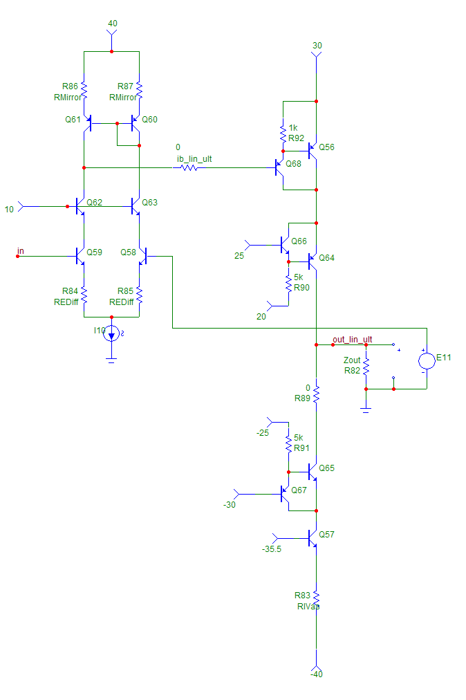

I've simulated the following circuit :
Click here for schematic
This has all the previously mentioned VAS'es, all loaded by a current source which looks like their twin.
They are fed from a current source of 70K impedance and are studied open-loop. This means I had first to close the loop, note the base current, then add a bias source on the base so the output of the VAS is about 0V open-loop.
Thus we can simulate VAS open-loop response, something which is utterly impossible to do outside of a simulator.
Curves coming in shortly.

And here are the VAS transimpedances (Re=100) :
These are d(VAS collector voltage)/d(VAS base current).
normal 4.7 MOhm
cascode 48 MOhm
hawksford 1420 MOhm
baxandall 76 MOhm
bax+hawk 28200 MOhm
Now I'll plot normalized output voltages with all VAS'es swinging +- 20V (by dividing the respective input currents by these factors) and study the open loop output distortion.

Distortion
I have posted too many graphs already, so I will just talk about the distortion measurements...
In OPEN LOOP, the surprise is that all VAS'es perform about the same. ie When they put out a +-16V output sine, they all add the same amout of distortion (well, not exactly the same, but it's close).
Here I give the distortion signal in Vpp :
Normal : 1.4V
Normal cascoded : 1.5V
Hawksford : 1V
Hawksford+Baxandall : 1.2
Baxandall : 0.5
... and I added a simple Darlington which performs as well as the Baxandall in this respect !
Note that all these stages distort a lot ! The normal one has distortion at -26 dB from the main signal (at 1k).
So, the large difference in distortion using the Baxandall does not come from it behaving a LOT better, it simply comes from it having more gain... and when you study it closed-loop, feedback masks everything. I wonder if it behaves better than a simple Darlington.

Now let's go back to the subject of this post, namely the Aussie amp. Why does it sound good, and why did the designer use such a complicated (and symmetrical) VAS ?
I do think that fully symmetrical amps are a bad idea. With two input stages, you never know where your operatng point is, and both have to be very well matched. So I do agree on the single input stage.
But why the symmetrical VAS ?
He could have done something like that and save on complexity :
Why did he not do it ? Why did he prefer the symmetrical VAS'es and why does it sound so good according to you ?
By the way, I realized this schematic is more or less the Otala amp (see schematic here). But the otala amp has reduces OL gain because of resistors going from VAS collector to ground, which was supposed to fight TIM, which does not exist, and just crippled the sound.
As for using two VAS stages, this may be to save on power supplies. If the amp is to output voltages close to the rail, the VAS must be able to go close to the rail. Hence the necessity for some voltage shifting, which is done here by the two VAS'es. But if we used two power supplies, we could use only 1 VAS stage (skipping the middle one in my schematic) which gives us more or less the Kaneda amp :
And, note also that using a symmetrical VAS like the Australian Amp does needs two stages as the currents must be shifted from the upper to the lower rail.

Simulations
From my simulations, the last diff stage could be like it is in the Aussie amp, or a simple diff stage feeding a current mirror, and the distortion would be about the same.
Besides, the distortion profiles look about exactly the same.
Thus either the diff+current mirror VAS sounds as good as the symmetric diff, or we have to investigate beyond THD (guess..)

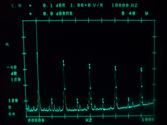

distortion
I'm finding the Aussie amp's VAS (and Otala, too) distort more than the good old Lin (and symmetrical Lin) when using a VAS collector impedance of 1Meg.
I am therefore perplexed and will go for some biking after I eat...
Hugh, do you have any idea to explain the supposedly exceptionnal performance of that amp ?

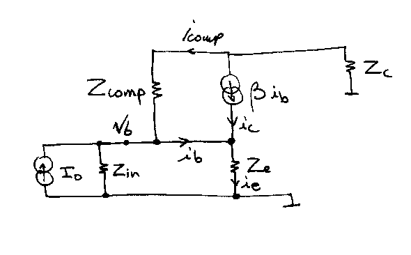

> I would be interested in your thoughts on the use of lag compensation on these VAS. While the higher Zout of some of the designs gives higher gain, and thus more feedback factor, lag compensation, all other things being equal, will have more crippling effects.
Well getting unreal collector impedances in the VAS is not really useful because the output stage which comes after that will have a low impedance anyway. Maybe not that low if we use a follower, but not that high either. I'd say an output stage with follower, driver and output transistor will look like ... maybe a few megohms at DC, and above that, it'll look like crap anyway thanks to parasitic caps.
But maximizing VAS transimpedance still has its uses as it lets us learn which configurations are vulterable to the coupling through Cbc which is nonlinear and magnified by Miller effect... and it is still good to have a VAS which distorts less itself than what the output stage does to it...
All these loop systems always turn around as you say : if more gain = more distortion, feedback is useless.

We are looking for the highest collector impedance, because this means less parasitic currents running through non-linear capacitances.
But what price is being paid to reduce this source of distortion? To tackle this the circuits use more amplifying devices, each of which is grossly non-linear in its primary signal path, let alone its parastic paths.
Typical designs use a single device and swamp the Cbc with a parallel linear cap, as you know. The cap also serves to slow the amp down and keep it stable. This works extremely well provided other problems in the system have been correctly resolved.
My question is how much distortion is being generated with the enhanced VAS circuits once they have the same lag C across them as a simple VAS?

Interesting results you've presented here peufeu. Nice work!
One very intriguing point you've raised is that the distortion of these stages without the compensation capacitor is very nearly the same. Let's assume we're going to pick the gain-bandwidth product of the amplifier, and that we have already done this by fixing the input stage gm and Miller compensation capacitor C at some value such that gm/C gives us the desired gain-bandwidth product. If we consider the Vas by itself as a feedback amplifier, this says that for a given C, the Vas configuration that gives the largest loop gain will have the lowest distortion (since they are all very similar without feedback). By loop gain, I don't mean the overall loop gain of the amplifier, but rather the loop gain of just the Vas by itself, in which the Miller capacitor forms the feedback path.
Much as I love playing around with SPICE, I think that it is very good at telling "what" is going on, but not as good at telling "why". In playing around with this a bit using a simplified model of the Vas and a plain old pencil and paper, I think I stumbled onto something that could help explain a bit of the "why" and can lead to some simple rules of thumb for reducing Vas distortion.
Let's assume a simple linear model of the Vas. Let's say the source impedance (that is, the output impedance of the diff amp) is Zs. Let's also assume the open-loop input impedance of the Vas is Zin. Further, let's assume the input voltage across Zin is Vin. We can then assume the short-circuit output current is given by gm*Vin. Then the open-loop output impedance Zout is placed across this current source, and a load ZL is placed in parallel with it. The compensation capacitor is placed from output to input of course.
We can compute the loop gain by placing a test current source IT in place of the dependent source gm. The loop gain is given by:
Loop_gain = gm * Vin / IT
using standard feedback amplifier/oscillator analysis techniques. This allows us to "unwrap" the feedback system, so to speak. To further simplify this, let:
Za = Zs || Zin ( || = "in parallel with")
Zb = Zout || ZL
When we do this analysis, which ends up being pretty simple, we get the following result:
Loop_gain = (sC * gm * Za * Zb) / (1 + sC * (Za + Zb))
Now suppose the frequency is chosen large enough such that the "1 +" in the denominator can be neglected. In this case, the loop gain above the dominant pole becomes proportional to the parallel combination of Za and Zb. I don't think it's much of a secret that the maximum ZL and maximum Zout give the highest Vas loop gain. But something that for me was less intuitive is that the maximum Zs and maximum Zin also give the highest loop gain. So this says that the optimum configuration is one with a current mirror at the diff amp outputs (giving a high Zs), and something like an emitter follower or source follower at the input (gving a high Zin). Combine this with a Hawksford cascode and high-impedance buffer preceding the output stage and you're doing about the best that can be done, I think.
Zb = Zout || ZL
... and I git an equation that is too complicated to post.
However, I don't agree with your need for high VAS input impedance...
As the VAS is fed from a current source (ie. a high impedance collector) it makes sense to maximize this current source impedance (by using a current mirror) so it behaves more perfectly.
However, the VAS output is proportional to current entering its base, thus we must minimize VAS input impedance to get more gain... this seems logical to me.
What's important is not the VAS gain after Cdom is applied, rather its gain before. As Cdom linearizes the thing, the VAS must have the highest possible gain before Cdom is applied...
Besides, Cdom feedback works well if the VAS base is at a fixed potential, because the error signal which is a current going through Cdom is Vout/ZCdom (ZCdom is the cap's impedance at a given frequency).
Augmenting the VAS base input impedance (say, by using emitter resistors, or even a base resistor) would augment the VAS gain once Cdom is applied, but only because it would divert some of the current going through Cdom back into the input stage, hence not using for what it was supposed to be, ie. feedback around the VAS...
So yes, you may get more gain with a higher input Z, but that's at the expense of feedback, ie. just as if you had used a lower Cdom !

Here's my Ultimate VAS.
I forgot to add Cdom.. oops..
Gain is terribly high, and parasitic currents through Cbc in cascodes are tamed by the Super Pair. It looks good IMO.
It would be interesting to try to simulate a MOS or JFET as the VAS transistor, anybody got any ideas which (and spice models too !)
