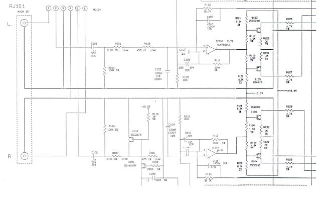

I've been working on my Carver TFM-55 power amp that had a 350mV dc offset on the left channel. (right was 3.5mV which is great for a 15 year old amp)
The main culprit was a small diode 1N4148 malfunctioning. This was passing positive charge up through the negative part of the bias circuit.
Once that was replaced I still had 60 mV which I wasn't happy with.
I started looking carefully, I changed a lot of resistors as some had drifted. Trying to use 1% metals in sensitive areas.
Managed to get it down to 32mV.
I suspected one of the transistors 2SC3467 (npn). I changed it to the other channel and bam the dc offset swapped channels.
Strange thing is that the bias sets nicely on both channels but somehow this transistor was causing a little of the dc offset.
I have ordered this transistor (I'm in Uruguay so I have to buy it from UK), so I expect I will get 3-4 mV on both channels when this is replaced.
Also replacing all resistors on RCA board for 1% metal film resistors and putting in some nice new coupling caps. (some idiot had put in 0.47uF 50V electrolytics in the signal path!!)
IMO it is worth it. The overhaul has really brought my old amp back to life. It sounds so sweet now.

To get the offset really low you need to match the transistors in the input LTP. Any imbalance causes the actual distortion level to rise slightly although I doubt it's audible. Even just touching one with a finger will warm it enough to cause a noticeable imbalance.

When you refer to the input LTP are you referring to the RCA input board with the differential transistors?
I've also got some new dif. transistors ordered for the input board.
In my case they are 2SC2240's and 2SA970.
2 of each.
I will see if I can get them to match closely.
better still, try to find a dual transistor for the LTP. they are essentially two transistors, with matched hfe, on the same chip. this will help dc offset due to the matching hfe and thermal tracking. some say these are hard to find sometimes so availability may be an issue but if you can find a good quality one, that is your best bet.
and of course make sure the resistors (if used) in the LTP are matched as close as possible.
and yes, the LTP (long tail pair) is the input differential amplifier Mooly was referring to.

and a part of the main board with the left channel input and feedback loop. Now the collector of Q203 was reading positive when I took out the feedback loop of pin 4.
This should have been negative as it's a push/pull design.
But when the feedback loop was attached again it worked including the bias but I was still getting a little dc offset.
I swapped Q203 for Q204 on the right channel (which was working great), and the dc offset went straight to the right channel. Something was up with the collector on this transistor 2SC3467.
So I need a new one here.

It's really hard to make out from the images, to faint, your just going to have to see what happens.
It's not what I was expecting to be honest, didn't think an opamp would be used as the input stage.
The opamp should see the offset down to practically zero, but without seeing a full circuit Non of the transistors on those images are a LTP, the opamp appears take the place of that.
Would have to see the full circuit -- sorry
