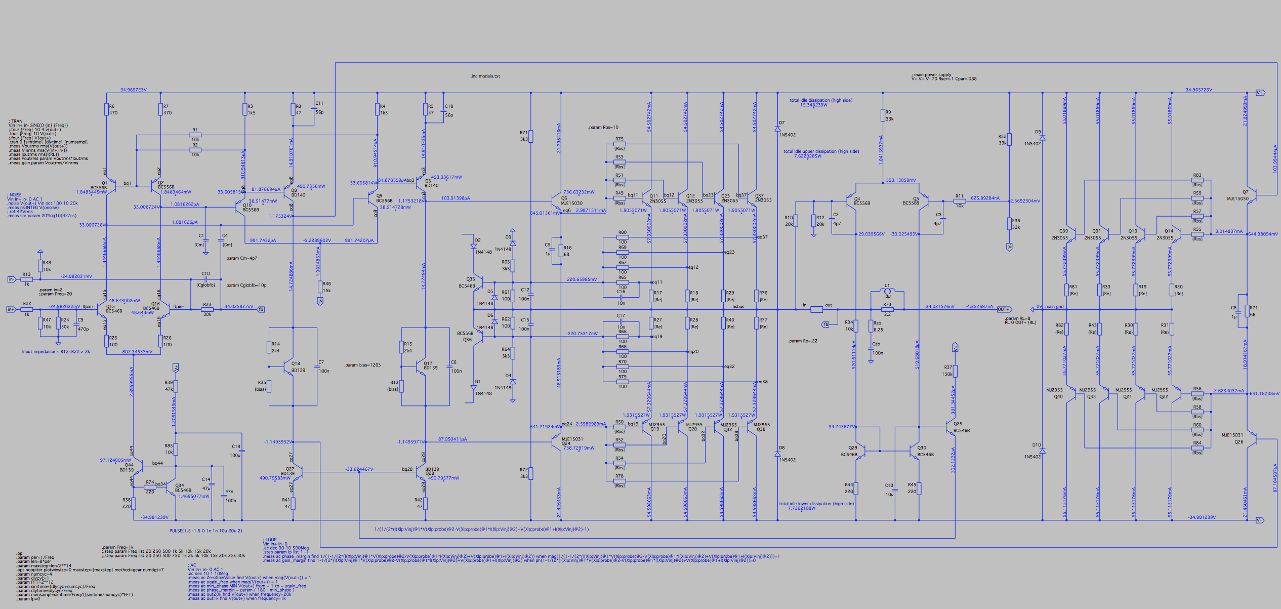

2N3055/MJ2955 for ouput stages
MJ15030/31 for drivers
BD139/140 for predrivers
BC550C/560C for input stages and BC546B/556B for the rest of it (protections as well)
This posted schematic shows the BD139/140 as drivers, but they're really pushed hard and MJ15030/31 are better for that purpose.
In that simulation, the idling bias currents in the outputs are rather "rich", although the dissipation seems a little high for idling, it's within reason, a bit like a class A.
We can bias it with a little less, to reduce the warmth from the heatsinks when idling.
But with this high bias, we get very low distortions, at basically any power level.
Very nice.
Very nice.

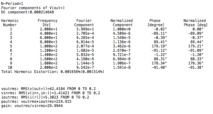

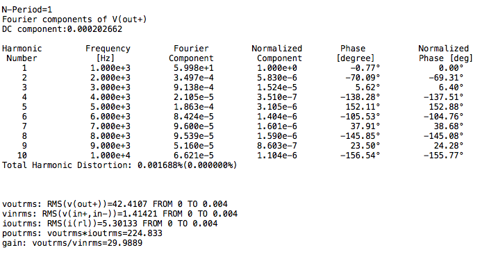

Alright, here is a cleaned up view of my 4 pairs simulation, with info from running the sim.
Protection is disabled. It doesn't work as it should anyway, and that is what basically remains to be fixed.
Load is 8ohms resistive, but I've tried it with complex loads before and it behaves just fine no matter what.
The input is symmetric, and the 2V input brings it right at the onset of clipping.
The power supply is a simple 70V rail to rail. I put a .1ohms impedance and 88mF of filtering, which might be pretty close to real world.
Obviously under load the rails will sag somewhat, and that makes it clip a bit earlier than with ideal rails at 70V. (+-35V, no center tap)
And we get well over 200Wrms output, with a distortion still below 20ppm (@1khz) on that 8ohms resistive load.
I think it's really not bad at all. I'd love to have this work in a real build.

This is an unusual design, rather unique and I don't know of any actual builds ever made this way.
It's a "bridgeable grounded bridge". With power capabilities rarely seen using only 2n3055 type outputs and rails not exceeding 70V rail-to-rail.
This still definitely falls within the main topic of 2n3055 based amps for this existing thread, but maybe it deserves its own thread.
I pulled up the SOA plots on this last sim (4pairs bridge). Loaded with resistive 8ohms, and looking at the bd140 high side vas transistor, the mje15030 that follows and the 1st 2n3055 after that (the others show the same usage).
The amp loaded at 8ohms resistive, actually loads each side at 4ohms, and the 4 pairs are spreading out that load current nicely to a rather low level per output.
This is at max power, right at the onset of clipping. Protections are disabled. Frequency was 20hz. Input level 2V.
Well within the SOA, with reserve area for more complex loads, and hopefully enough to handle the cases when the limiter is acting.
