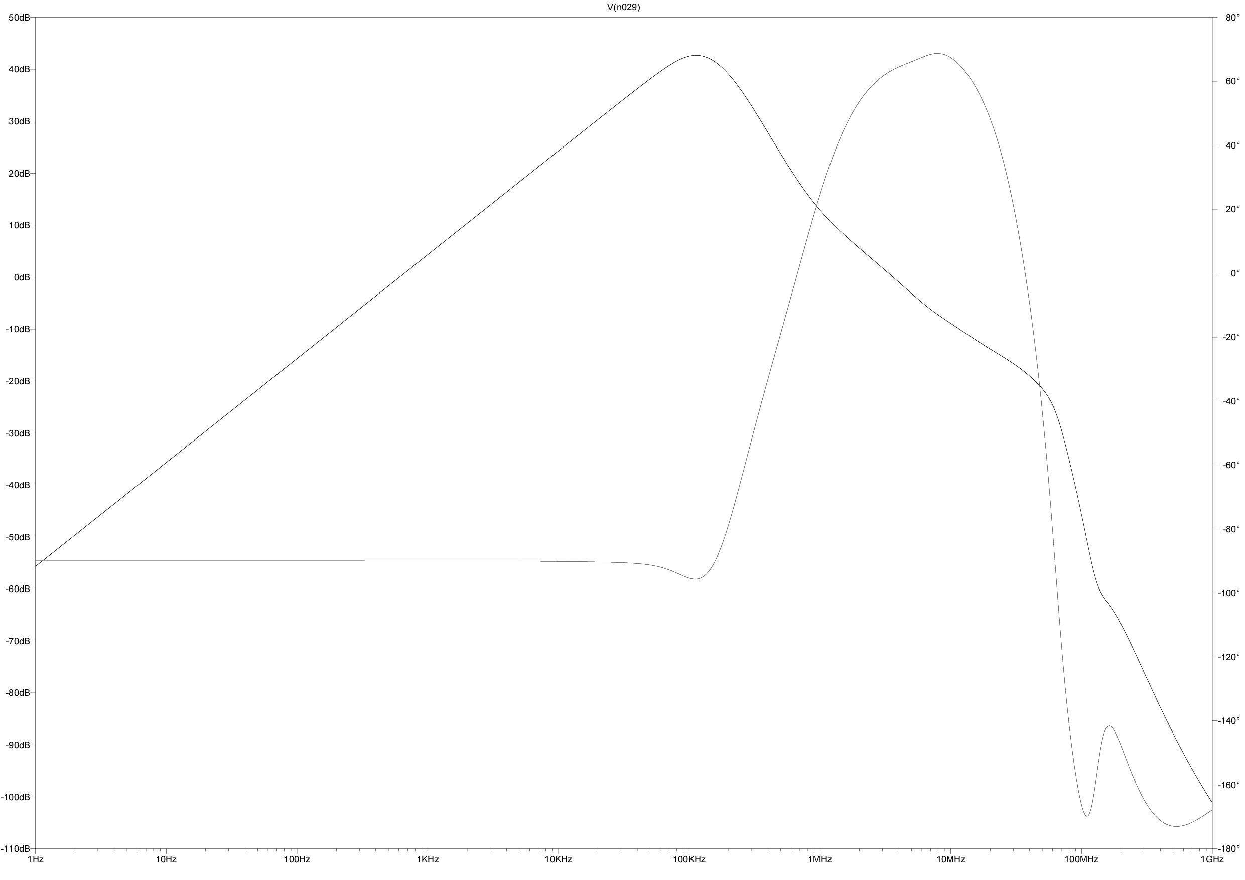

Hello Manso,
The peaking response was caused by adding the pure capacitive load to test stability. The peaking appears to come from the HEC when driving capacitive loads with no L//R filter. It can be corrected easily but slows the HEC down.
I have not used lag comp on the vas as in Self's book he says that it is a brutal way to treat a VAS. That's why I went for a resistive load back to the IPS output. This seems to reduce the harmonics at the VAS.
The distortion figures can be made much better with the removal of the clipping diodes. I am currently looking for an alternative way to stop VAS saturation. An alternative method is (which worked very well but has a quite a few extra parts) detailed in Cordell's book and can be seem in my first amp attempt that turned into a monster.
No problem posting the .asc file. Will do it after work tonight. Would be good having a another brain on this.
Paul

This is a CFB topology, its quite different to VFB. Self´s view is not of any consequence here youll find. Self actually shows this topology and claims its sub optimal, little does he know that many of the best amps actually use this topology. The way he wrote about it I have doubts in my mind if he is aware of the difference between CFB and VFB, see what he calls it. I doubt youll find a CFB opamp that is not compensated in this way. As the beta enhanced vas has much higher gain it could be of some value here but Id have to look at simulations. Without the beta enhancement I doubt it would be.
I havent got much experience with hawksford error correction, have you tried ONDF error correction, I get better results.
This topology clips simmetrical and cleanly, I wouldnt bother too much with clipping diodes.
A good example of this topology is the british Cyrus amp range, from model 3 upwards about all models use this topology.

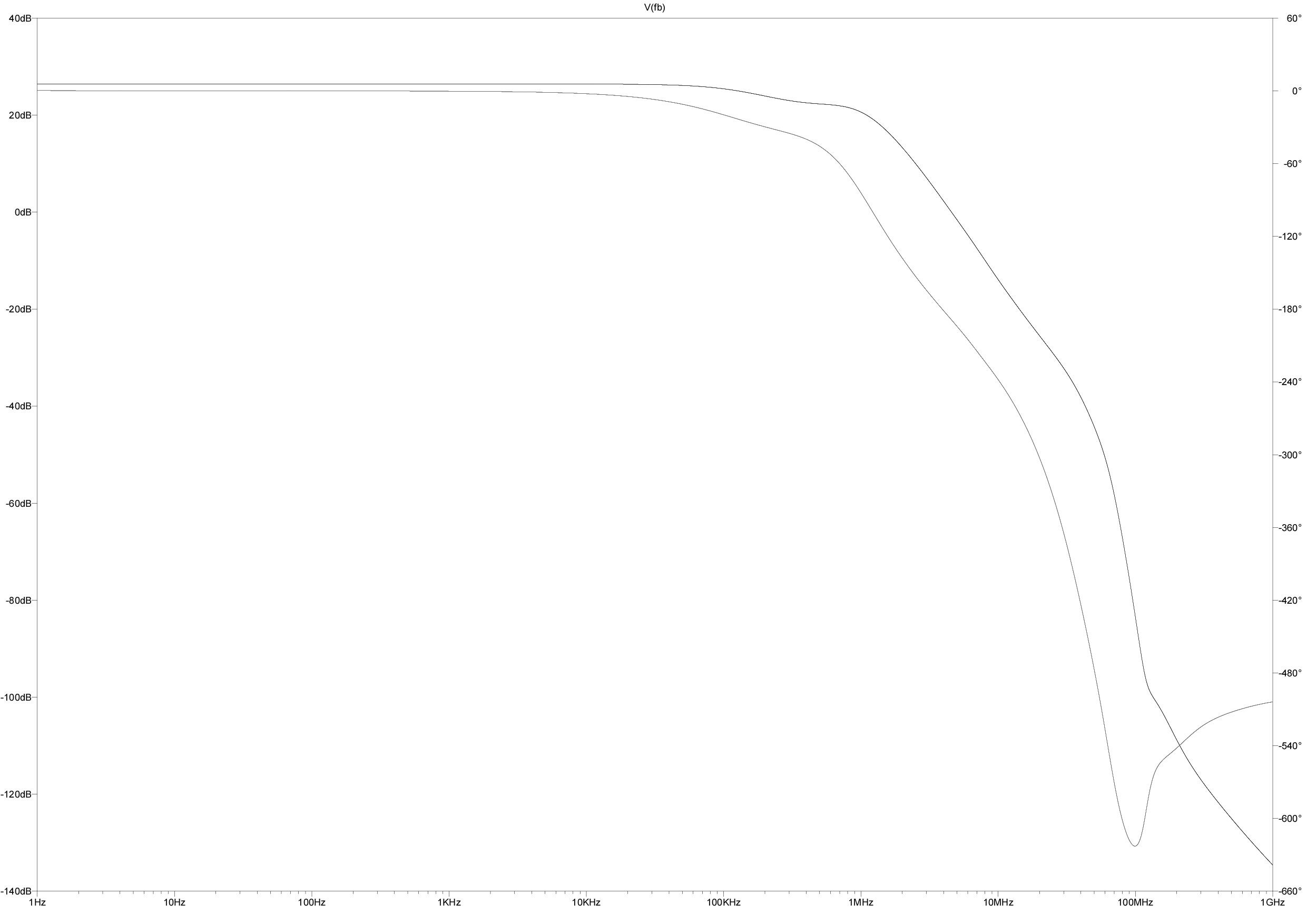

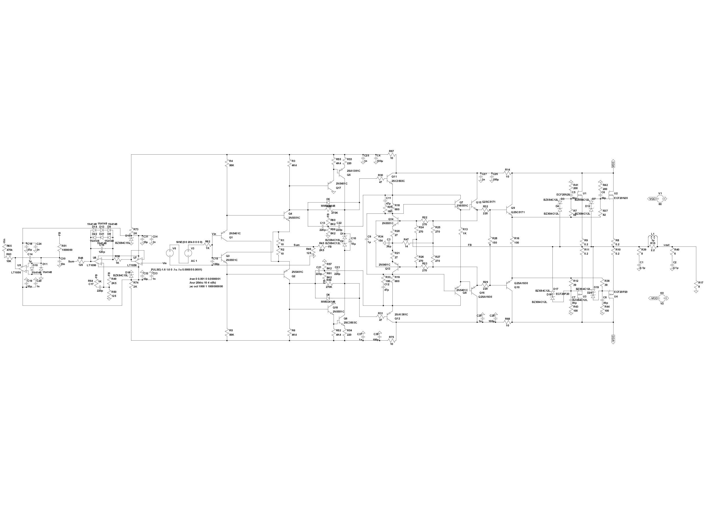

This version was a bit of fun.
Check the specs ha ha. Can't take them seriously myself. All I have done is implemented hifisonix AEFC and modified the DC servo slightly.
1KHz +/- 2V = 0.000001%
1KHz +/- 32V = 0.000004%
20Khz +/-2V = 0.000008%
20Khz +/-32V = 0.000213%
THE AEFC has improved the THD by almost an order of magnitude

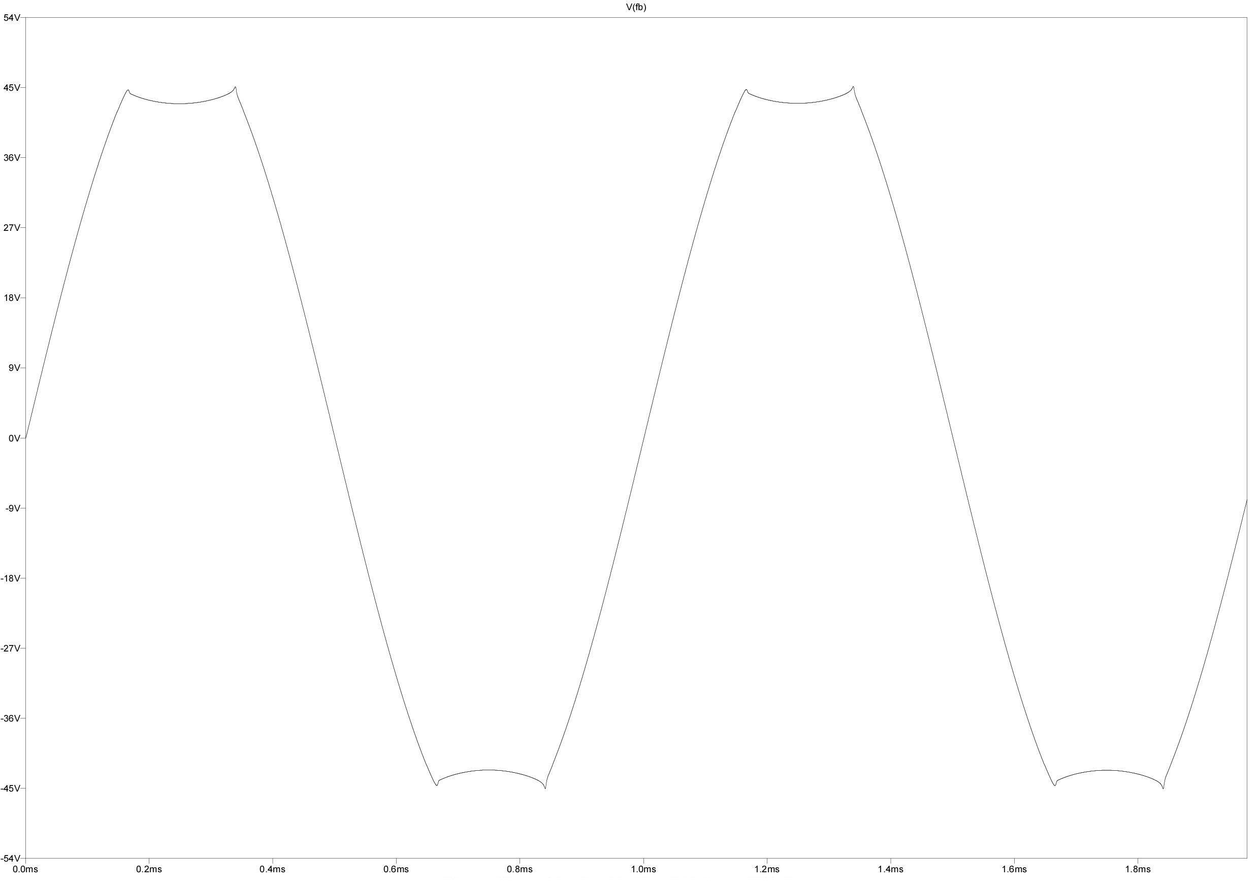

The only penalty is clipping behaviour.
What do people think? I've broken the rules of CFB, I think.
Edit: obviously this is in the dream world of SPICE.

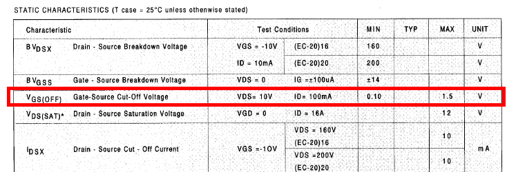

I don't see any way to adjust the output stage's bias current. Exicon's datasheet for those output transistors says that their threshold voltage can vary as much as 1.4 volts (see attached snippet), but I can't find a "bias spreader" circuit that allows you adjust the gate-to-source voltage via a trimmer potentiometer. Normally such a circuit would permit the adjustment of the output stage bias current flowing thru, and measured across, R8 + R10.
tl/dr: what if they ship you MOSFETs whose threshold voltage differs from the LTSPICE modeled value? Maybe you might want to simulate at both extremes of the datasheet permitted range, n'cest pas? Four "process corner" sims: Plo_Nlo, Plo_Nhi, Phi_Nlo, Phi_Nhi ??

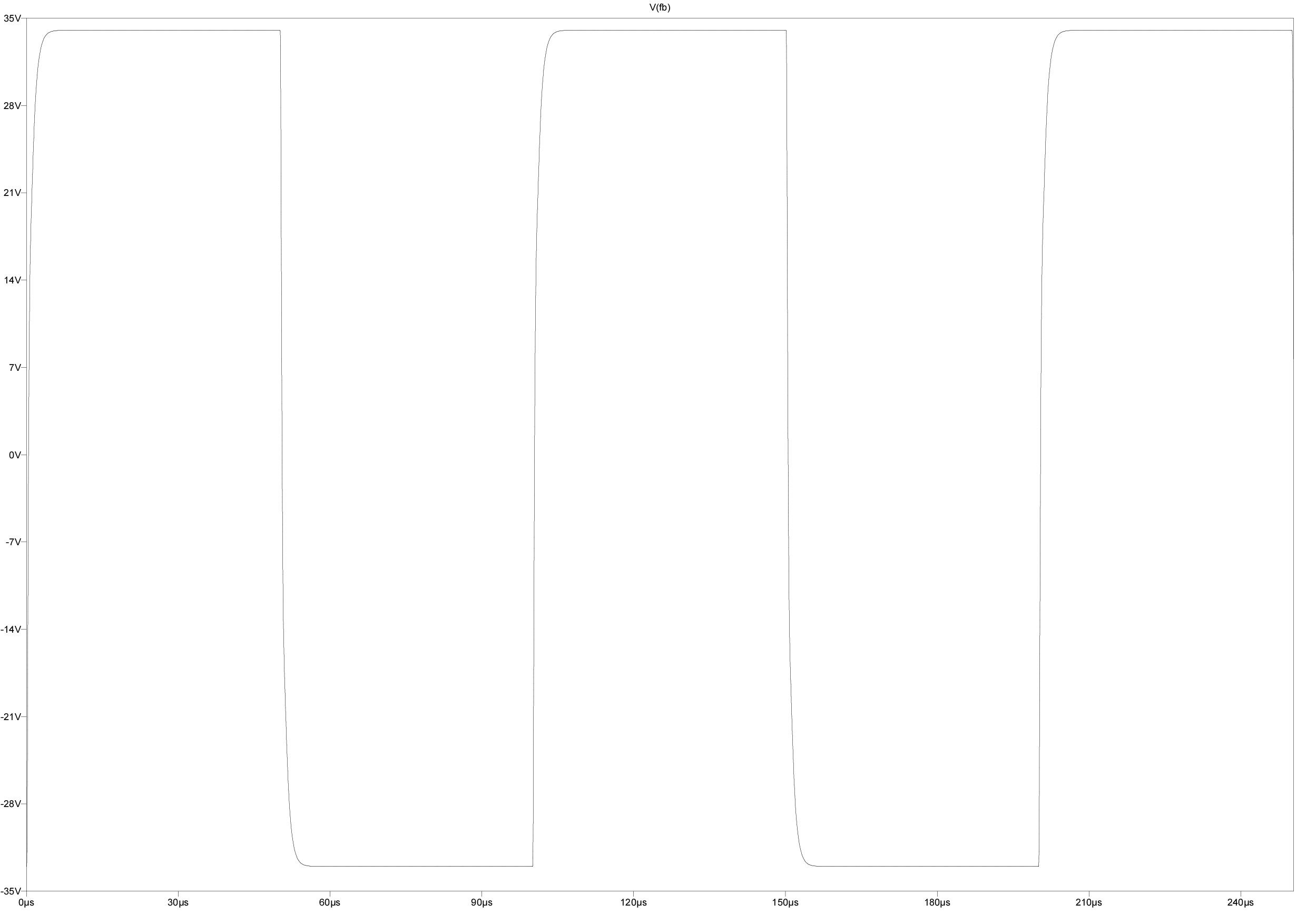

Edit: for square wave testing you'll want to change C15 to 0.1 pF.

Mark,
I can answer the first question. The bias current is controlled by R34.
I'll have to inspect the models and figure out how to change the threshold voltage. I do have the MOSFETs in my possession so i could measure the threshold voltages. Just scared of ESD damage.
Wouldn't the HEC "correct" the variance in the threshold voltage?
I seem to remember from the semelab application note, that matched mosfets have 0.1R source resistors and unmatched have 0.2R.
Oh yes, forgot about changing C15
