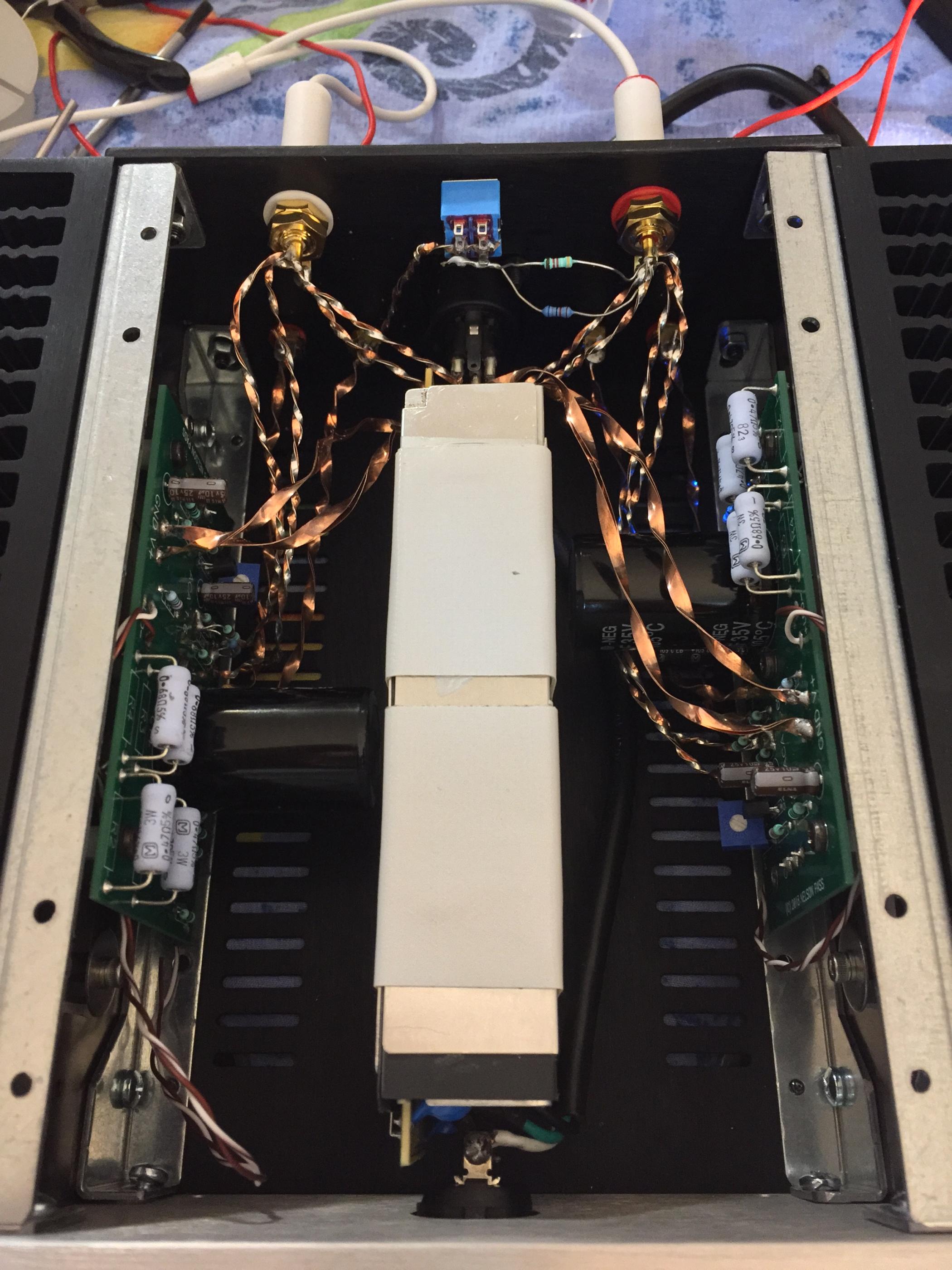

It does feel like the bass is sometimes lacking, compared to my other amplifier (Sansui 1000A). Not sure if has anything to do with my speakers being 4 ohms or some other factor.
You could try replacing the output sound-coupling capacitor with 10,000uF/35V CDE cap. See the photo.
The thin, red, double-run cable, from the 24V connector to the switch, should be replaced with a much thicker pair of wires.
You could install the power supply inside the amp... and use very short wiring, for that ultimate ACA experience.

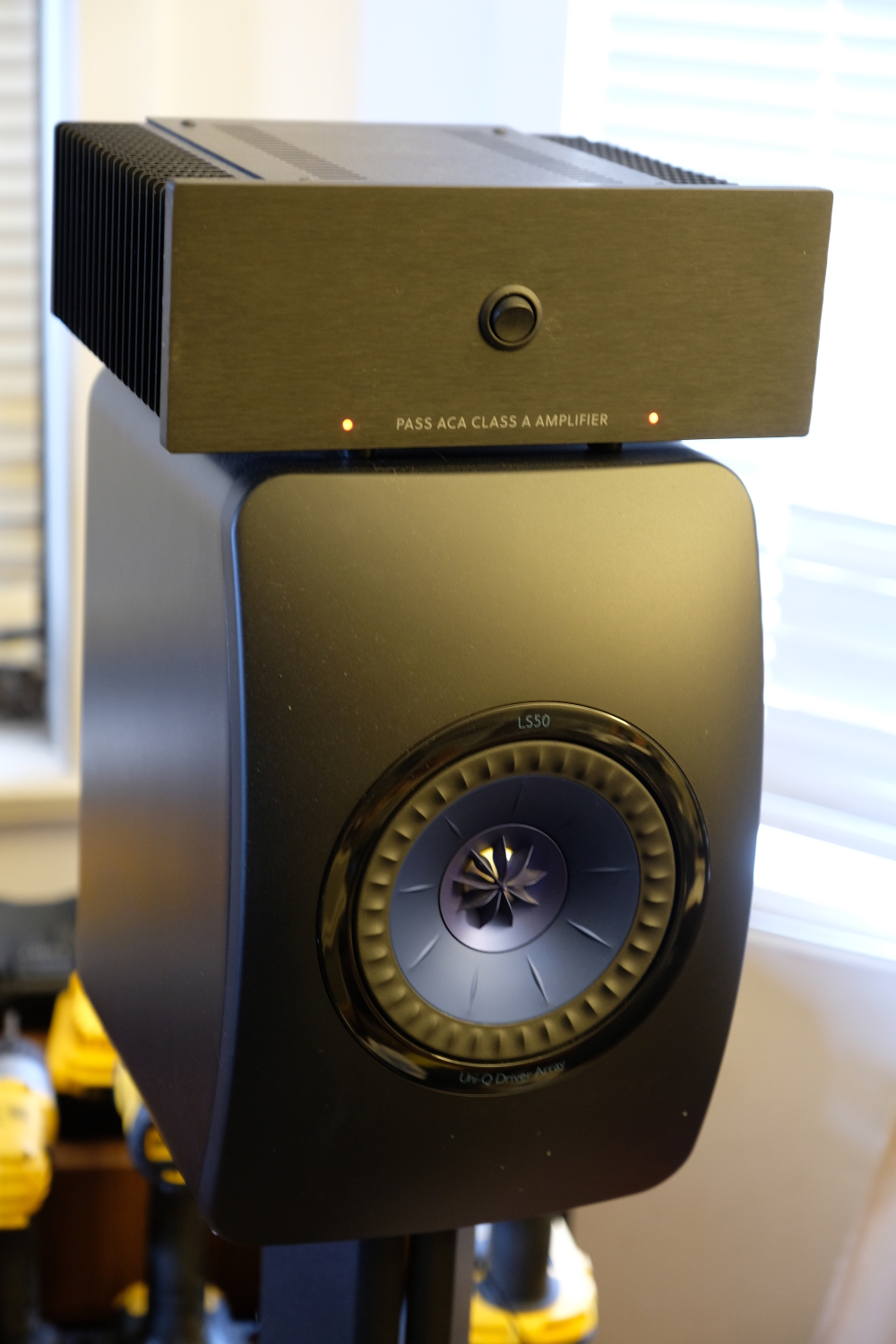

I used a 49K resistor for the LED supply instead of the 10K. It tones them down nicely,
though I built the amp in another case, so I don't see the LED's anyway, but 49K
works OK. I am able to use a passive preamp with the amp, but my DAC puts out around 1.5 volts, and my open baffle speakers are fairly efficient.
I prefer not to remove any parts or re-solder anything. I am counting my blessings that it works,
I am wondering if I could mount some type of material in the LED holes to diffuse? Just a thought.
You could try roughing up the front surface of the LED with some fine sandpaper to diffuse. That's what I always do.
But I also suggest adding a resistor to dim the LED. It's relatively easy work.

I posted earlier that I used Polymorph to make a diffuser, and it worked pretty well optically, though it was a little difficult to stuff into the hole and trim without scratching the panel.
