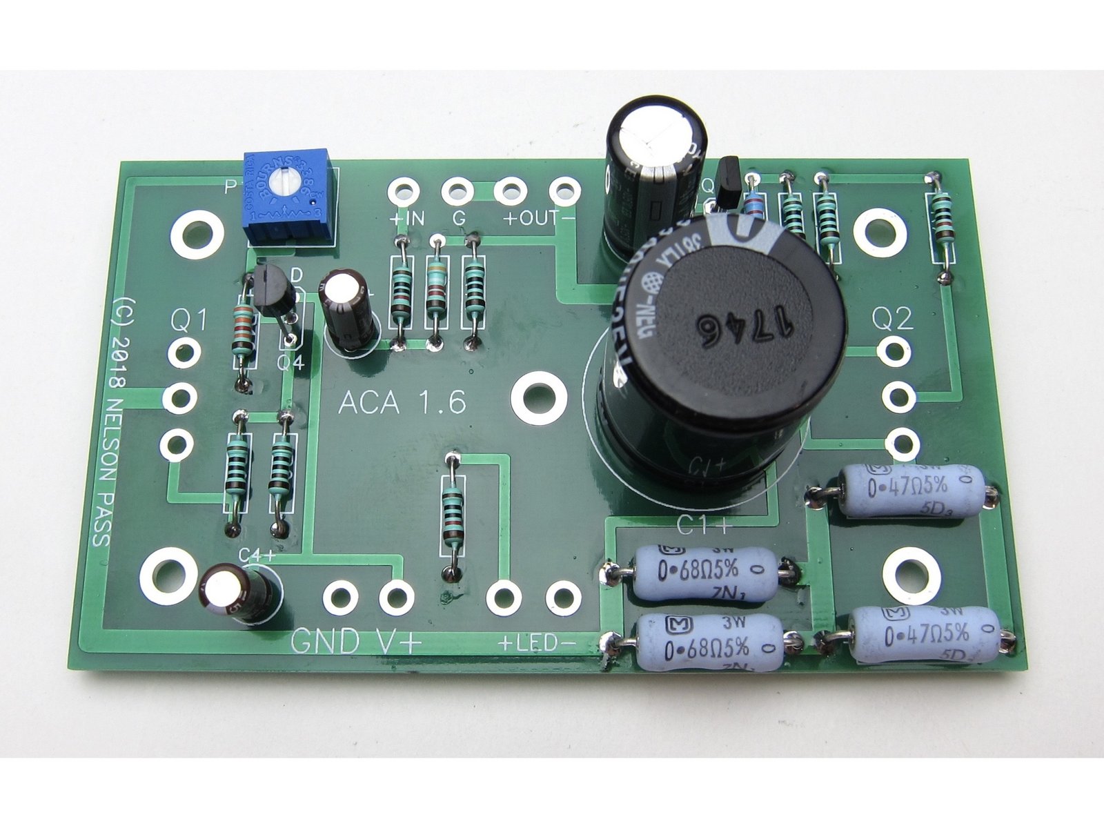

Not being critical however all of the solder points look cold other than maybe Q2.
I would fire up your iron and reflow everything. Heat the pads well before adding solder to the pad and component leads.
It is desirable to have the solder flow through the board from one side to the other leaving a blob free shiny filled hole on both sides.
Nope, turns out the only cold one was the output cap! The rest of them conduct freely.
Once I touched up the output cap, that channel was up and running. The amp works perfectly now, and boy does it sound good. I can tell why people like class A. I'll post some pics tomorrow, its housed inside my custom enclosure.
Hi Jenghis,
Yes, good news, glad your ACA is working now.
BUT bbm3 is correct, the soldering is poor on your board. It may work today, but after a few on / off (hot / cold) cycles will likely fail again...
As he says a good solder joint should 'fill' the pad and have a cone of shiny solder on 'both' sides. See the build guide picture as an example. You need more heat and more solder to make good joints in future.
Any problems in the future, re-flow all the joints as suggested. Alan

Yeah on that board I used a non-leaded solder that flowed very poorly. The other board I used leaded solder, so it was easy to avoid cold solder joints.
If that channel does stop working again in the future, I'll know what to do!

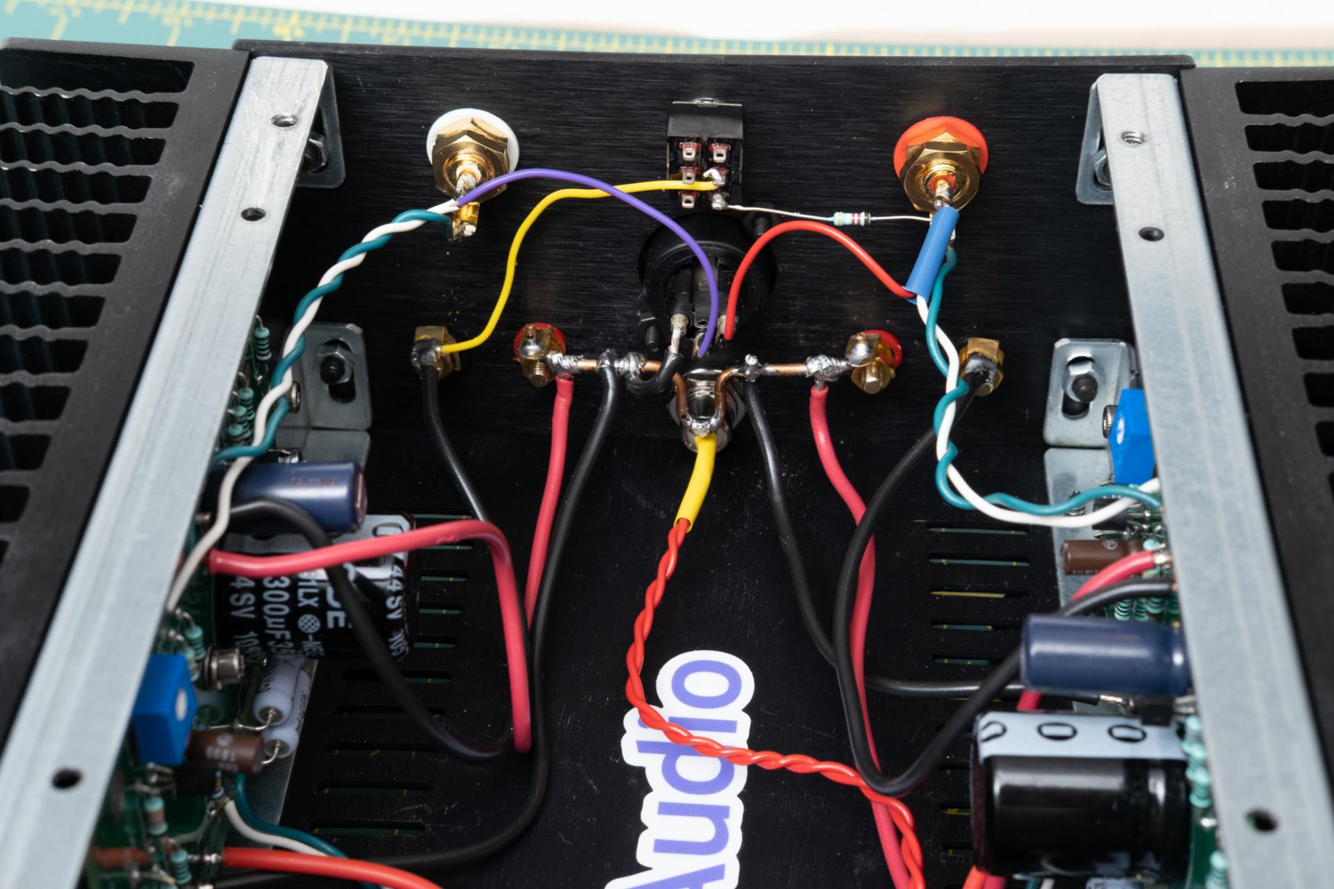

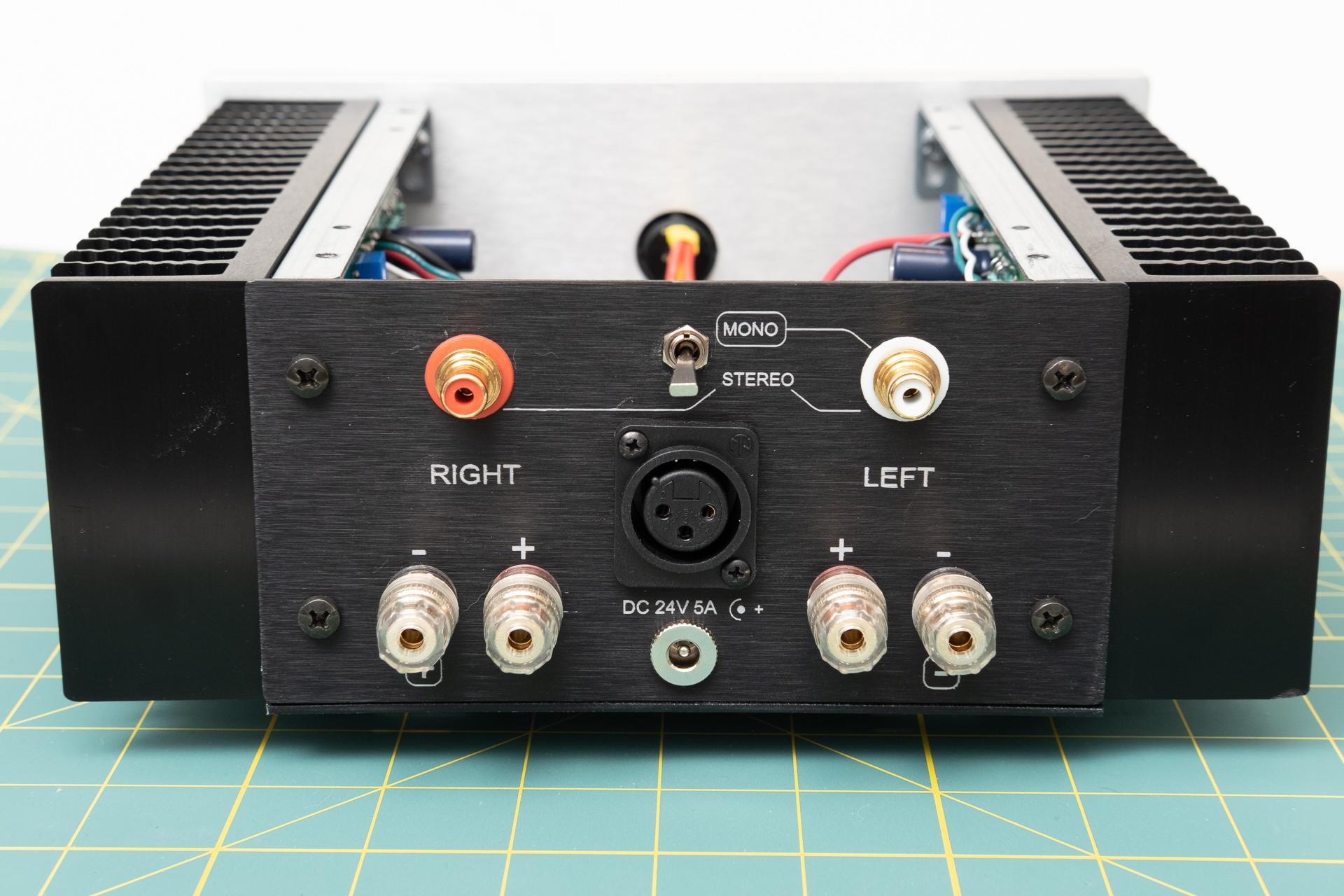

Finally got my ACA finished about two months ago, I've been enjoying it since. My impressions are that it sounds wonderful. Vocals, acoustic guitar, mandolin and other stringed instruments, and drums all sound amazing. It does feel like the bass is sometimes lacking, compared to my other amplifier (Sansui 1000A). Not sure if has anything to do with my speakers being 4 ohms or some other factor. I considered building another one and running them in parallel mono to see if that made a difference. I drilled a few holes and put real feet on the bottom of mine, I also used an orange LED with a 24k resistor to get the ambient glow to match better with the tube equipment. Thanks to JeffreyD for posting the laser engraving files I was able to have a local engraver label the rear panel, also thanks to everyone that has participated in this thread I have learned a lot reading through it, and looking at other people builds is always a motivator. I have made a time lapse of my build process I will link below if anyone is interested.

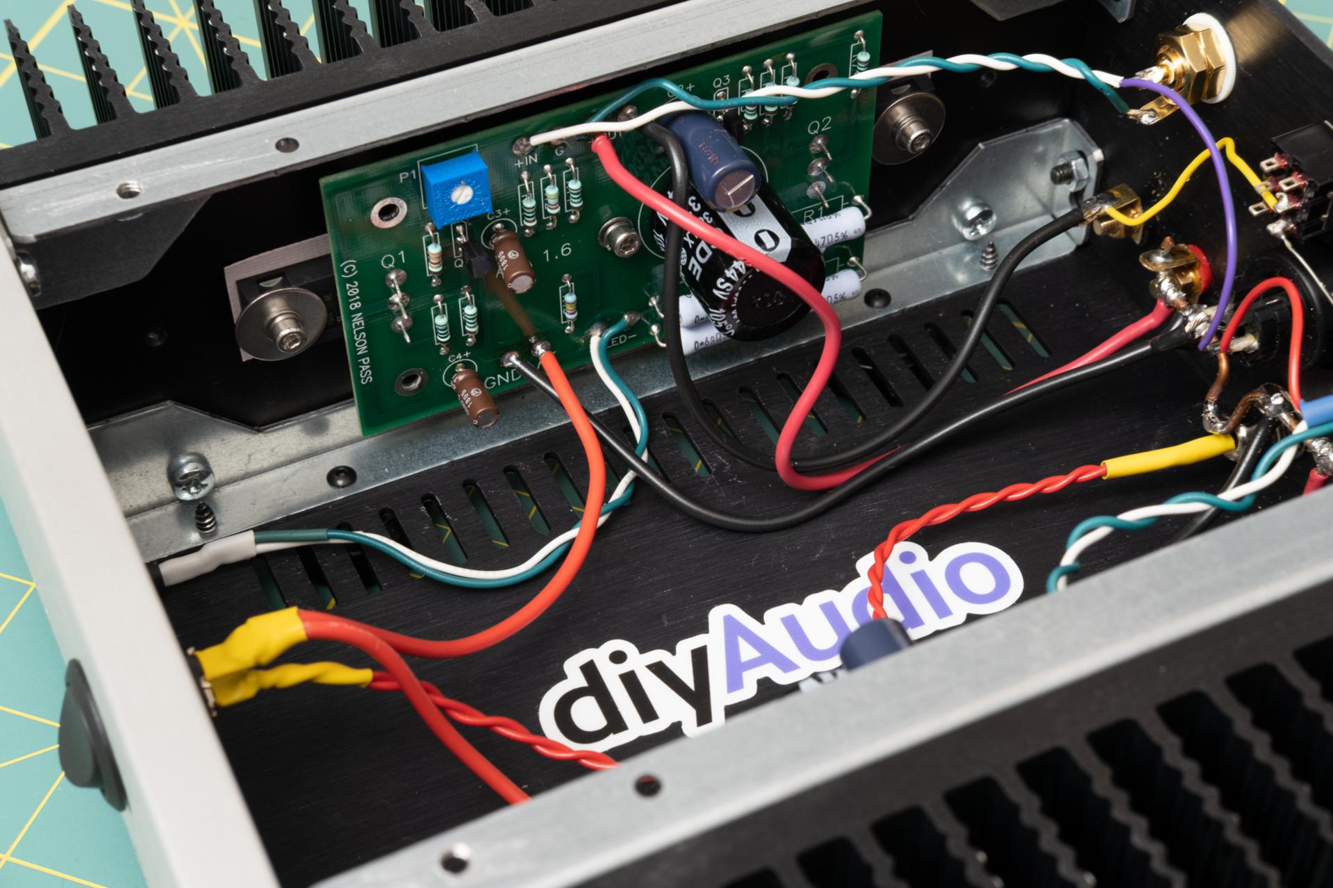

The pinnacle of issues might be what occurred at the very end. I was re-tightening all chassis screws when I snapped the head off a screw holding bracket onto heat sink. Anybody got an extra heatsink, ha! I have the capacity to over tighten like no other. I could leave it. But I would bet that I take that side apart and drill out the remaining shaft.

I trashed the heatsink drilling the screw out. It had to be problematic all the way through. Drilled the core once perfectly, but couldn’t get husk out, refused to fold in on itself. I begrudgingly went one bit up and plowed completely through the heatsink with it. I ordered a replacement already. Oh well.

Perhaps unacceptable or undesired, but could you just drill the hole through, and use a longer bolt to attach the rail to the heatsink. I did not use the
amp camp case complete because I built the kit inside another case, but looking at my heatsink, it looks like the original holes are between the outside fins.

Ok so the amplifier works. Thanks all.
Though I wasn't able to perform anything other than a real quick late night test. A few thoughts... the LEDs are too bright, always are. The startup and turn-off noises aren't an issue for me. I am sure the amplifier could use a preamp with gain, as testing with my iPhone as source absolutely required the volume higher than midpoint (93dB dinosaur speakers for testing). My original plan was to add a Korg B1 to the ACA chassis, but that would be a ridiculous tight squeeze for a novice such as myself to pull off. Does the dummy plug for the back switch fit anybody else's chassis?
I used a 49K resistor for the LED supply instead of the 10K. It tones them down nicely,
though I built the amp in another case, so I don't see the LED's anyway, but 49K
works OK. I am able to use a passive preamp with the amp, but my DAC puts out around 1.5 volts, and my open baffle speakers are fairly efficient.

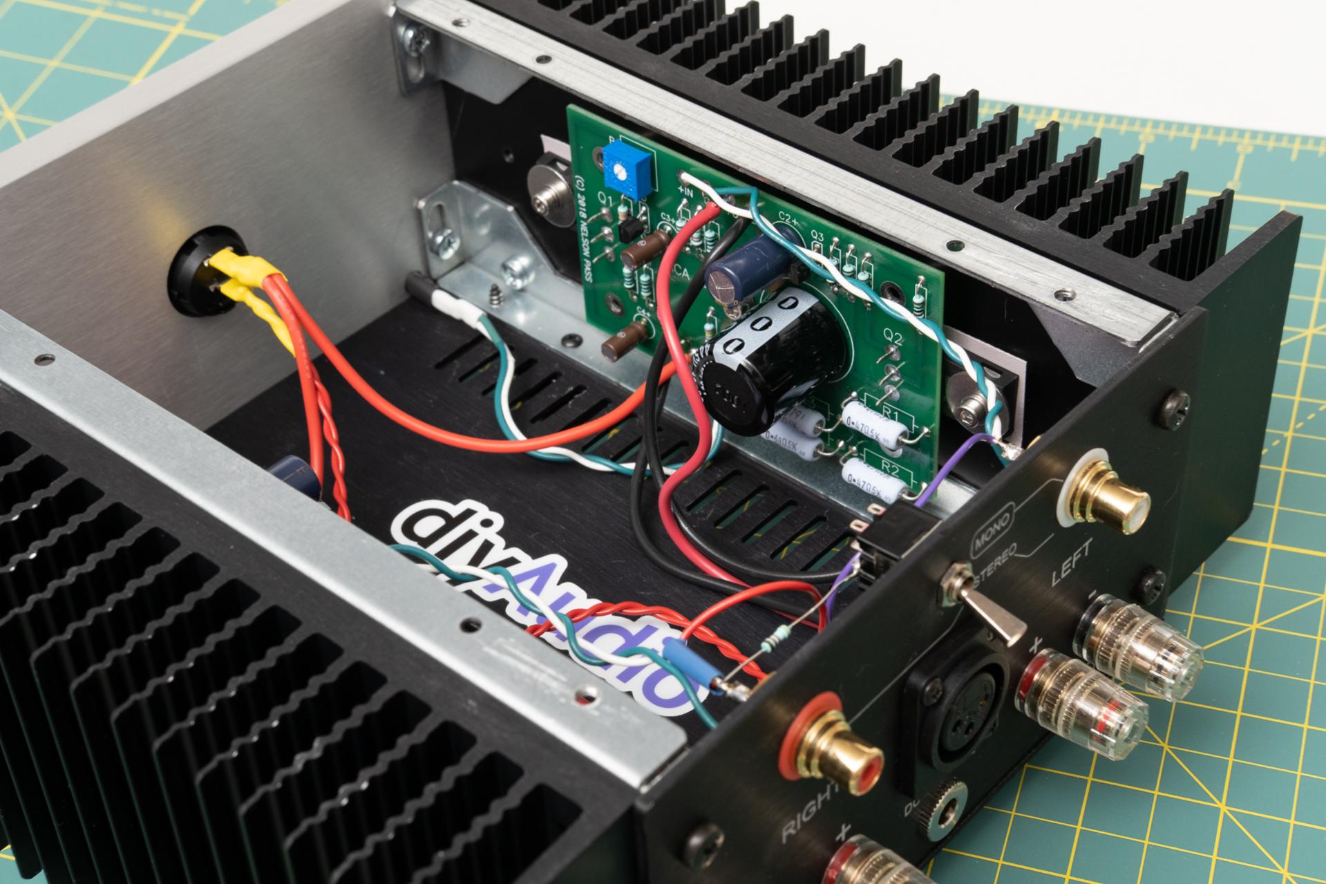

Hey All, I hope you don't mind me asking a quick questions about adding CPU fans to cool my Amp Camp Amp...
I purchased the Amp Camp Amp parts kit and power supply, but not the chassis because I wanted to build my own.
I have assembled the kit and it sounds AMAZING! however the heatsinks I am using are getting pretty hot. I'm planning on buying some 24V CPU fans like these to help cool the heatsinks: https://www.amazon.co.uk/WINSINN-Br...u+fans&qid=1564069624&s=computers&sr=1-6&th=1.
Will I be able to simply connect the positive/ ground wires to the same power supply as the amplifier? Will the power supply be able to handle the additional load of 2 CPU fans?
Administrator
Joined 2007
The Meanwell 5A 24 volt supply will easily cope with those fans but they aren't really needed for the ACA. Although it might seem to run HOT, its actually well within safe limits for reliability. The fans will just add acoustic noise and detract (imo).
Yes, 24v fans go across the 24 volt rail but there is then the theoretical issue of whether they will add any electrical noise of their own to the rails... you could feed each of them via a 10 ohm/1watt resistor decoupled with a high quality low E.S.R. 47uF cap. Be sure to get the ground return of the fans correct i.e. so that it will not interfere with the signal grounding.
