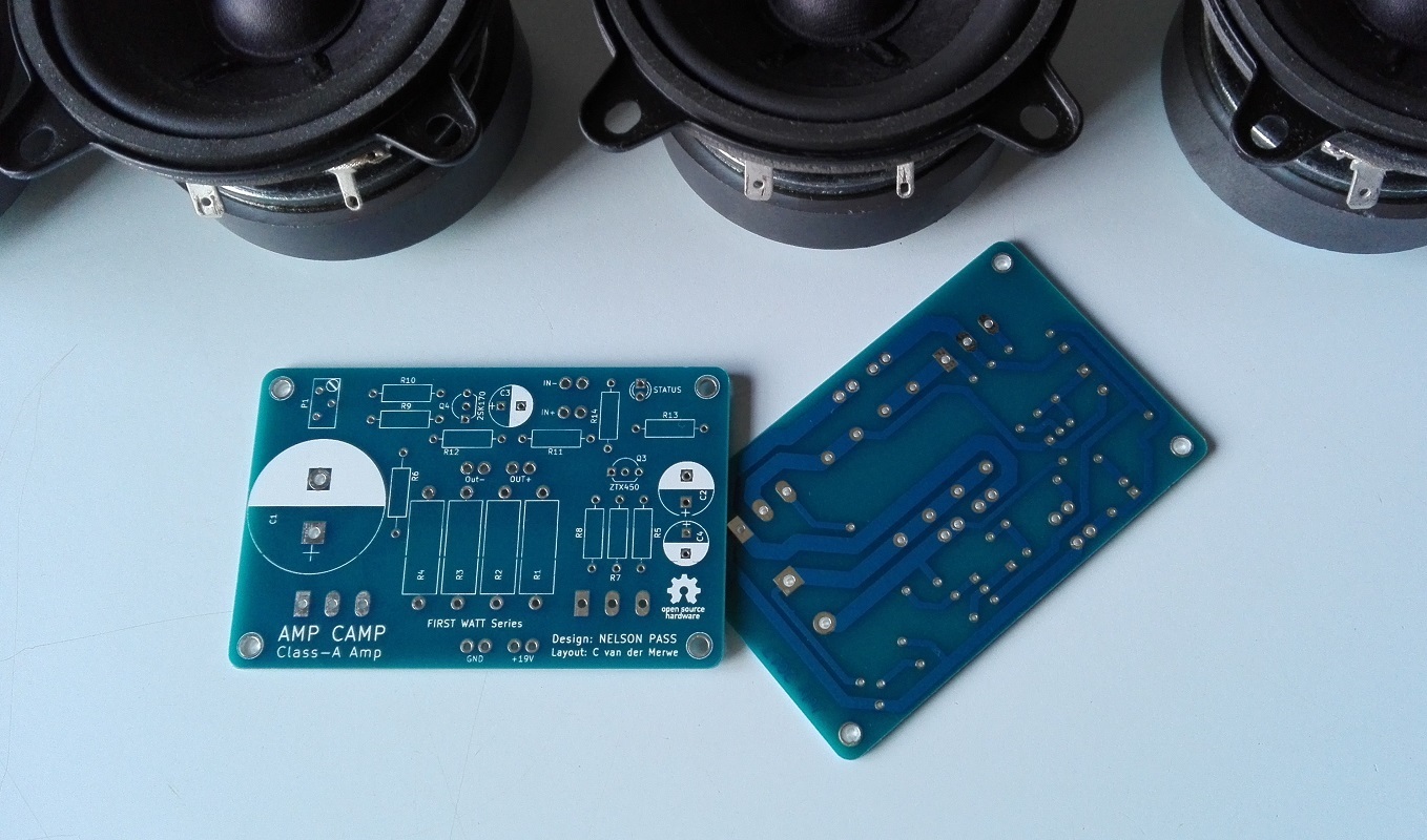

Around April last year, when I decided to build the ACA, no boards were available from the store. With minimal experience in electronics, I downloaded KiCad and working from the schematic and BOM, a single sided layout was produced - in case I had to etch it myself. But when I saw how inexpensive it was, I mailed the Gerbers to a board house. US$19.38 including shipping from Hong Kong, bought me 10 ACA boards (and bragging rights). The ACA amps worked first time, so no problems with my boards.
Ain't DIY fun? :D
