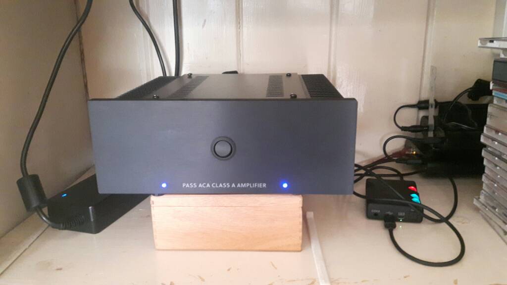

Not having a separate dac I was wondering how to feed the ACA. Bought a second hand Yamaha WXC-50. It works. Connection wise it is great and easy. It streams Tidal over wifi. However it doesn't sound nice. Then I had a bright idea and connected my laptop directly to the ACA. It works and sounds even a little better! Now there is room for improvement!
First I will try this with a dac in between. Got a Chord Mojo coming [emoji41]
Mojo is here!
Even with my 4 Ohm 86bB Penaudio Cenya speakers volume is not a problem anymore at all in my 3 by 4 meters room.
Laptop > Mojo > ACA sounds really nice.
Sonore ultraRendu (streamer) > Mojo > ACA sounds really great.

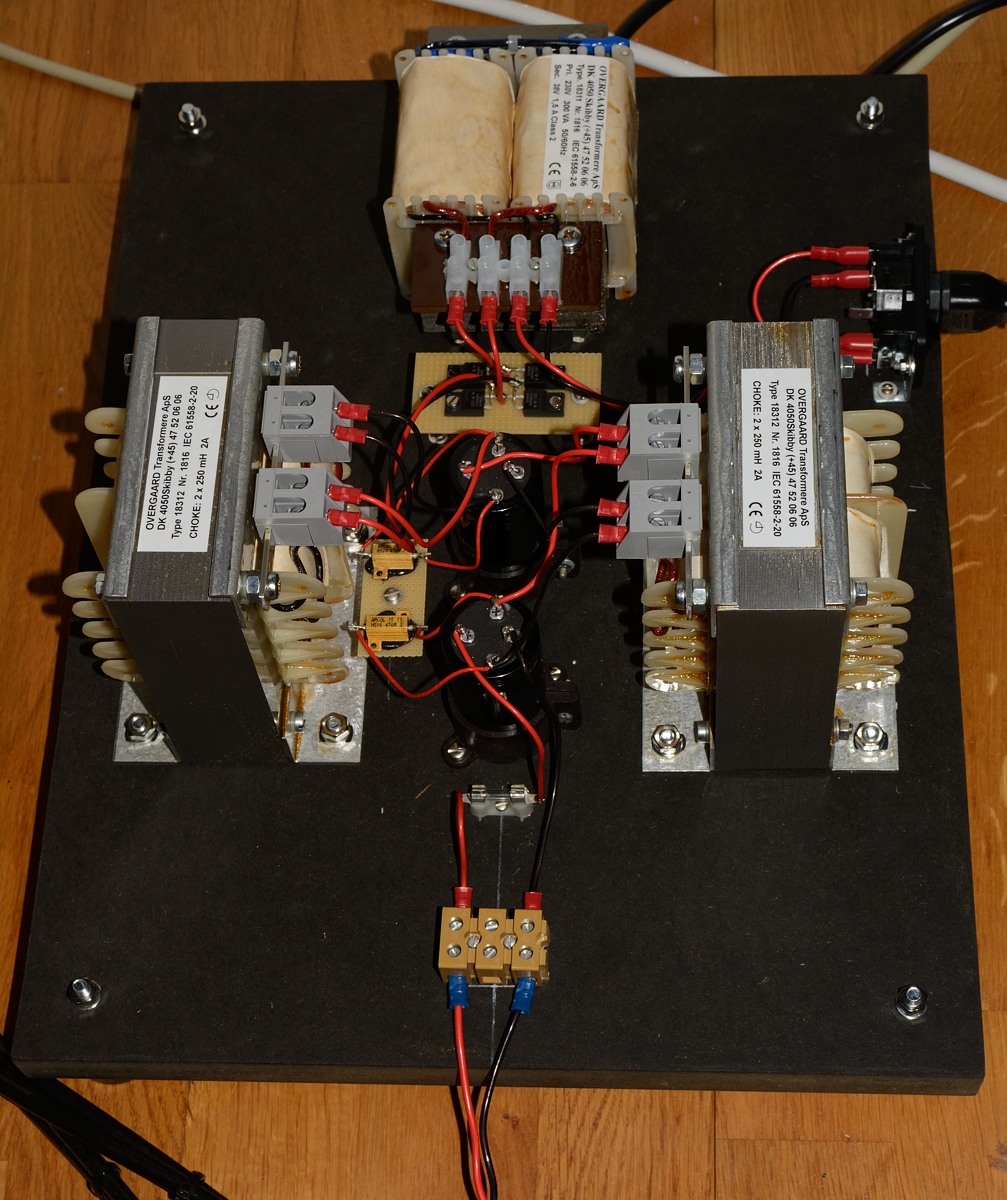

What benefits does the linear PSU and caps give you over the 24 volt switching supply?
Thanks!
I can't compare the sound between the original ACA and my version as I never built the original. But to my ears the sound is extremely good and so says my "HiFi friends".
My linear PSU is a LCLC version using a 300 VA trafo. The advantage is that such a PSU is very silent. No switching noise. Ripple is less than 1 mV. I use schottky diodes for the bridge. It is an expensive solution (around 1000 USD).

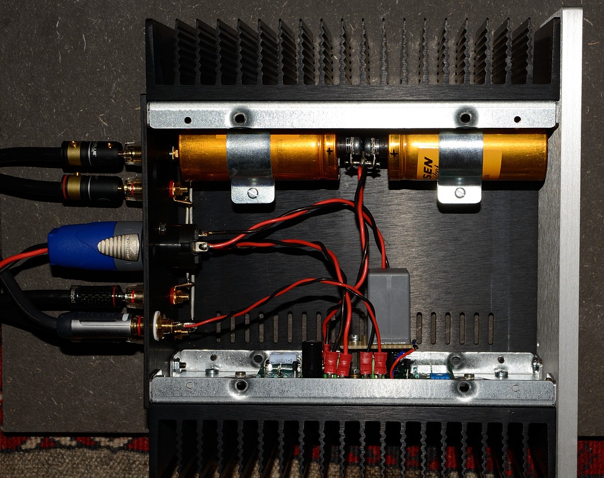

In the ACA itself I use a KEMET R75 series 160 VDC 10 uF MKP cap instead of the Silmic (input cap) and for the output cap I use two Jensen 3300 uF Audio grade caps (the two orange in the picture). They have very low ESR and very low inductance. Much lower than the cap in the kit. I have a LCR bridge so I have measured the parameters. How much this affects the sound I can't say but I am very satisfied. I think it gives me better low end because the caps has lower loss and lower impedance at low frequencies. But that is a guess only.

I have no sound in the speakers during power on/off.

Your power switch, is it for the mains into the power supply, or for the dc to the aca modules ?
I have no power switch on an ACA. I in "XLR hole" I have mounted a 2-pole Neutrik Speakon connector and use that for the power. It was recommended by Neutrik as it can take some current. So ACA gets 24 VDC via this connector. I like is as simple as possible so I dropped the switch on the ACA and also the LEDs. I have a main switch on the PSUs (on the 230 VAC side). I also use one ACA chassis for just one channel as I needed the space for the output capacitors. So it is a dual mono setup with two of those PSU's.
I use all 4 speaker terminals as I use it for bi-wiring.
All wires are with PTFE insulation and mostly 1.3 mm2 (AWG 16). Some leftovers for playing with tube amps.
