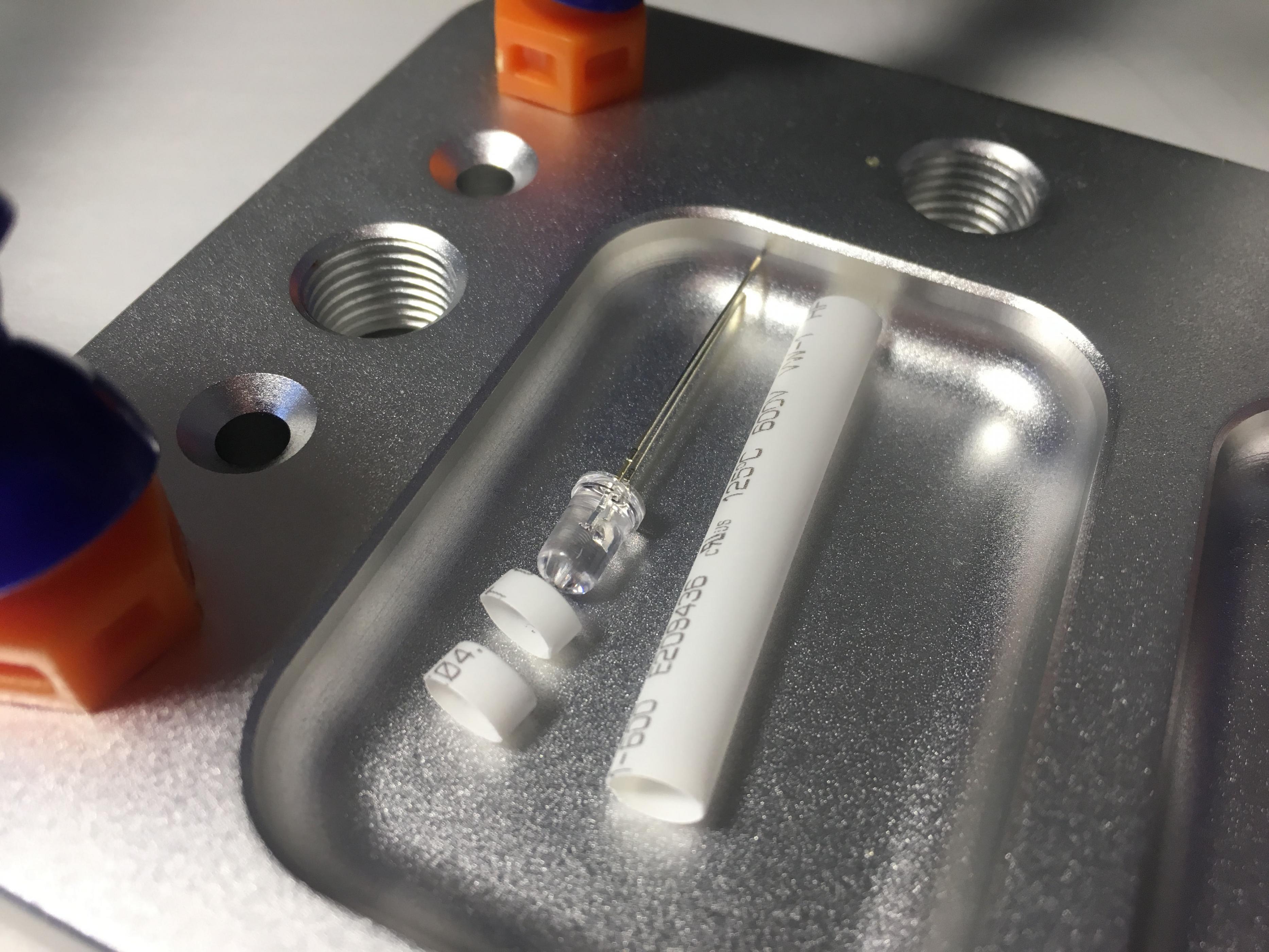

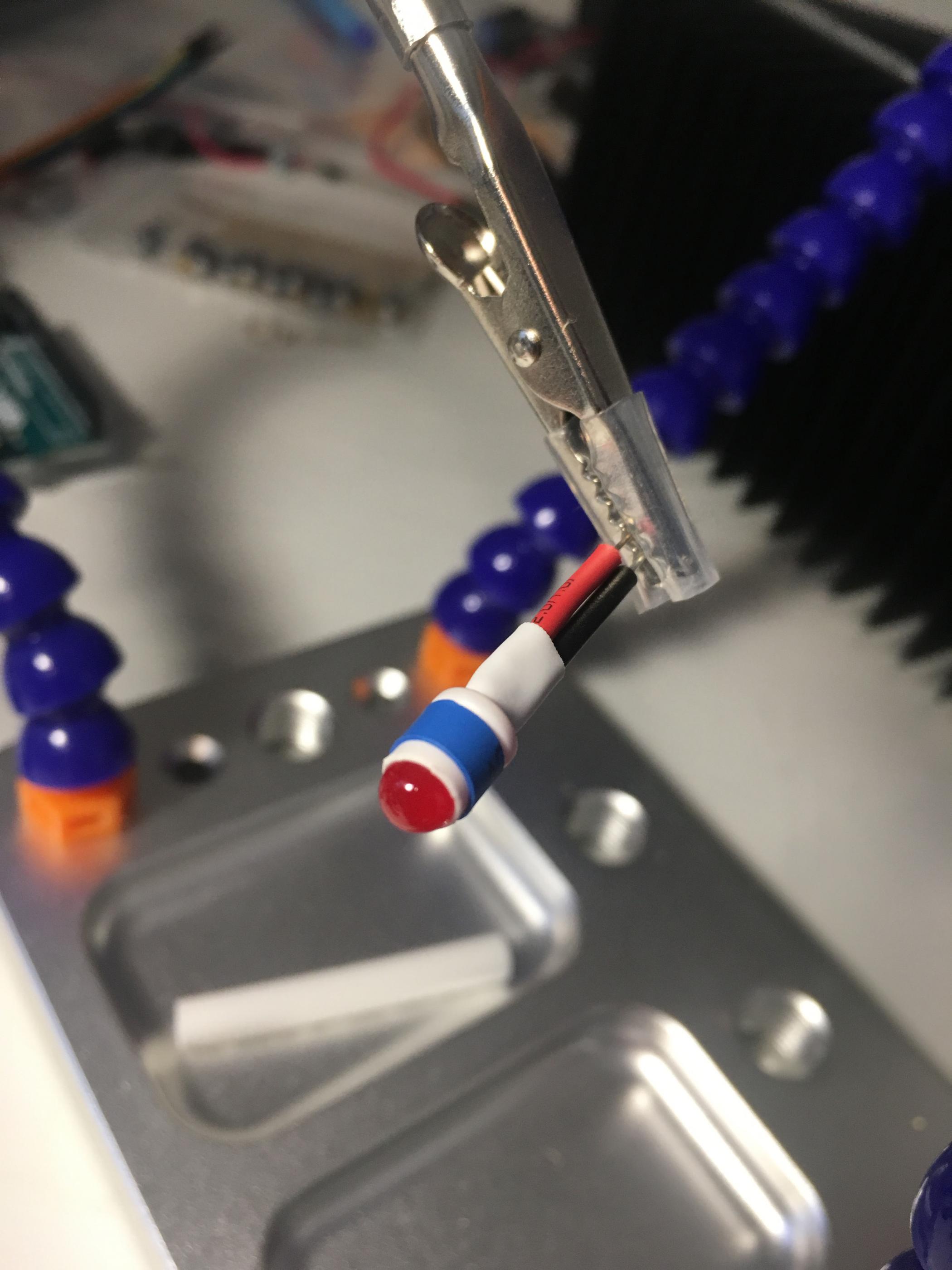

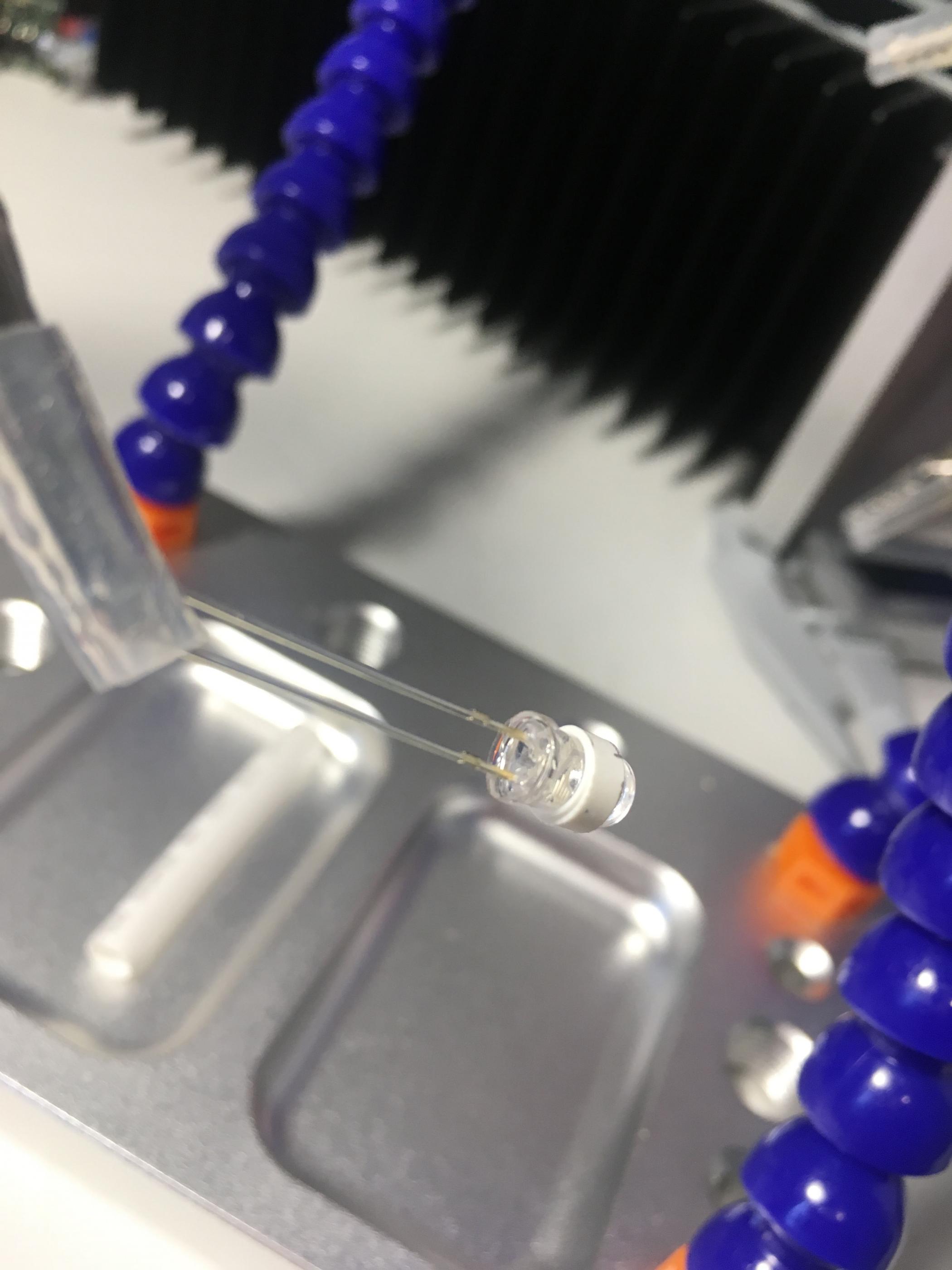

My preference, the LEDs should have standard holders. A great kit, "professional" except for lack penny worth LED holders
That's great feedback. We agree. Actually it's been a challenge to find "the right part" for this, and we've been looking at lots of different pre-fabricated options.
That said, I just tried your trick (using some heatshrink) and it worked great. I used one layer, shrunk it, then put another later over that, and shrunk that, and now the 5mm body of the LED nicely snug-press-fits into the 6mm hole and won't come out even without considerable force. I attach two examples, both need just the right about of force to go in, and to be pulled out again. You'd need heatshrink though... :/
We'll see what we can come up with something for the next batch, but sometimes it does take months to find the right part, secure it from a reliable supplier, get samples, make needed chassis or fixture changes, test a prototype to see what knock-on problems it causes, re-do photography / build guide, order it in quantity and then advertise it as part of the kit. Likely we'll include heatshrink in the next kit.

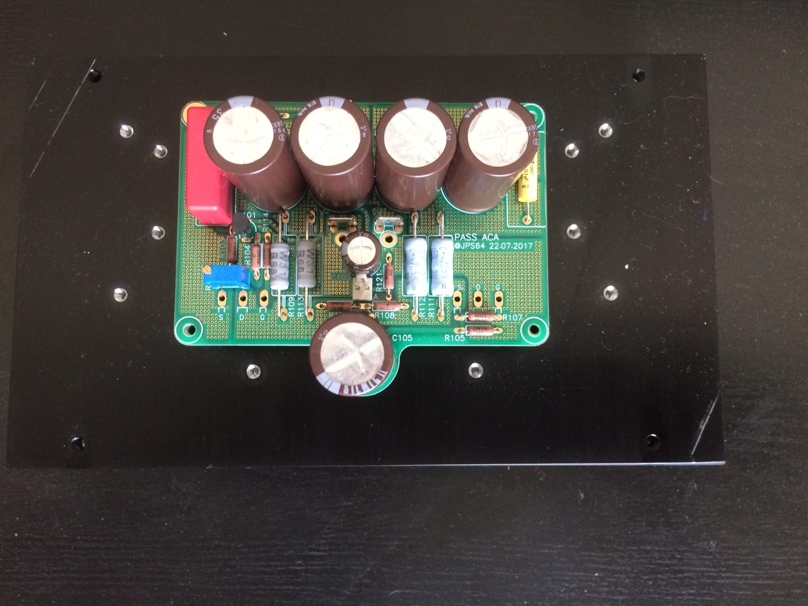

I bought a pair of PCB in Burning amp and Papa was gracious enough to give me a pair of ACA 1.1 PCBS. Can I build the balanced version with old PCB? What is the significant difference between version 1.1 and 1.6? I just need to get the clarified before I order the chassis or kit depending on the answer.
Yes. Circuits are the same. Boards are different layouts to allow mosfet mounting to the standard 2U enclosures. The bracket gets in the way when trying to mount the board to the heat sink with the 1.1 boards.
