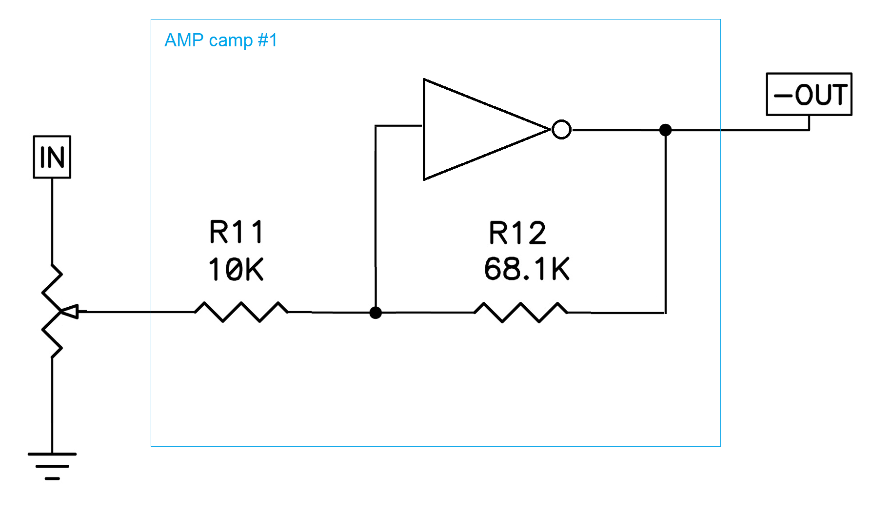

a potentiometer can be wired in to control the volume if your source doesn't have a volume control.
Though a pot would function, you may want to consider that with a 10k pot turned all the way up the source would see a 5K input impedance (The 10K and the amp camp in parallel).
You may also want to consider that the feedback loop is dependent on the source impedance. In the case of a 10k pot set to the middle (resistive not rotational) this would add another 2.5K to R11. This would affect the feedback ratio. My guess is the effects on, gain, distortion (would go down, as feedback goes up), output resistance (and its neighbor damping factor) would only be negligible at 10K, not going to calculate, the funs gone out of it a bit for me. Just things to keep in mind, if adding a pot. This illustration might help visualize (hope no one minds I used the digital NOT to represent the analog inverting part of the amp).

Is this good idea? ACA SIT
The R085 won't qualify as a SIT, but the other problem with these and
most other parts is that their input capacitance won't put up with a 10Kohm
source. In the case of the R085 the frequency response starts to go in
the upper midrange. That is why the AMP CAMP AMP used a fet buffer.
