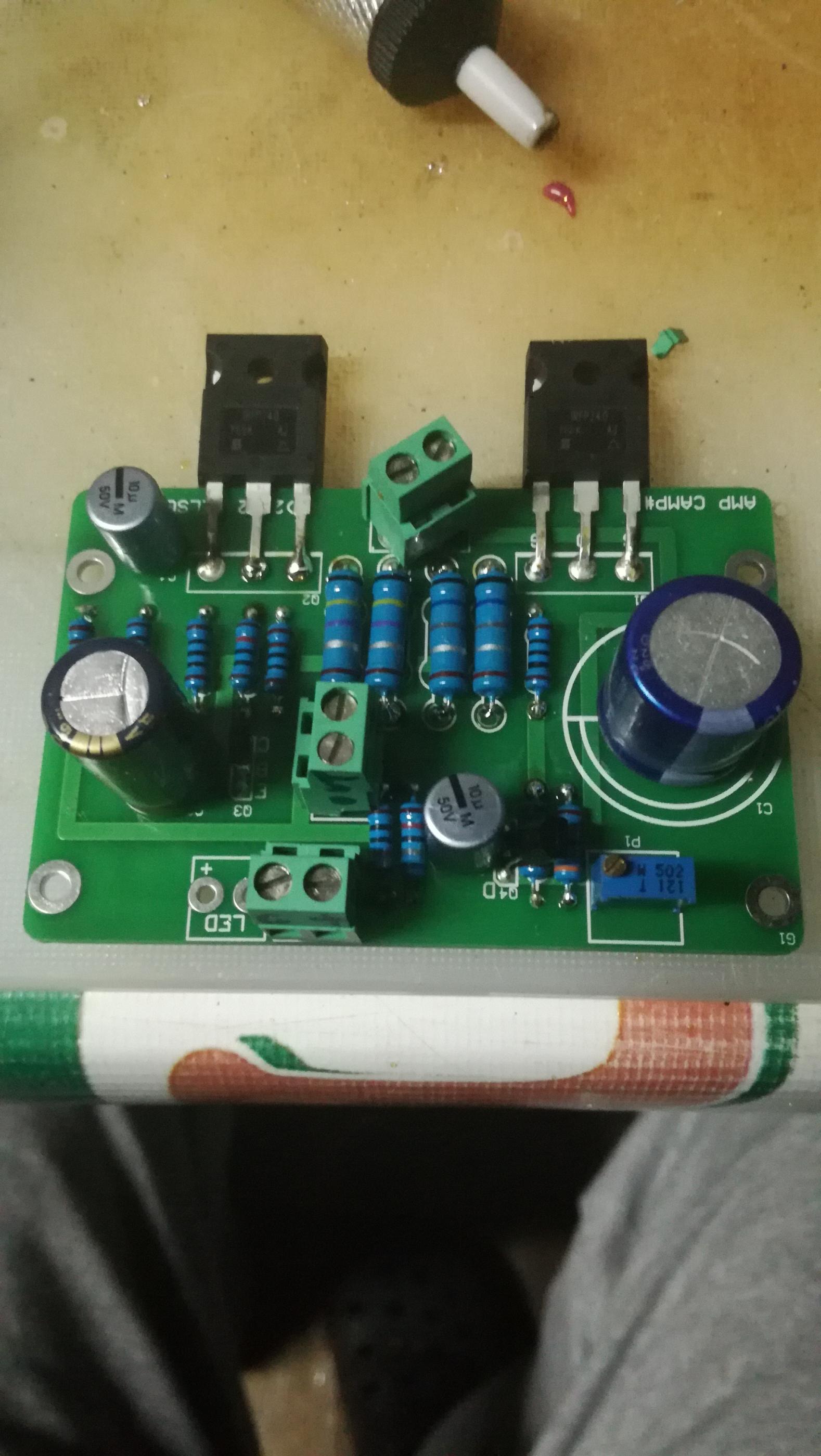

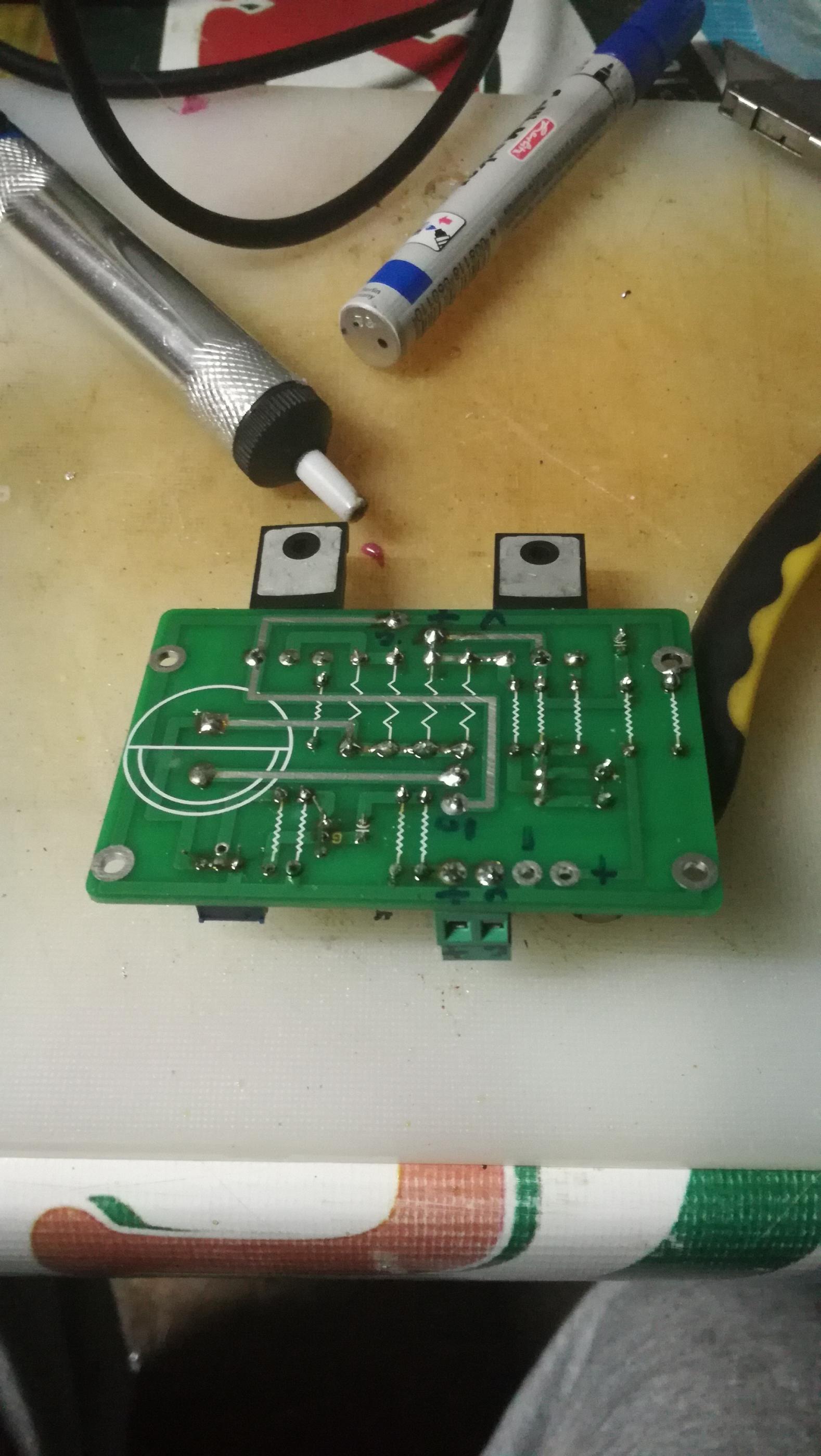

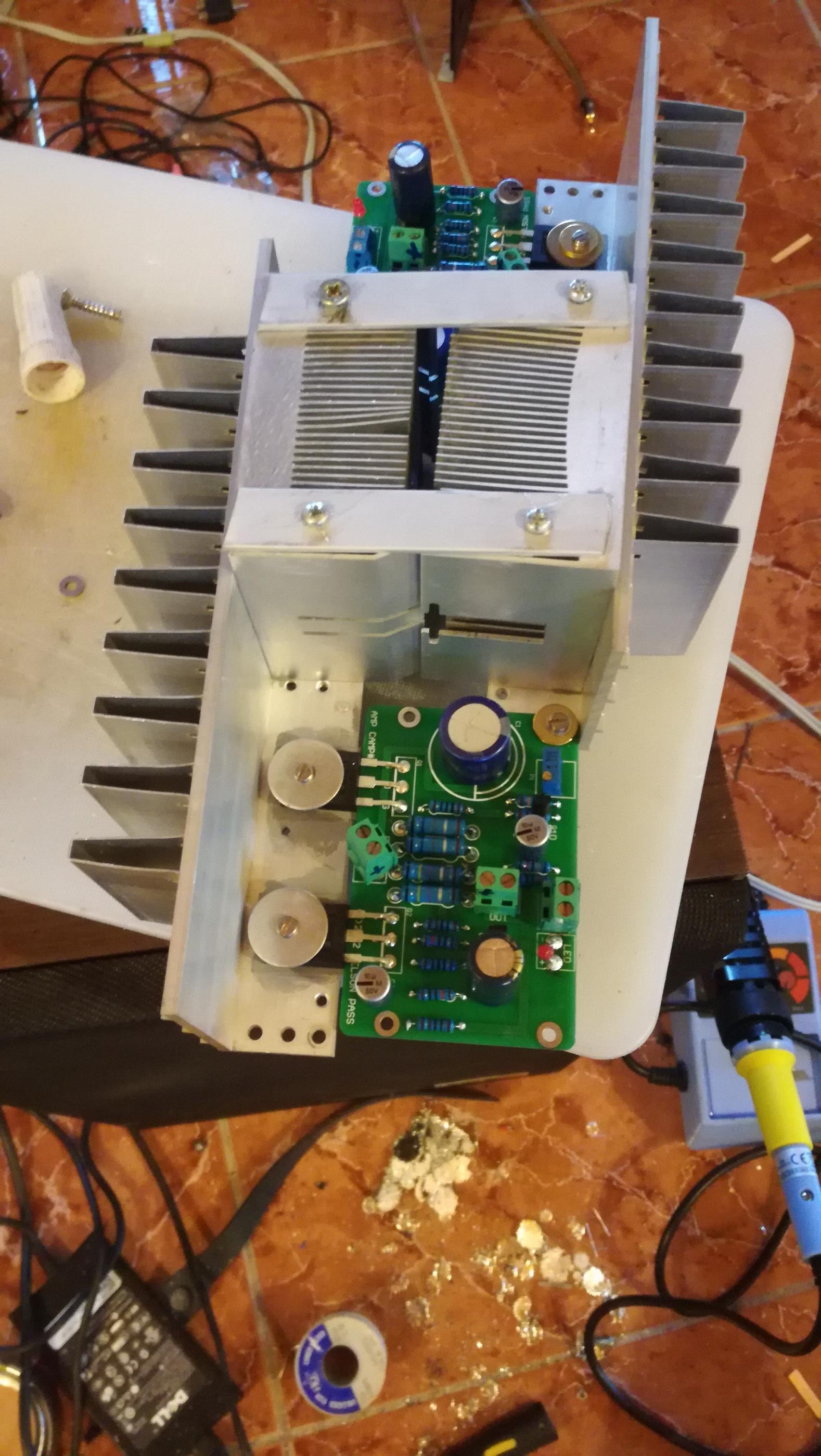

I have done my first amplifier....wow sublime sound vs Marantz PM66SE
Thinghs used:
- Amp Camp kit from ebay / China
- Marantz PM44SE cooling and 2 AMD coolers
- 2 DELL 65W psu 19,5 V chargers
- Thermalright thermal paste
Measurements - 10,20 -10,10 V ( can not stabilized it yer to 10 V) and 52 degrees C ( 20-22 room temp)
Ordered another one to bi-amplify 2 way bookshelf speakers - System Audio 1105 88 db sensitivity.
Sound: huge bass and profound, crystalline hights, sound stage almost very good
