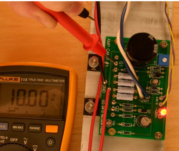

Have a question around setting bias of this amp. Does it make any difference if we attach a load to the output? Someone told me I needed to but never read it here anywhere.....

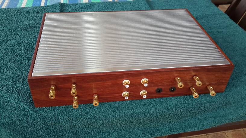

4 Channels on my 420mm x 275mm heatsink runs way too hot, can't touch it!!! Just wanted to make sure my bias setting method was correct, no load and 10v on the Q1 drain.
Is it correct that these run at about 26 watts load or no load? So that means my setup would be around 100 watts at idle, hot.....
all help you need is here: http://www.firstwatt.com/pdf/art_amp_camp_1.pdf

Chris,
You need the pictorial build guide. Here's a screen shot of the adjustment. Multimeter to Q1 and ground. Set the pot (blue plastic square with white screw adjustment) to 15v (or whatever your target is). Keep cover on as it will be when finished. With amp on, wait half hour and adjust again.
