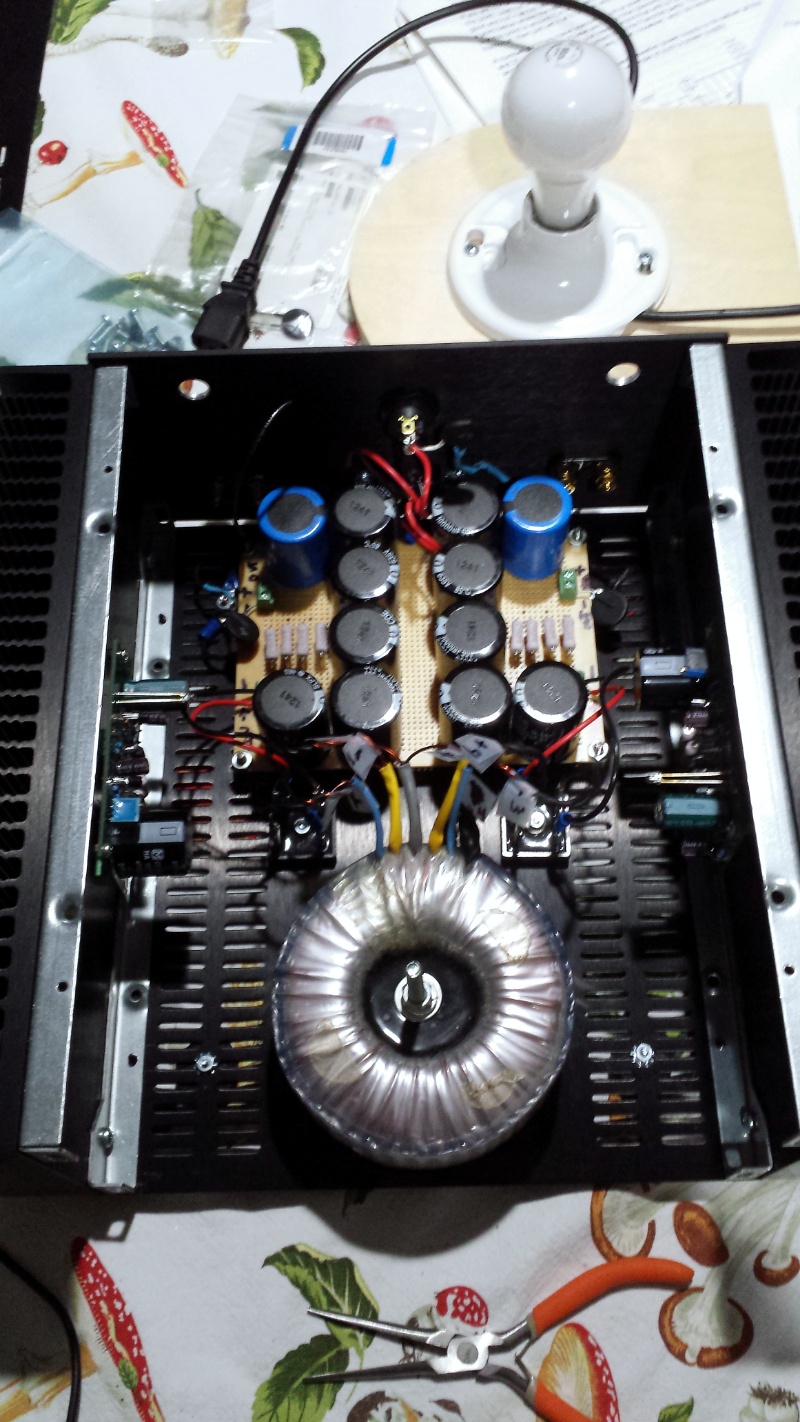

Hi guy's
I'm going to use 4 of these ACA's on an active project with minidsp, as these have a capacitor on the output I shouldn't need any other protection for my tweeters should I ?
The ACA does have a significant turn off thump. Could this damage a fragile tweeter? I'd hate to say no and then have to buy you new tweeter. Such a tweeter would be really cheap or very expensive. To be on the safe side, a smaller output cap could be used, perhaps one that is a little more transparent to high frequencies.

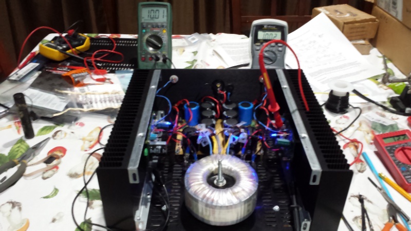

My ACA heat sinks runs all day at around skin temperature.
Power supply unloaded is 21v.
Loaded is 17.9v
P1 set to 10v on Q1 drain. Locked in well at 10v.
Is there any sense in raising the bias? Would it make any sonic difference?
Vince
Can someone comment on this please. Not sure things are running optimally.
Heat sink is 3U, 40mm thick, 300mm deep, wave profile.
Also, R15 is 2.67. Mod is 2.21k. Could this be source of cool running amp?
Thanks,
Vince
About 25 Watt is not a challenge for such a big heatsink.Can someone comment on this please. Not sure things are running optimally.
Thanks,
Vince
My ACA runs at 24V, has resistor mod and lives in a 2 U 300mm box. It never gets really hot dissipating almost 35 W. Conclusion, bigger sink, less power, cool amp.
Cheers
Thanks Ernest... I was hoping it would be due to the heat sink size. I ordered the 2.21k r15 today anyway.
I don't want to miss out on what everyone else is hearing!
Vince
