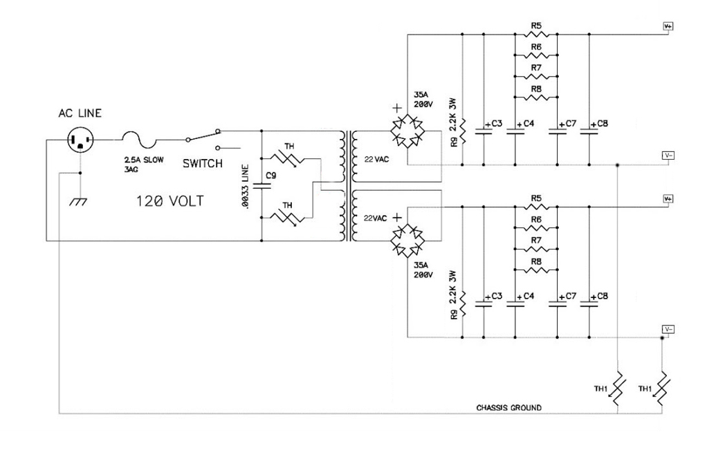

Hi All,
I'm working on the PSU for my "ACA on Steroids" and I need some advice. Planning on using the standard Pass PSU topology, except set up as dual mono single-voltage supplies rather than a pos/neg supply. I've attached a schematic of my proposed PSU. I'm planning on using the components I have on hand, so the caps will be 5600uf Elnas, and the pi resistors will be 1.2R. Bleeder resistors will be 2.2K. A couple of questions:
1) What is the value of C9? Am I correct in interpreting that as 330uf?
2) Is it imperative to use CL60 thermistors, or will CL50 (7R) or CL70 (16R) work? Don't know if my local electronics store has CL60, but they might have the others.
Thanks,
Chuck

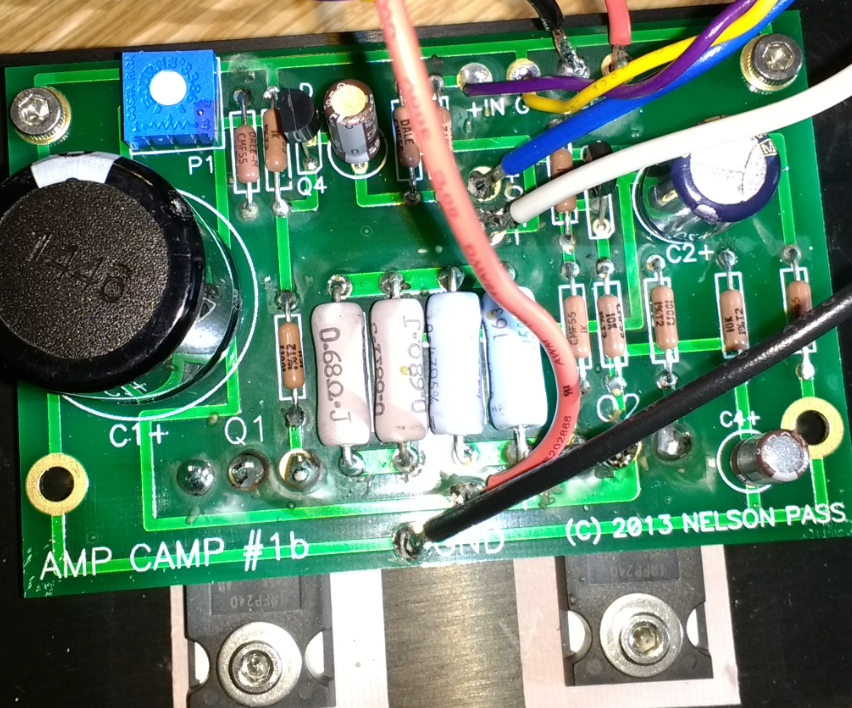

hi, @kpsthakur,
my acas only had the originally recommended 3300µF electrolytic cap (C1) but I always disliked the high frequency response. so after three years I thought it was time for a change.
The best electrolytic cap (I know of):>>http://de.rs-online.com/web/p/aluminium-elektrolytkondensatoren/1908911/<<
due to little space: one 10µF MKT:>>https://www.intertechnik.de/Shop/Frequenzweichenbauteile/Kondensatoren/MKT-axial-160-V/_MKTA10160_1768,de,7467,3876<<
and for smooth high frequency 0,47µF Tinfoil:>>https://www.intertechnik.de/Shop/Frequenzweichenbauteile/Kondensatoren/Audyn-Cap-KP-SN/_KPSN047250_1768,de,277,48479<<
all three in a parallel constellation acting as one cap.
the big sikorel cap had to be placed next to the pcb, wire connected, glued with silicone.
the acas are driven by my ba3fe clone and play exquisite with my 93dB Isophon Orchester 2000 from 1976 as well as less sensitive SMGA Magneplanars.
->amp pictures in the gallery
