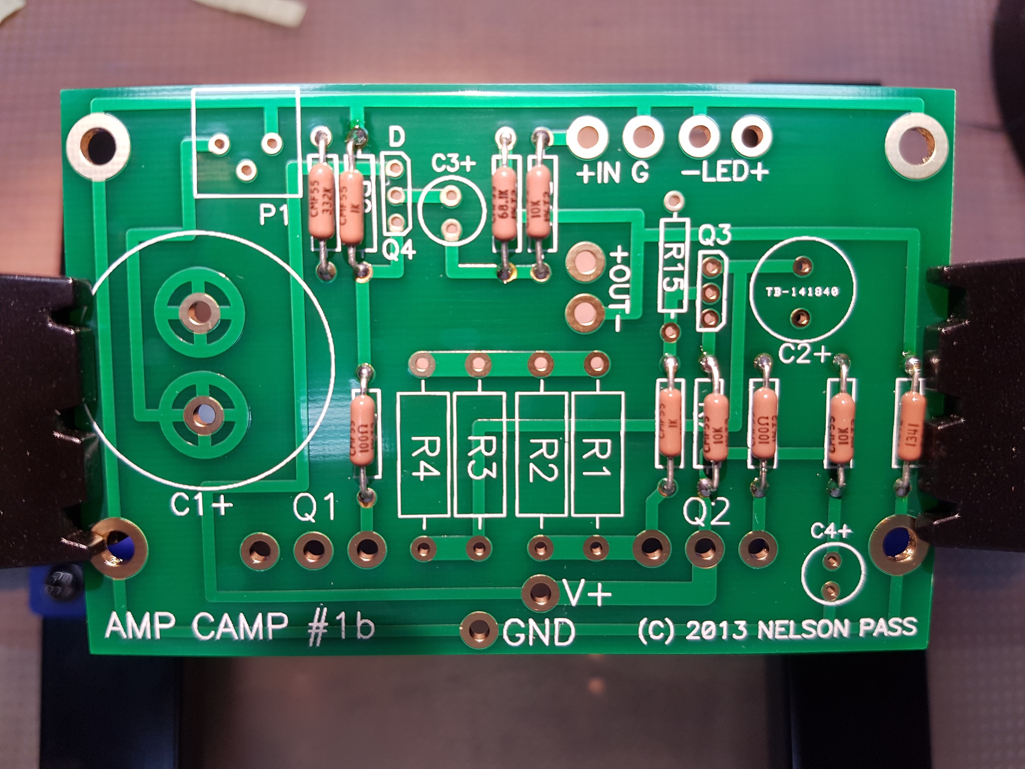

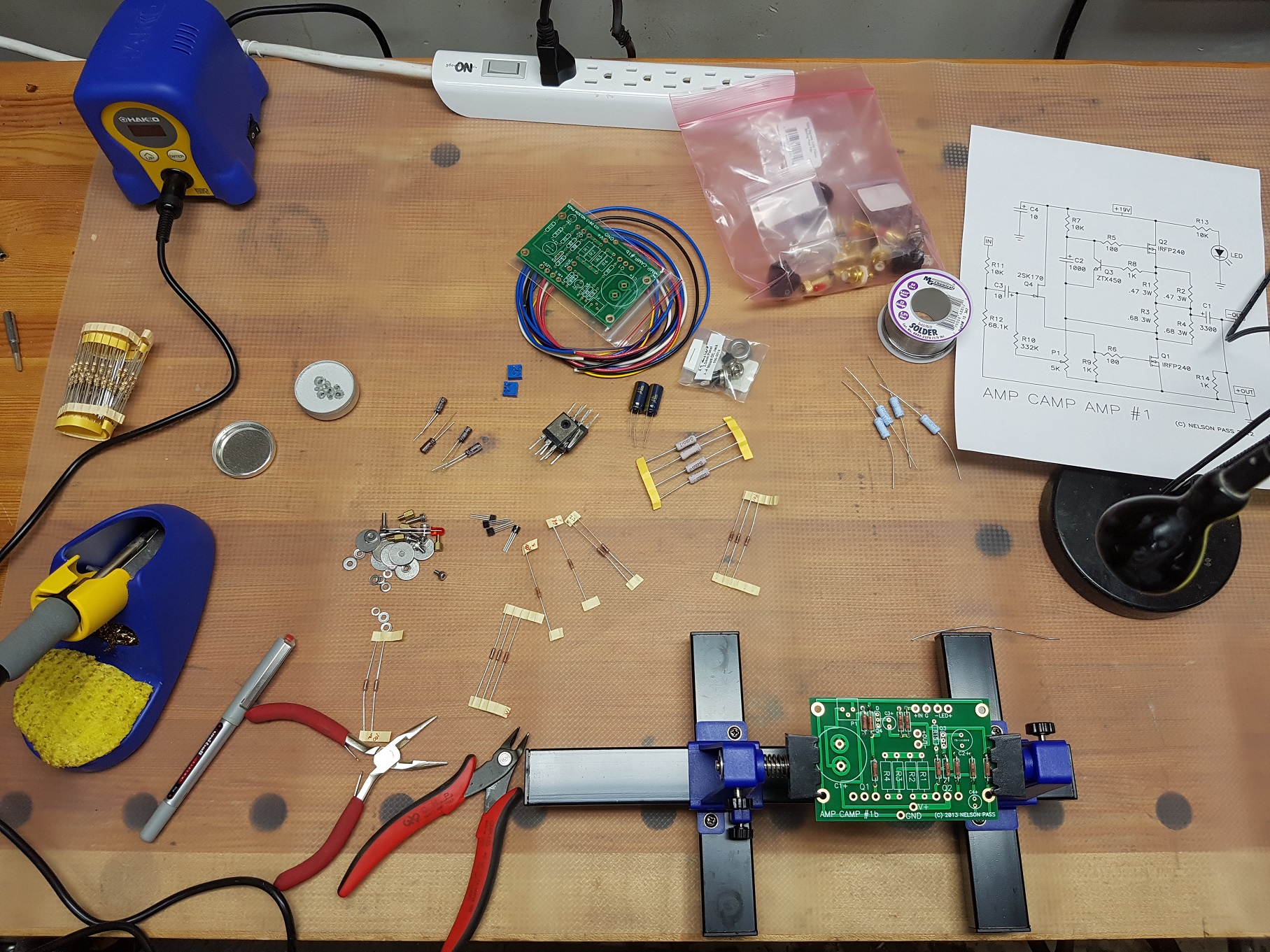

ACA Baby Steps
My head is swimming with little tiny farads, SITs, SICs, jfets, fetrons, etc from reading nearly 3000 posts on this board. The ACA kit showed up last week, and I got a chance to get going on it tonight.
I tried to buy one of these back in 2014, only to find they were sold out. I signed up to be notified when they came back in stock. Fast forward 2+ years, after completely forgetting about it, and I get an email a few weeks ago saying they are available. I didn't have to think very long before ordering.
This is one of those things that will definitely challenge me, and has been on the build-it bucket list for a while. Hoping to learn enough to eventually tackle a pre-amp build and then speakers to create an entire system. A few pics are attached. Not the best soldering, but I think it will work.
