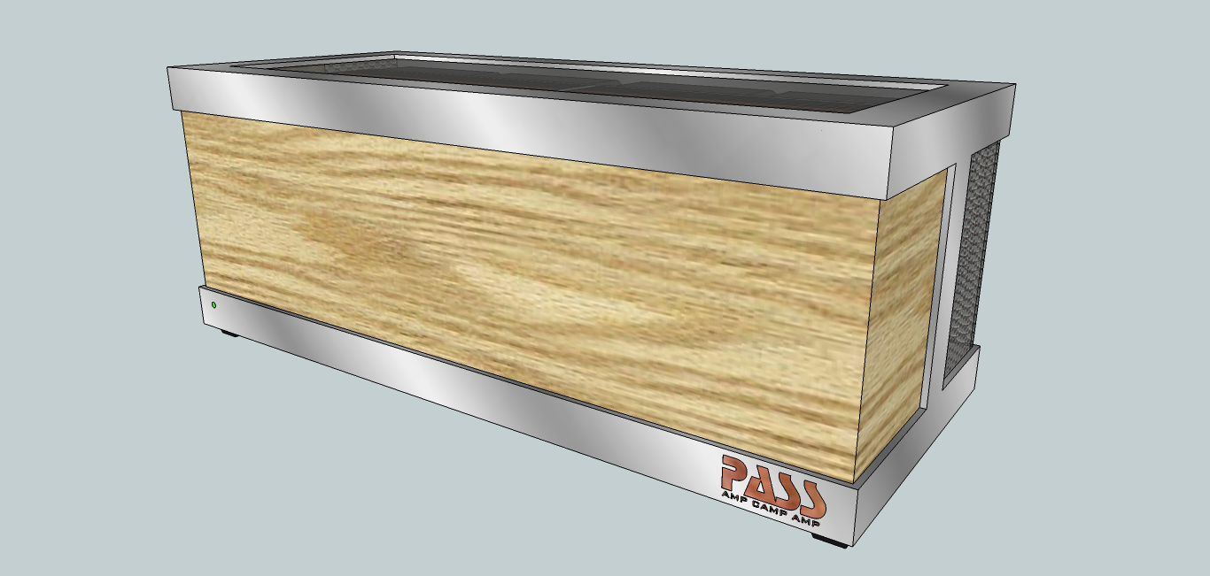

Ok, I've decided to go for my next ACA build. I going to try some new (to me) methods and materials in the chassis build, and I'll chronicle that in a build thread. But I'll be posting here to ask some technical questions.

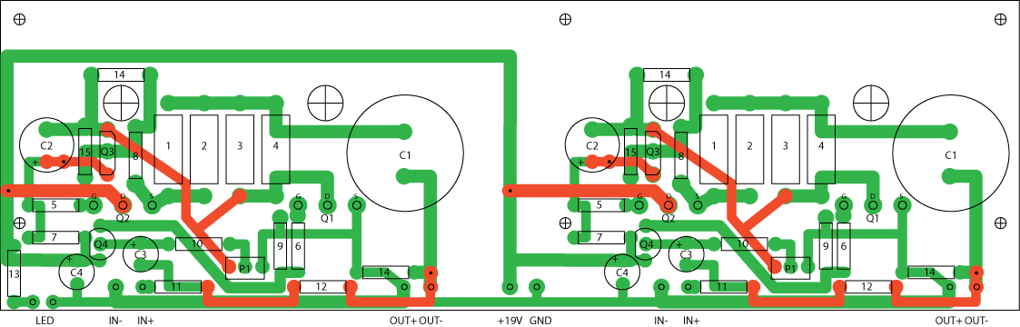

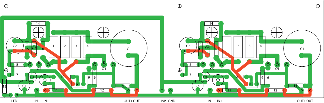

I've decided a DIY PCB is the way to go on this build, something I've never done before. I tried Eagle, but the learning curve was too steep for my now officially middle-aged brain. So I cobbled together a layout in Illustrator... see the attached image. I know nothing about PCB layout, as you may have figured out, so I'd like any input you may be able to offer. How many cardinal rules of PCB layout did I break?

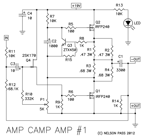

Since I'll be using IRFP150s instead of 240s, what other changes need to be made, other than halving the values of the power resistors? How many amperes does the circuit draw when using the IRFP150s?
A few notes:
• To facilitate removal of the PCB/heatsink subassembly, I'll be using Molex terminal blocks or other connectors for the input, output, power, fan, and LED connections.
•I've yet to decide on a fan control circuit, so it is not yet included in the PCB layout.
• All lead spacings are approximate, and will be confirmed later.
•The four largish holes in the PCB are there to allow removal of the MOSFET mounting screws, so the boards can be removed along with the MOSFETs without having to desolder them.
Any feedback would be greatly appreciated!

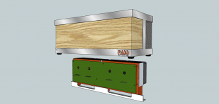

I really like your proposed case styling. Especially the second one with perforated metal sides. Perf metal is one of my favorite materials.
Nice work!

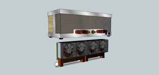

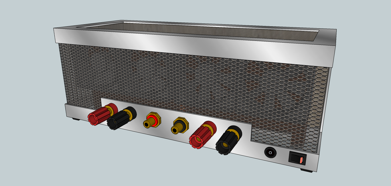

Thanks Mike,
The second image is just a rear view of the same amp. Wood up front, perf. metal rear & top. See the attached pix for views of the chassis lifted off the PCB/heatsink/fan assembly. This thing is going to be pretty small: 8 1/2"w X 3 1/4"h X 3 1/2"d. Going to be employing welding, etching, and plating, among other fun stuff. It ain't fun if it ain't challenging!
But I'd really like some input on the PCB layout...
Well 2pD, there's a long way between design and successful execution... and the circuit design stuff is way over my head so I'll never equal Mr. Daniel's work.

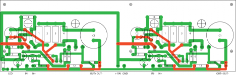

BTW, I caught a couple of errors on the PCB layout (such as a missing trace to Q2 drain), and I added some vias where needed... New layout attached.
I guess I was unclear.
I want to understand how the circuit operates. Why does a change in P1 alter the voltage on the Q1 drain?
blubugeye,
P1 is a feedback loop. Here's how it works, initially Q1 is turned off. The constant current source Q2 rains down current from its source pin. Since Q1 is turned off the current has nowhere to go so the voltage before the output cap starts to rise. Now some ratio of that voltage goes to the gate of the jfet via R10, which in turn causes the voltage to rise on the gate of Q1 which pulls the current Q2 is injecting into the output to ground instead. Q1 has a threshold voltage where it starts to conduct when the gate goes a few volts higher than its source. So p1 is trimming that value to be exactly half the rail voltage. If the voltage before the cap on the output goes too high then Q1 gets turned on harder to pull down the voltage or if the voltage goes too low Q1 gets turned off a little to lift up the voltage. You see no current on your multi-meter because the jfet senses the voltage field. It’s not a current amplifier like a bipolar transistor so the current is microscopic to charge the gate of the jfet. The jfet is a follower in this mode. Which means the source voltage is just following the gate voltage, with maybe a little offset.
Hope that helps.
blubugeye,
... If the voltage before the cap on the output goes too high then Q1 gets turned on harder to pull down the voltage or if the voltage goes too low Q1 gets turned off a little to lift up the voltage. ...
Hope that helps.
Yes, that does help.
So, in spirit, the "resistance" presented by Q1 is adjusted by feedback through P1 and dictates the voltage at the Q1 drain.
Thanks!
