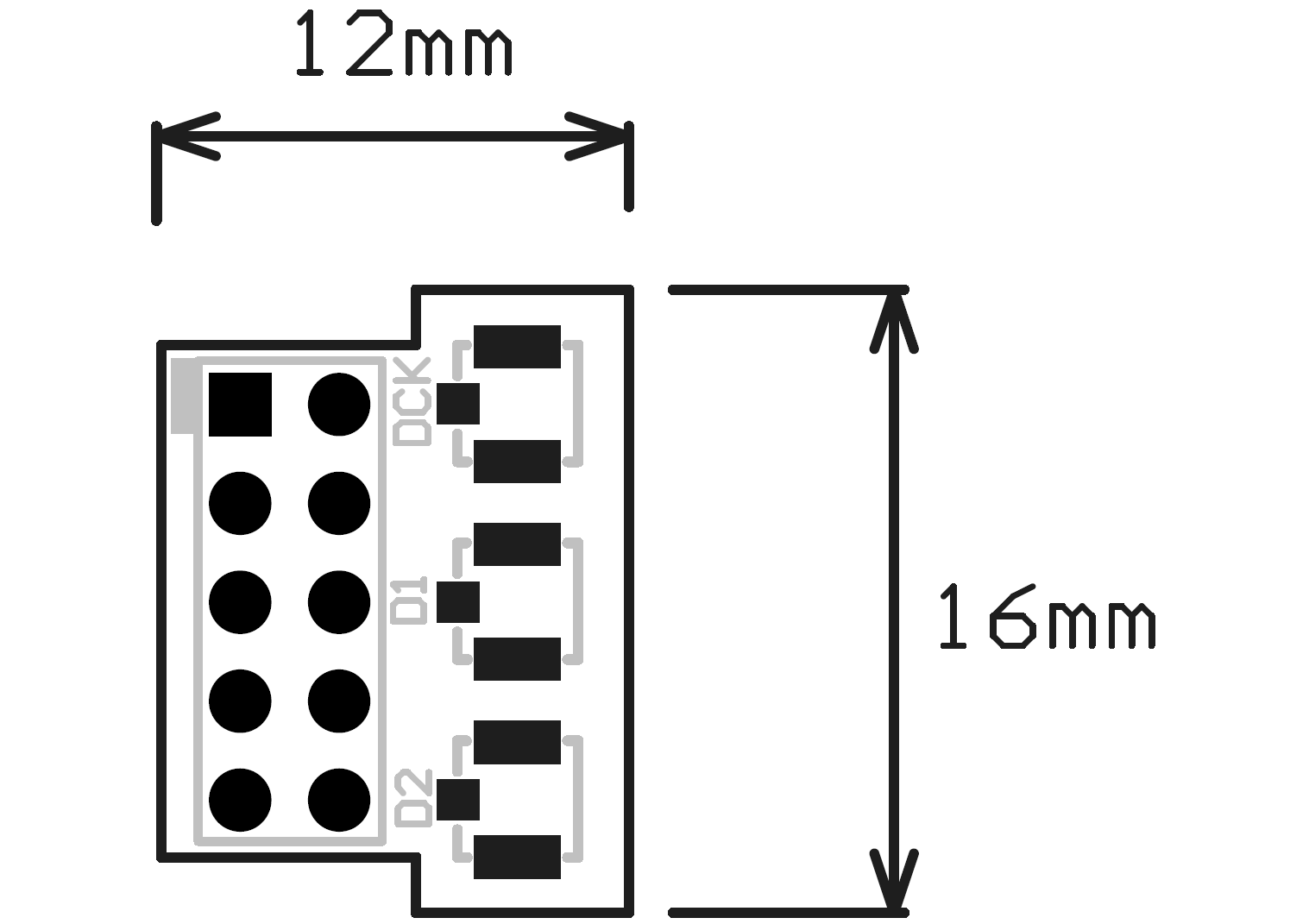

Is this to fit the BIII DIN header?
Sorry, apart from VD, I cannot see how the rest of the holes will fit the 0.1 inch pitch header of DIN?
Assuming also you just want the stereo connections only- will simplify layout for a new board
I can see your point (had not spotted that). Here is the original page http://www.diyaudio.com/forums/grou...-pdif-fifo-kit-group-buy-168.html#post4113678. My best guess is that that board gets soldered to a female DIN socket, but cannot figure out exactly how.
Indeed I just need to connect DCK, D1 and D2.

Just realised. while checking carefully, there is a pitch error with the DDDCA-UFL boards - 2mm instead of 2.54mm:eek:
I will to redo your boards for replacement but will take another 2 weeks to sort out.
Shipment to others have also been recalled!
Really sorry for the issues:faint:

Thanks for the information. All clear now :)
I would like to go for a more optimized layout just for 2CH with a simple thru-hole connection direct to DIN of BIII. Solder to BIII DIN pins or add socket if you wish to. Not exactly the best interface compared with UFL direct on DAC board but better than wiring to pins. See Ian's comments
BIII-UFL 2CH
Price is USD 15 with UFL loaded. Min order 10pcs
