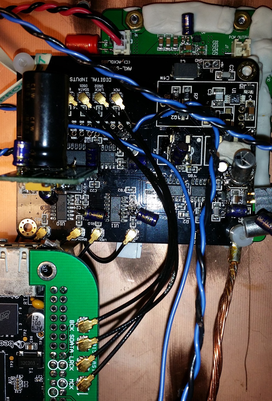

Walter..., I'm curious where you put these caps, could you spare another picture at some point, no rush..?
stijn001
I will be happy to post a pic. Not a pretty sight. Acko's beautiful board sprouted 8 new little caps. I will snap a pic next time I am in there.
Walter

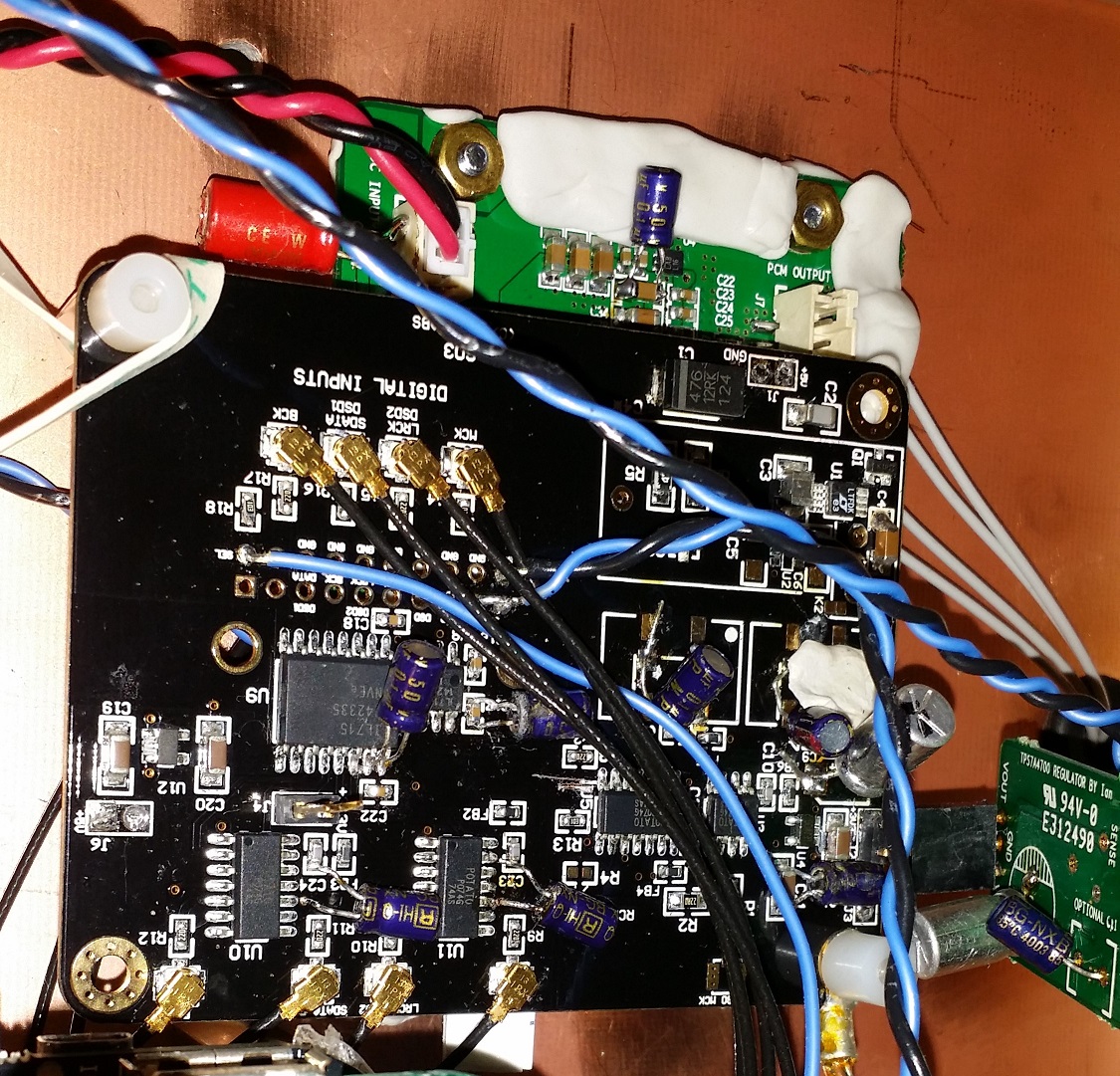

Here are a couple of clips of my BG cap attack. As always, I claim no engineering insight. Just noticed that a fair number of the early moders raved about BG NX HiQ as close to the power pins in the digital processors around a DAC.
I left the existing SMT caps. There is a TPA4700 reg on each of J4 and the clock PS. They have 0.1uF HiQ caps add as well as a nude BG N 33uF. Another 33u nude N on C9 for good measure. Each clock as a .1uf HiQ on its power pin. The white goop is mac tac for vibration dampening of the clock. (highly recommended).
The Potatoe chips have several power pins. I chose pin 10. There is a nice little via just off the pin on the 3.3v trace that makes for an easy (relatively) solder and its pretty close to the pin. On U9 isolator I tacked one right on the pins 13 & 14. Nice short lines as I think the isolators like quiet power.
By the time I got to U5 I was getting really lazy. I just popped one on the filter cap C11 as a bypass just in case.
Same with the Ian I2S PCM board that comes after the S03. Just added a .1uf as a bypass on the PS filter cap bank and a BG N on the 5v input.
Then for good measure I put 33uf HiQ caps on the +-5v lines to my TDA1541a and a 33u BG N to the -15v rail.
Must say after a week the thing is really singing. I am listening to a Less Loss demo recording of drums at 192k sampling. WOW. Not sure 1541a was ever meant to sound this good.
I hope people get a good chuckle looking at my so3 with vintage radial caps all over it. Must say however sound is sweet.
