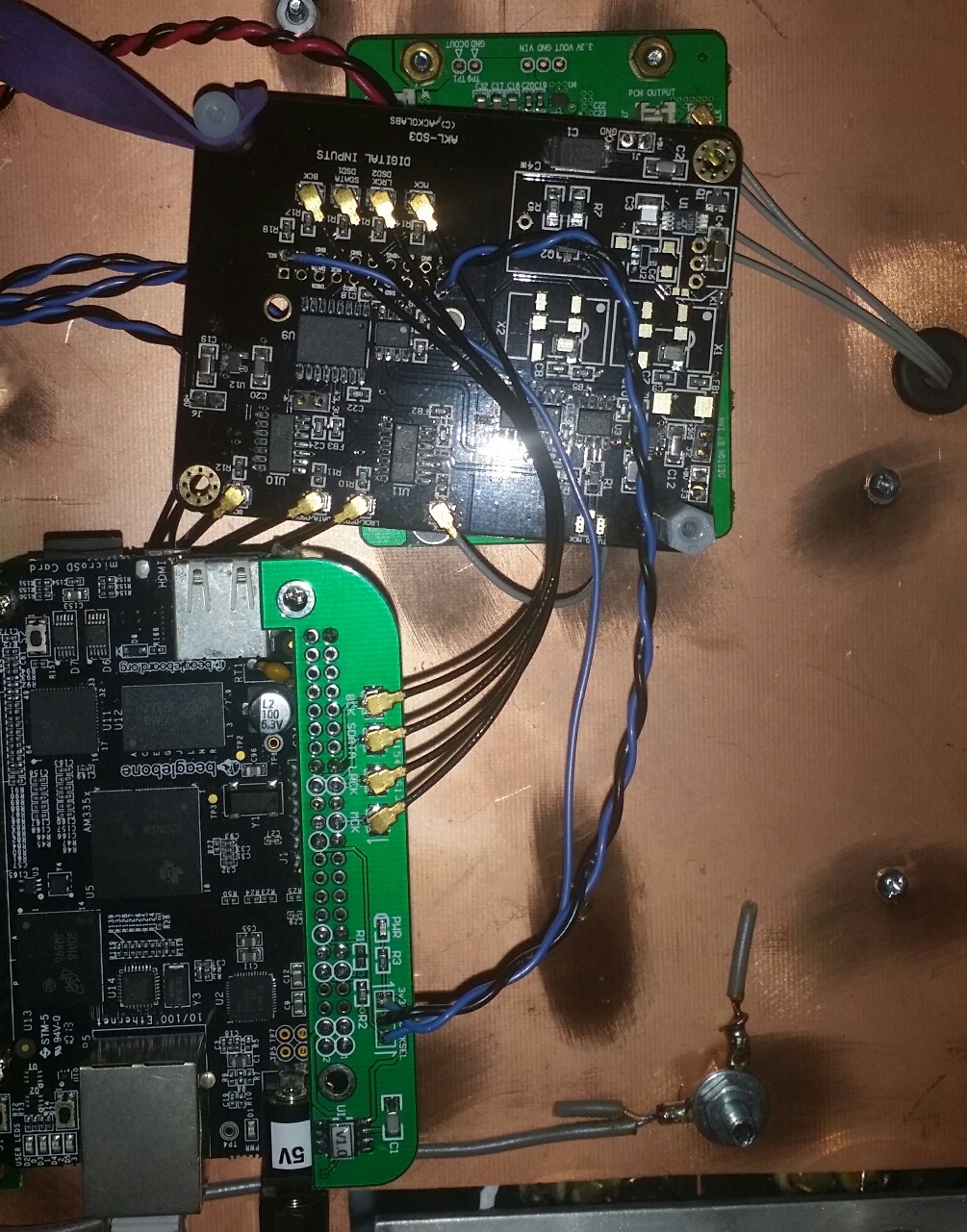

Sounds like you have done your homework. From what I remember the software side seems fine. If voltages and connections check out (pictures might be helpfull if you want a second opinion). I use both the WaveIO and BBB through the S03 into a PCM1794 so with redbook material I wouldn't expect you'd have an issue with I2S wordlength or left/right justified. Maybe Ian or Acko have some suggestions.

Thanks stijn001. I will post pics tonight. Thinking about it, lack of 3.3v power from bbb to isolator could kill the signals. I will also double check this. I had to manually solder the ufl connectors to the input side of the I2S/PCM board. This could be the culprit.

That's a good point. One mistake I'd made, was to connect the 3.3v from the BBB to the S03 at the wrong pin. There was something with two pins, one connecting to U3(?) that controls the clock selection and one to the isolator, if I remember correctly, I'd have to doublecheck the diagrams again. Maybe you want to double check this.

Please check the BCK output of the S03 board while playing music. It should be switching nicely. If you have no scope then measure the dc avg, should be ~1.6V. If none then try to trace backwards to source
@stijn001, thanks for helping out also
I have 1.641v on BCK output from S03!!! Yay! This means everything is working up to the output of S03, right? That is great. The hardest part would be if I had messed up S03 smt soldering.
I checked all the connections from bbb to s03. They all seem fine. Sounds like it is time to focus on the i2S/pcm ufl connectors.

Checked the kernel option snd_soc_botic.ext_masterclk is set to 3.
S03 clearly had both clocks working as BBB played all sample rates.
But I could never drive the Ian/I2s/PCM brd and get a lock.

stijn001 said:Did you jumper the 3.3V pin at the BBB side of the isolator, I dont' see it in your picture?
stijn001
Great eye for detail! I did not. I will look for the schematic for the S03 and see if that could explain the behavior I see. Certainly worth a try. If the isolator is not functioning, then it would certainly cause the issue I see.
I suspect you have found my issue

I reviewed the schematic and then the pcb, and the 3.3v pins 2 and 4 supply power to the dirty side of the 2 isolators. I had assumed without checking that they were joined on the pcb and that I only needed to connect to one. Certainly with one of the isolators powered off, no music. I will put it in my system on the weekend and report back.
But I certainly wanted to say thanks for reviewing so closely and likely having found my issue just from a photo.

Walter, I did make a change to join these pins on board and you may have this latest revision board. Please check your board again... rev suffix
Thanks Acko
I checked pins 2 & 4 for continuity. They are quite separate. I will connect them and see if that is my only error.
Walter
If this is the case you have a previous rev board and similar problems were reported by stijn001 and the fix: -> Here
Success

You are the master! I put in the jumper and am happily listening to music on the BBB - S03 - Ian I2S/PCM - TDA1541A setup. No more USB.
Immediately it was clear this is a new paradigm in sound quality. Thank you Acko for the design and the pcbs.
