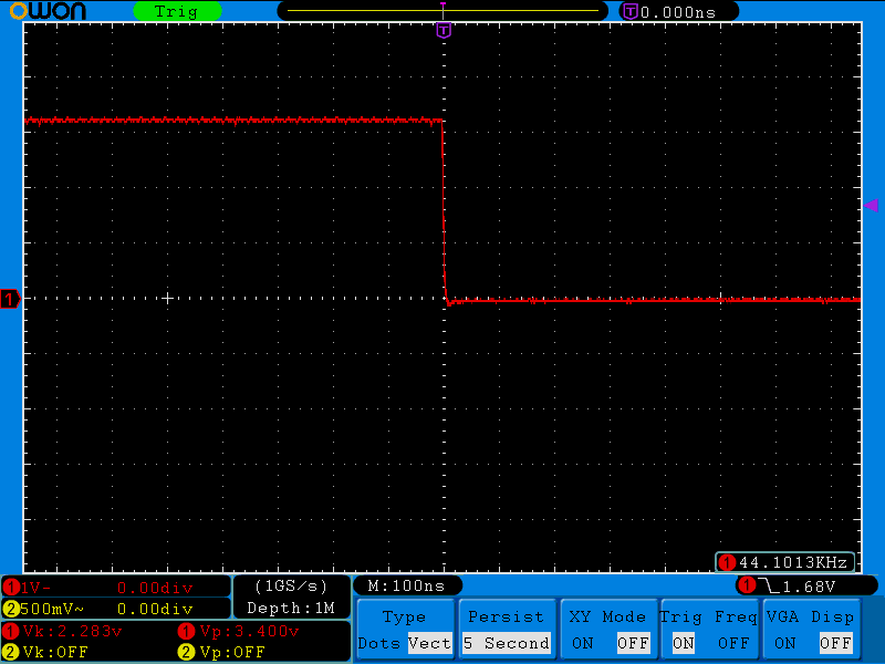

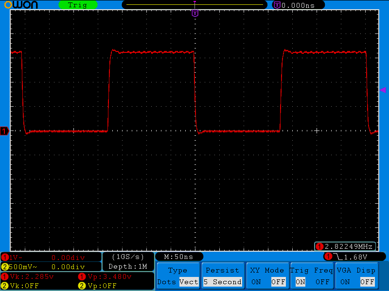

I repeat the same tests to my 100MHz oscilloscope (full BW), no any termination at the end of probes.
Persist mode = 5sec
Sampling playing file = 44.1KHz
I have two Crystek clocks (45+/49+) on S03.
I can't reproduce the miksi's finds.

I'll have to check, but I think buffered clock edges coincide with bck and partly lrck and this results in uncertanity of reclocked signals. Simple way to resolve this might be to delay clock signal by adding some resistance and I will try this. Is there any benefit in using thin film smd resistors in this case because I only have some 22 ohms? Thin film are unavailable here and acquiring these at Farnell or any other place is justified only within some bigger parts list.

Should not be the case if you look at the timing diagram as shown in the user's guide. Outputs should 'lock' nicely with clean edges to the reference clock (RCK)
@Lemon, thanks for the plots. So 100MHz is good enough for checking I2S signals. I think I have to tune my probes as the outputs were clean but skewed like sawtooth waveforms. Anyway I also did multimeter checks and found the d.c average ~1.62V which means nearly perfect switching from rail-rail 3.3V swing.
R2 can be changed to delay accordingly but may also affect the rise time for edge triggering of the FFs

your test looks almost perfect. Maybe 90/98 clocks are not the best solution. Also I have default firmare on Amanero, I didn't tried latest cpld and cpu editions.
Should not use default fw (Amanero in master mode)
Amanero should be slaved to the S03
This could be the cause of your problems
I have users with 90/98 clocks and reported sounding really good!
