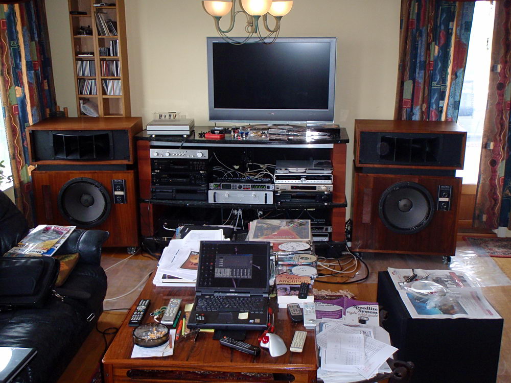

Tom may be too modest to tell it like it is, but as one who has employed his Synergy and Paraline concepts in my own cabinets, I can say that they are a significant improvement over the “old school” separate horn approach like the A7, or a horn above a front loaded speaker.
I have been copying design features of various horn cabinets, and doing incremental upgrades on them for decades.
Tom Danley has done the same, and has made many of his own innovations.
Once I was aware of them, I tried and tested his concepts and listened to the results.
My posts in #2 and subsequent posts come because I have heard what those innovations can do sonically, copying a “good old” design when there are design concepts that take up similar space and have far more accurate acoustic response makes no sense to me.
Tom’s concept of coupling mid drivers through an an acoustical LP filter (the small port holes) near the HF driver horn throat entrance could be applied to other expansions, but HF dispersion is largely dependent on the horn wall angle set relative to the wavelength traveled.
In other words, an exponential, hypex or tractrix “Synergy “ type horn would “beam” the HF, since the initial throat would be a narrow angle compared to the latter expansion.
In a conical expansion the sidewall angle determines the directivity pattern down to a wavelength approximating the mouth area, constant directivity is a very good thing if even coverage is desired over a wide area.
As far as seeing IM/modulation effects on the HF driver's diaphragm, the pressure generated by other drivers going in to the HF driver is so much less compared to the pressure generated by the HF diaphragm that it is not a problem. If it were a problem, any co-ax design would suffer from it, empirically we know that they don’t.

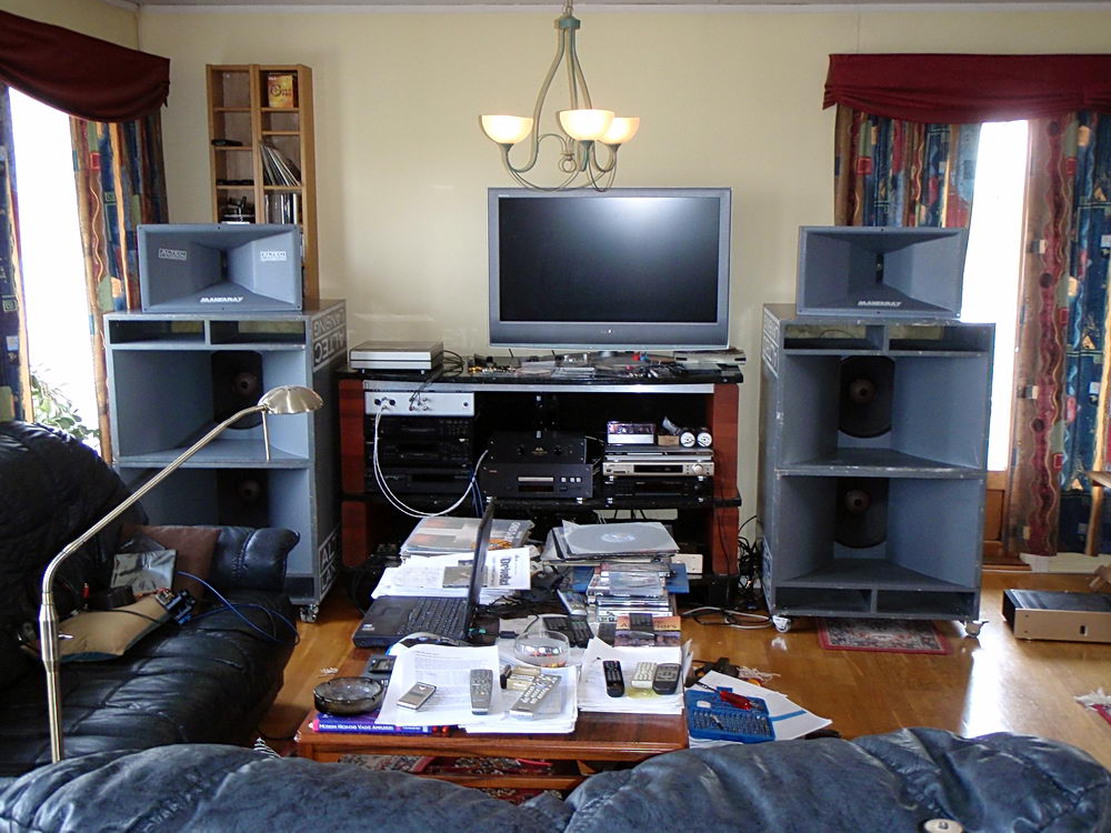

It had been my intention to write an “upgrade” article back then; I took pictures and had made some notes on what I did. It involved several minor cabinet modifications (and moving the horn slightly, easy), new drivers (I used a 2226 and BMS4550) and a new crossover.
If there is interest in such a thing, I will find the old hard drive this stuff is on.
I think this would be interesting indeed.
