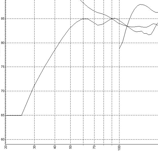

I'm curious as to what voltage would be required to hit 100 dB at 30 Hz at your listening seat, measuring your modified A7/5's fundamental, not harmonics.
Probably a lot, as they roll of higher than that.
Yeah, looking at Tom's before and after graphs, looks like the stock A7 rolls off around 120 Hz, and the "after" rolls off from 60 Hz.
Such a huge cabinet for so little low frequency.

Yeah, it's a crazy big box not to go down lower. Tom's graph looks about like what I got with the original ports. After some work there and I'm down to the mid 40s. I "think" there's another ~10Hz to squeeze out if the ports are right. More work to do.
The trade off for me is the naturalness of the sound. It's a box that does not sound like a box - it sounds like real acoustic instruments. And that's what I like.

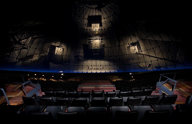

We supply some cabinets to some high end theaters, ones where the size or sound requires something more. This is one of the theaters; it is the Museum of Science and Industry in Chicago. It had been an Omni-max theater, a 5 story tall sphere but has now been converted to an IMAX.
The speakers are SH-96’s and four TH-50 subwoofers.

The advantage of these over the normal way of separate sources and horns is that there is only one source, no lobes or nulls, the entire front of the cabinet is usually the mouth so the pattern loss F is as low as possible.
On the other hand, having all the drivers loading one horn, makes the package a lot smaller. Consider (relative to the old way) the SH-96 has four 15” woofers, 6, mid horn drivers and one 1.4 inch hf compression driver.
