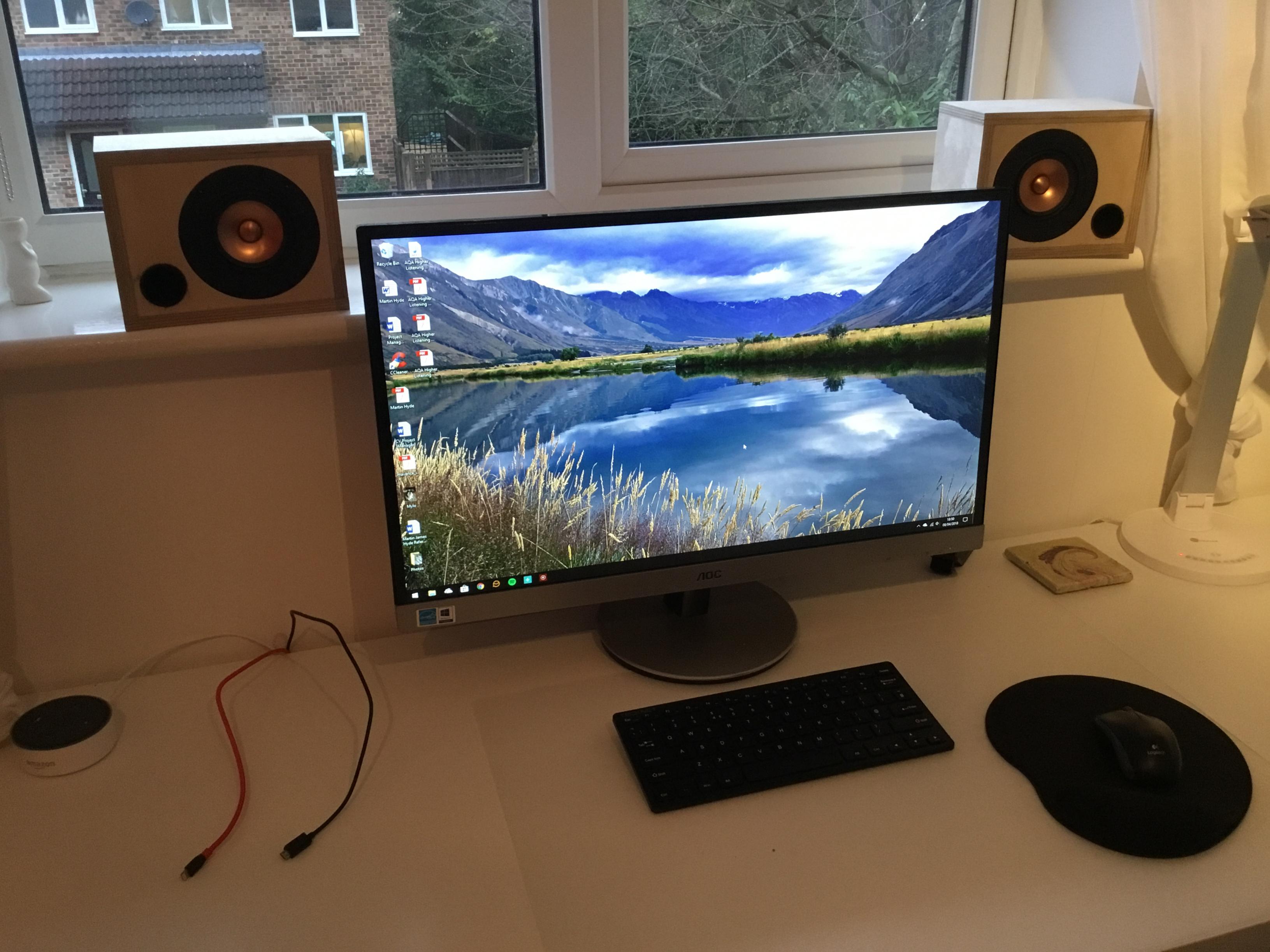

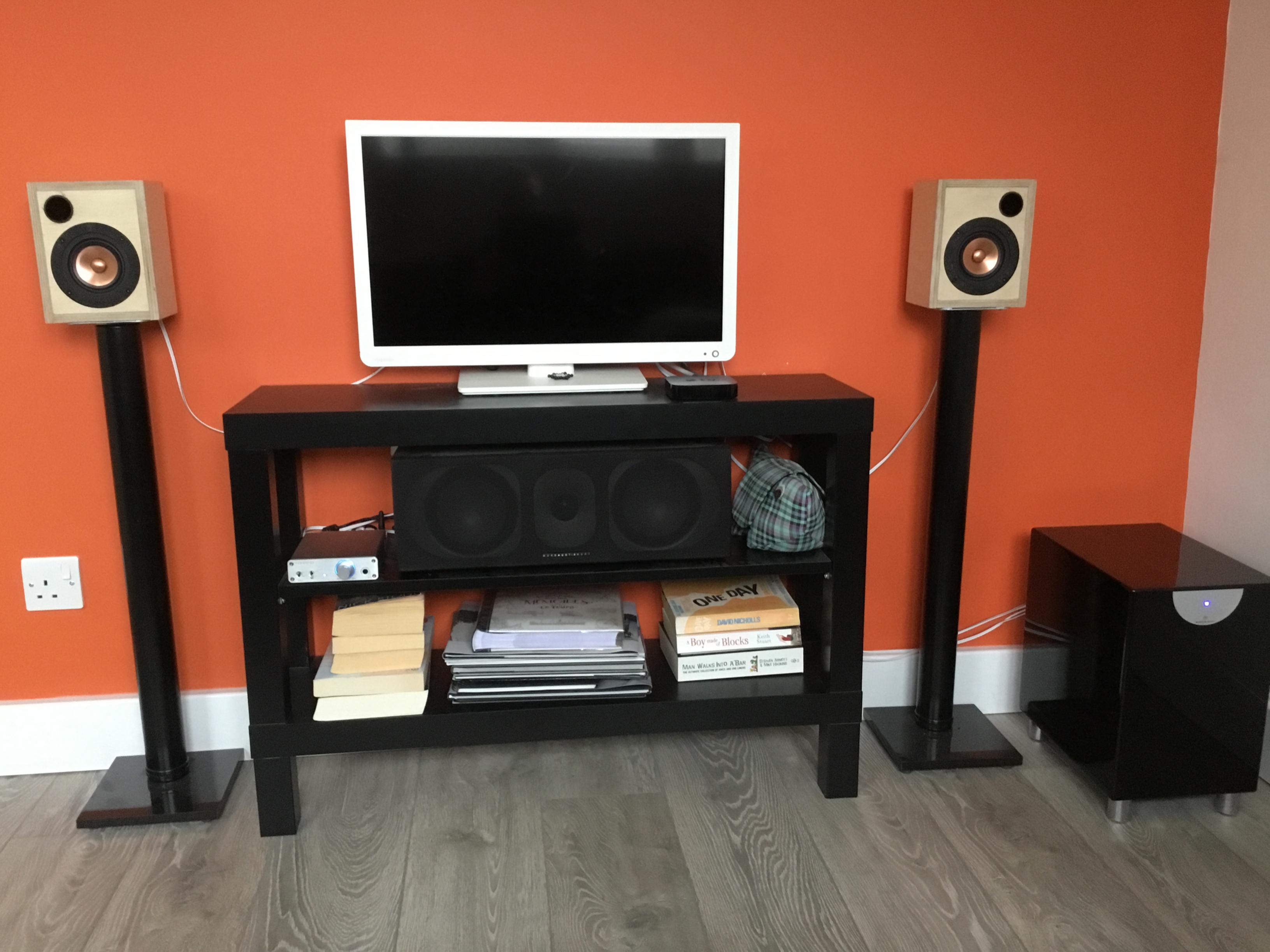

Here’s my pair of NanoReflex6m speakers that I built using the free plan.
I’ve got them set up in my small listening room upstairs and they sound pretty good - they need a lot of help from my Monitor Audio sub though.
I think they look pretty good as well, in a diy sort of way :)
Martin

Is that my nanoReflex design? How does it sound? It was a bit of a flyer. In this small a box bass will be limited, and as Chris points out the whole family of small boxes officially for near-field use, but i do love to blow people away by playing them for visitors in the big system (with carefully selected materials).
dave
I don’t think the Nanos where ever intended for other than a nearfield /desk-top type of application (i.e. less than 1 meter distance) , so the lack of weight/impact in the bottom when used as shown shouldn’t be a surprise, really.
Nice build.

They usually sit on my desk and are pretty good with some EQ applied. Could still do with a small sub under the desk though.
Martin

Sound-wise, with the right material, they sound excellent.
My main gripe is that the 6.2m has a shouty nature with certain material, which can make listening uncomfortable. The sub, when set with the XO at around 150hz makes a massive difference.
I am thinking of building a larger enclosure for these drivers either the ufonken or Lance TL, however this wont fix the forward nature of the driver, will it? I was also thinking of adding some mild BSC to put a downward slope on the treble.

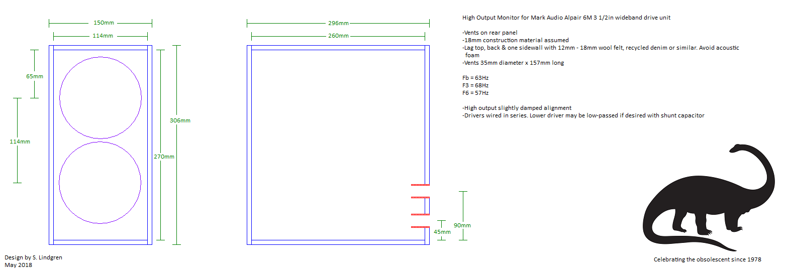

For want of another place to put it, another of the designs I dug out from an HDD I'm recycling. Twin driver Alpair 6M standmount. Drivers series wired; if you want to low-pass the lower unit, shunt it with a 56uF cap & adjust as desired from there. Not a lot else to say really, other than this should be quite a nice little speaker.
If you need to adjust the vent dimensions, the pdf Dave put together including the basic formulas (non-flared ducts) is also attached.
