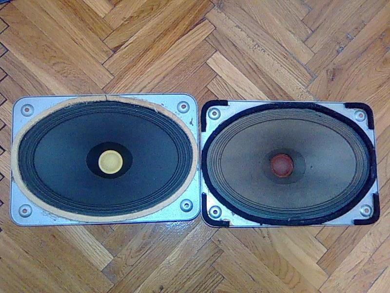

Meanwhile, i obtained several old oval alnicos...
First three pictures that ZM posted presents Tesla ARE668 which are in perfect condition, but they sound quite dreky to my taste.
Those with yellow dust cap are "Telekomunikacija Ljubljana", and they are few db's more sensitive than Tesla's. They sound much better but still i got listening fatigue during longer sessions.
My current setup consist of "same" loudspeaker, but with removed dust cap and phase plug installed. I said "same" ,because it has same basket, same cone, same magnet, but they came from a different manufacturer.(check the picture)
As u can see, left one has much better preserved cone so i didn't want to install phase plug because i had these old ones to experiment.
So, i now have 3 pairs of old alnicos, Teslas ,T-LJ, and Ei. Ei's are those with removed red dust cap and with phase plug.
They sound absolutely great with phase plug.
Sound is maybe just little thin(and that is maybe not their fault) but it has huge sound stage presented with best effortless dynamics that i have ever heard.

After one week living with thees loudspeaker's, i finally got Monacor's so i compared them in just the same conditions with one Alpha 15". Now, i know that is not ideal setup and they couldn't "shine" with such crossover, but it did gave me enough to hear what are they capable of.
One thing is sure-that monacor are great speakers. But i think they have less dynamics&staging than alnicos, but they have amazing disappearing ability!
For now, my setup is consist of Ei oval alnico with phase plug running FR ,Alpha 15" crossed with 6.7mH and 30uF , and backfire tweeter Selenium st324 just capped with 330nF.
