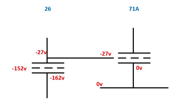

I have good quality coupling caps ready to use, if that's a better option. Mundorf Silver/Gold 0.22uF and 0.47uF. I was trying to eliminate the caps by DC coupling, but as DF96 says if I'm just swapping one problem for a bigger one then maybe it's not the way to go. The amp will have a separate negative bias PSU and the 26 and 45 will have fixed bias, so it's ZERO trouble to make the 71A fixed bias too.
I figure I should just try both and decide which I like best.

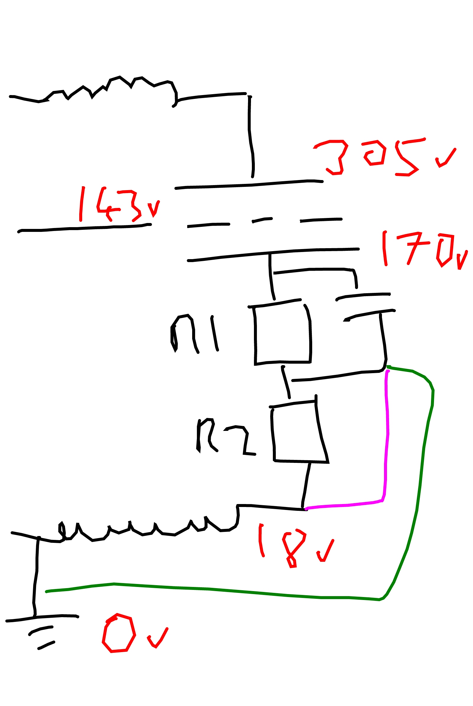

My question still stands though. IF I go with DC coupling, should the cathode bypass cap bypass ONLY R2 in my example, or should it go to ground (0v) ?
"Ground" gets a little complex in my schematic (and I apologise for not having a schematic yet, but work went a little crazy last few days). I don't have any CCS in my circuit, it's pure tube rectifiers, chokes, caps, tubes and resistors. Oh and transformers (Tribute). The chokes are going to be Lundahl - I haven't used them before but plan to use them in CMR mode, so 1coil in the top rail and 1 coil in the "ground" return. So for example the LL1672-20H will provide the initial shared LC, with the power from there going to the 3 valve PSU rails via a further LC for each. I plan to use the LL1667-25 for the 26 and 71A. With around 16mA through the 71A, the 1k2 coil in the ground return will raise the 71A ground roughly 19V above the common ground return point which is itself 2V above earth reference ground. Matching the 71A cathode with the bias from the 26 to get the right bias needs a fair bit of thinking through, but I think I have it about right now. The cathode bypass cap under the 71A could go to;
a) junction of R1/R2 - so only bypassing the final 27V of the cathode voltage
b) local 71A ground, ie before the 1k2 return coil of the LL1667-25
c) 0v earth reference
I initially figured it should go to 71A local ground, but the 1k2 coil forms part of the resistance which is raising the 71A cathode so if I don't bypass it the varying current in the 71A will vary the cathode voltage. So I THINK that bypass cap should go to 0v.
Again - I can just try them, but looking for advice and to improve my understanding.

OK VERY rough sketch attached, purely to illustrate what I (probably wrongly) have in my head.
So R1 is "the normal cathode resistor", setting the bias. R2 lifts the starting point for R1.
Drawn this way purely to illustrate the question about where the bypass cathode should be grounded. I see 3 options, drawn in different colours;
- junction of R1/R2 - bypassing only the "normal cathode bias resistor"
- bottom of R2 - bypassing both resistors
- to 0v - also bypassing the choke coil in the ground return
