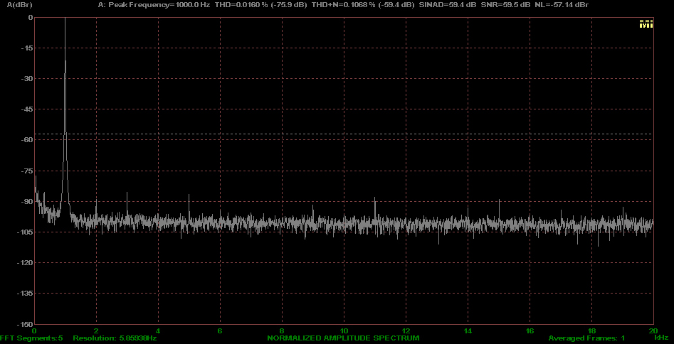

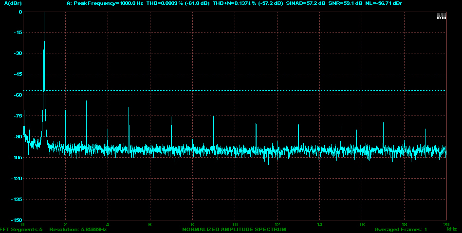

The following are 1W 8 Ohm FFT measurements of RA-100 (turquoise) and another amp made for studio use, Ashly SRA-120 (grey). RA-100 measures about the same as other PA amps while Ashly SRA-120 harmonics are much lower. Will this be audibly different? Since I haven't done a level matched double blind test, I can't comment on that but what I can speculate is that RA-100 may sound identical to many other amps as long as it's not driven to max.

Nonsense. I can distinguish subjective differences between low distortion amps in few minutes listening.
Yes, many people can do that in subjective evaluation. I've done that too. But subjective and objective comparisons are not the same thing. AES E-Library High-Resolution Subjective Testing Using a Double-Blind Comparator
