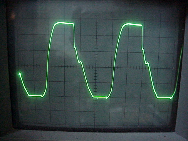

William,
First, when I talked about voltage I meant RMS on a true RMS DMM.
With 30V rails, 10kHz, I attain +/-40Vpp before clipping occurs. Bias is cranked up to 6.2A. When I make the amp clip, with or without load, I get the picture below. Note that I can't measure differential so this is only one half of the amp. DMM now reads 40V RMS. Indeed, this looks nasty but who would listen to this sound level without building a more powerful amp?
As for the dip in the PSU, wouldn't that show the rather poor PSRR of this type of amp?

Patrick,EUVL said:I think Hugo is measuring one output relative to ground ?
Patrick
I just spotted your post. Indeed, output to ground, as explained a few posts further.
/Hugo

did a few more measurements this morning.
1. Tried Patricks sollution with an extra 5k plus 47uF to make sure only dc gets to the input diffs sources. This made no difference except for some oscillation.
2. removed the McMillans. No difference except for a somewhat difficult dc behaviour.
3. Played a bit with my variac to set different voltages and different absolute dc offsets. Here the influence was clear. The higher the supply voltage, the higher the voltage where the distortion starts.
For 10kHz into 8R I got the following results:
Vsupply 21,5 DC 3.5 Vdist. 22.12
Vsupply 21,5 DC 1.4 Vdist. 23.5
Vsupply 21,5 DC 0.4 Vdist. 24.4
Vsupply 20.0 DC -0:1 Vdist. 23.4
Vsupply 22.2 DC -5.0 Vdist. 24.92
Vsupply 22.2 DC 0.1 Vdist, 25.5
With the last two measurements there was also slight clipping at the top of the sinus.
So after having tried most things I´m back to the theory that it has something to do with the current sources. I will try to put these values in an excel sheet and play a bit with the various voltages. MAybe I´ll find something.
Since it is really a theoretical problem (my speakers have an impedance of 3 Ohms at 10kHz) I will leave it as it is at the moment cause my amps are sounding really wonderfull with the new front end and the newly trimmed C9 and 10.
If anybody else hase some other ideas please feel free to post......
William

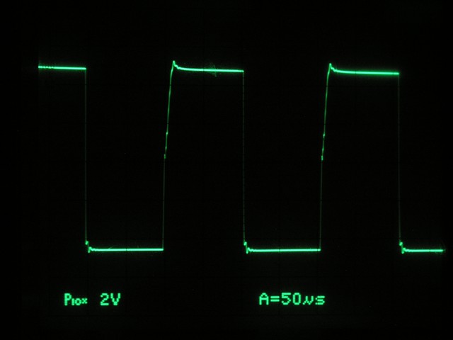

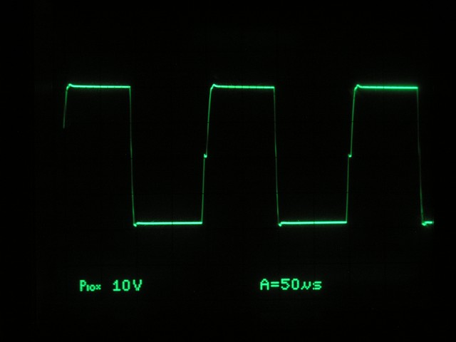

wuffwaff said:
could you explain why you think those 460pF caps would cause little dips at 22V output voltage?
The attached photo (10KHz, 8V pp) was taken from my Aleph5 some time ago when a 4700 pF was put across C-E of the BJT. I think it has bad effect.
And where do you want the other caps placed? Between output and lower IRFP240? So 6 per amp.
No, just 1 per group of lower IRFP240 between Output and in front of the gate resistors.
I´m using 470pF over the bjt and the square wave looks quite a bit better than the one in your mail. What´s the nasty thing in the upward sweep? That sort of looks like my dip.......
I´ve tried everything from 100pF up to 4700pF and the 470pF gave the best results regarding oscillations and square wave performance.
Next time I open up the amp I´ll try your suggestion.
William

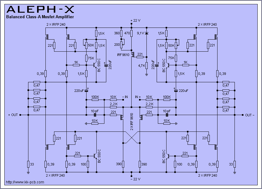

AlephX with J fet driver
Hi
I have these AlephX using the Kristijan PC boards .
Can I drive the AX with J fet .If yes can someone hepl me what do I have to change in the schematic so it make it better .
I attache the original schematic what these desing uses .
I have J fet 2SJ74BL/2SK170BL at least 50 pairs .Or if better to use 2SJ109BL/2SK264BL I can purchase that .
Can some one please help me please if is possibile to replace the Hexfet drivers wit J fet .
Thank for any help !!
Greetings
