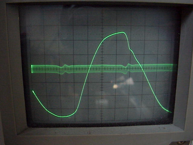

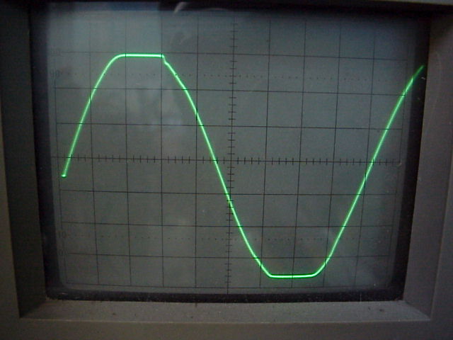

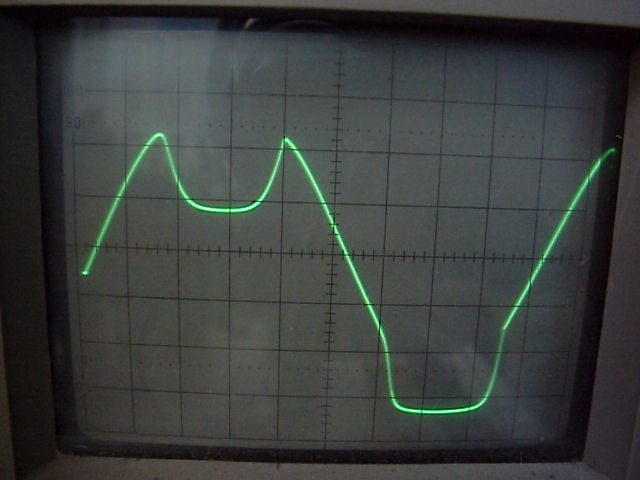

I used a variac and tried a few voltages between 20 and 30V.
I can’t reproduce the clipping like you showed in post #46 but noticed two things.
The first being a sagging of the waveform (at peak level) which is IMO due to current starving and a second being clipping (flat tops) which is just the sine wave bouncing at the rails.
In all cases this can be cured by either upping the bias and/or the voltage and the limit is determined by the heat sink capacity, long before the mosfets leave the SOA.
With lower rails, we have the luxury of more bias and I believe my amp hits the sweetest spot at about 24V, voltage and current wise.
The diff pair current source is build around a TL431 and when changing the rail voltage, I first trim both relative and absolute offset which surprisingly adjust very well together.
Then, I make the amp clip just a little bit and adjust the bias of both halves until I get a little flat line on both the upper and lower part of the sine wave. All measurements have been done with a dummy load.
All in all, I don’t think I presented something new.
First picture is what I call the current starving mode:
