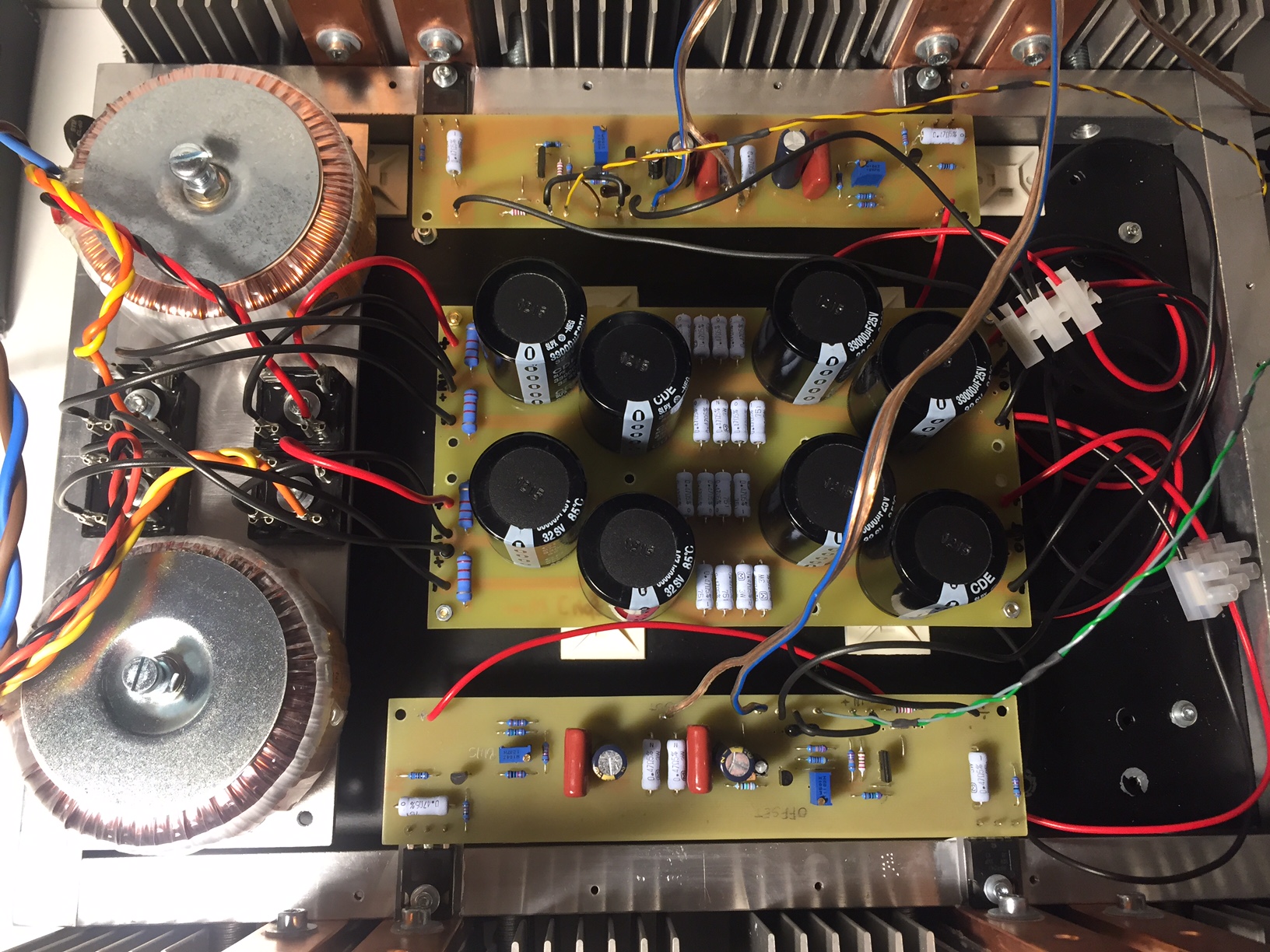

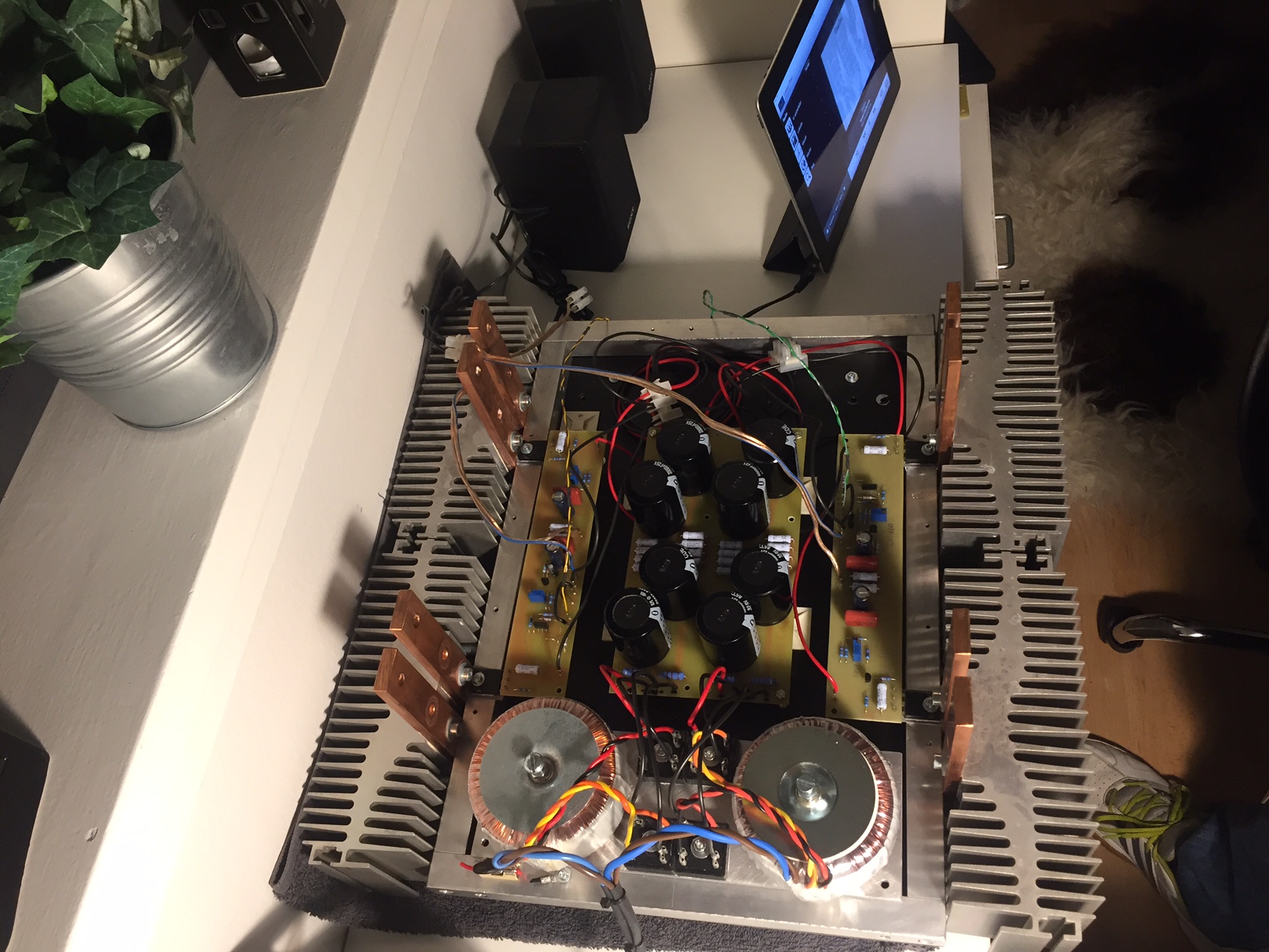

So far so good...
Did not add gate resistors yet, had to finish and tryout the Dual PSU
GND at output from PSU's are connected at terminal, and i expect connection to chassis from that point (maybee through CL60?)
Everythings seem's fine so far.
Jesper.

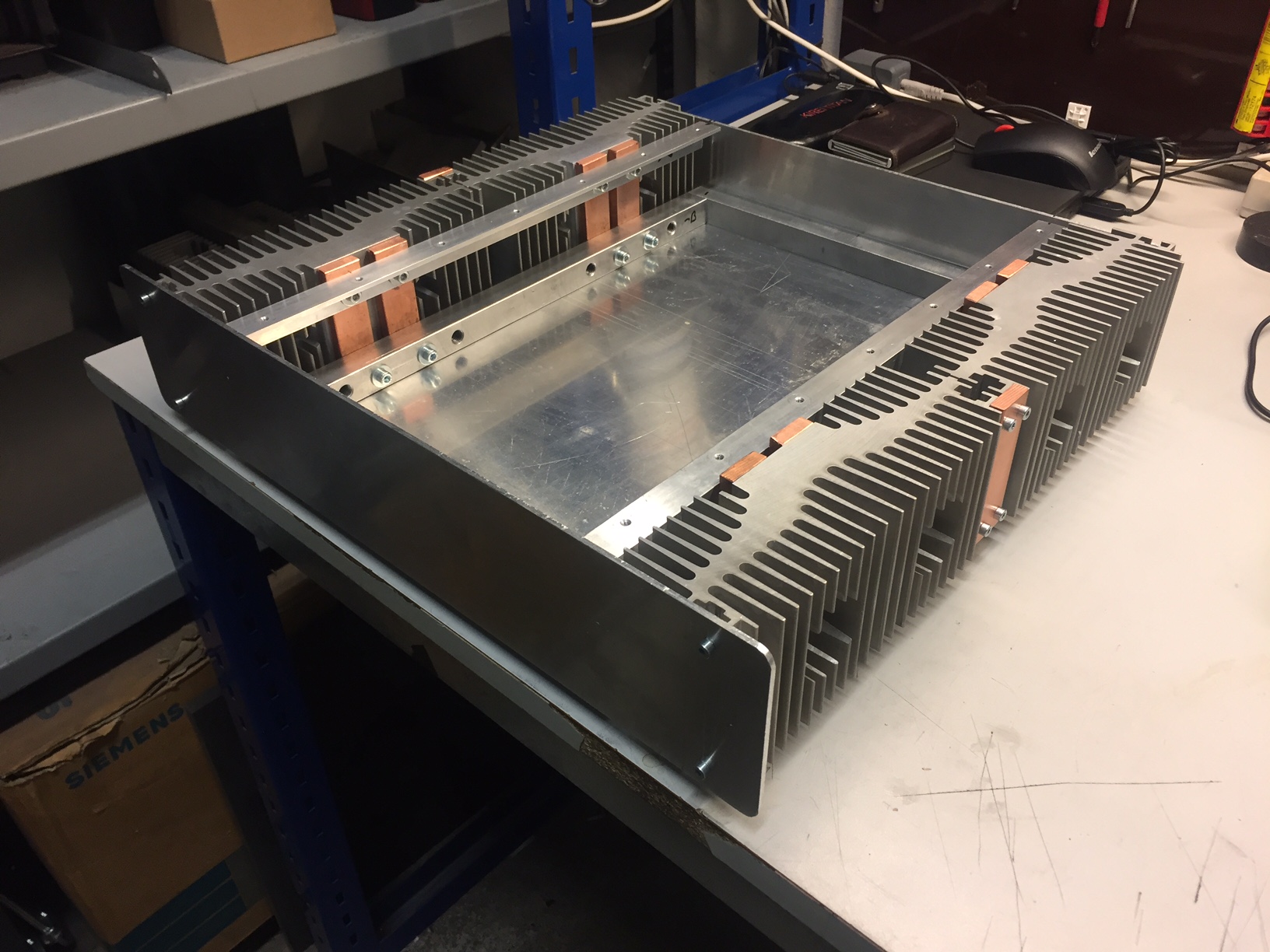

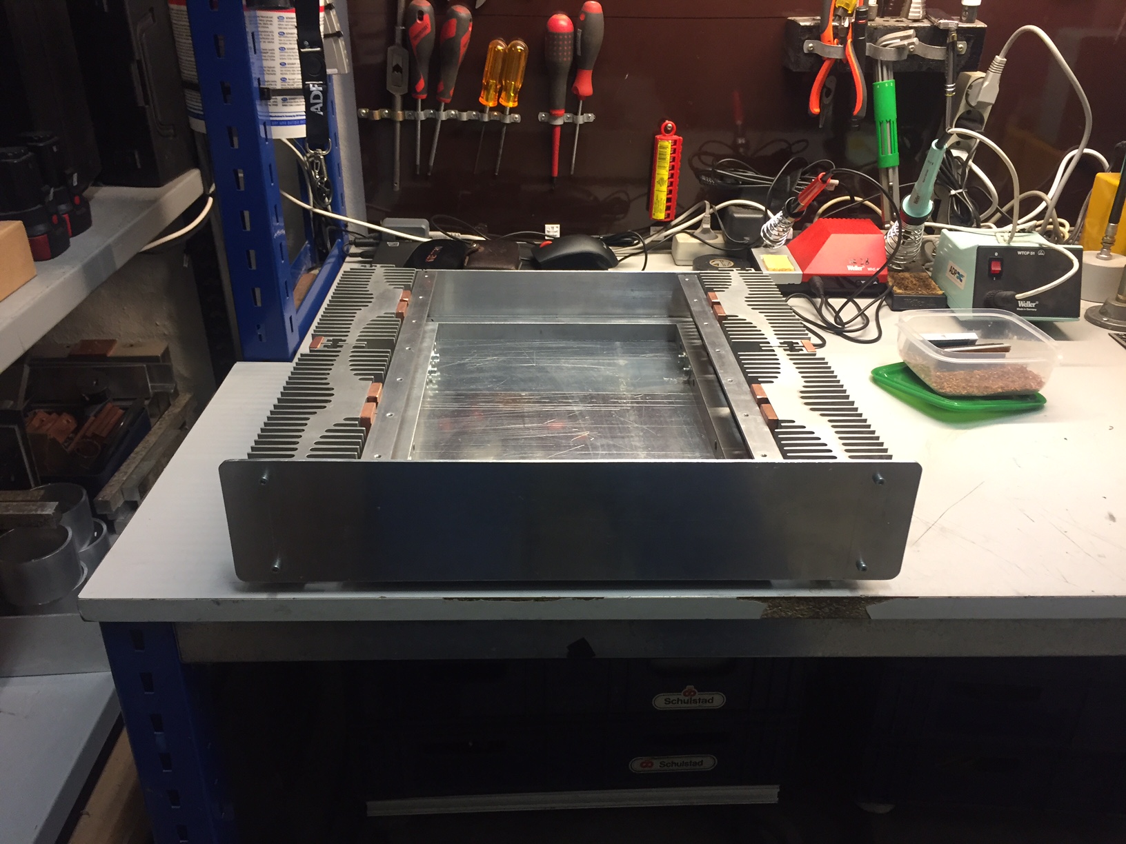

Slowly going to finish all Alu'/Cu' chassis
Hi here...
Hard work (but fun too)... AlephJ_Mimi! chassis is born
Faceplate will be black. Topcover will be made of wire-mess 3mm. plate.
I will make some special attachments to the IRFP's, so heat is transfered from both bottom of mosfet, but also from the top. This arrangement will be made from 20x20mm. Alu'.
Have a nice evening all.
Rgds; Jesper.

Nice metalwork
Thanks.

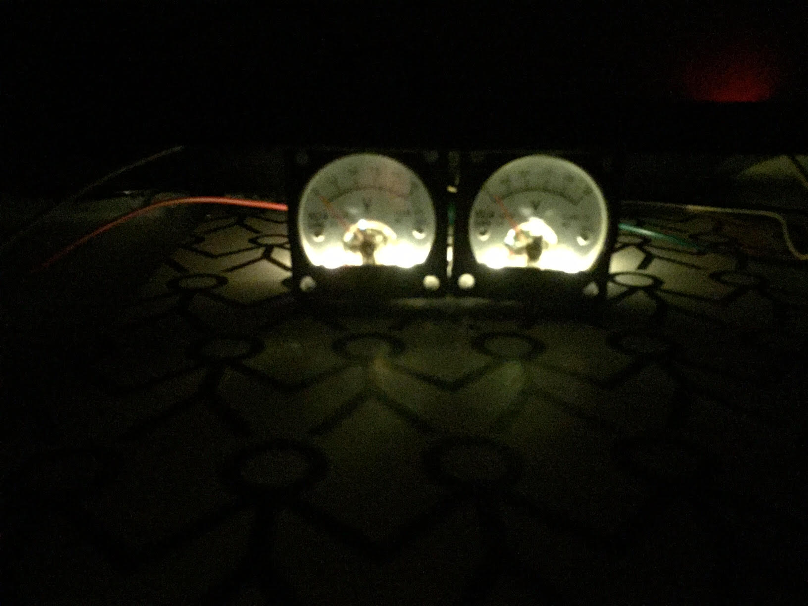

Iam thinking about adding some fancy vdc/mA/VU whatever meters on faceplate
Any suggestions ?

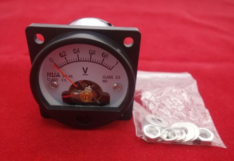

They also need some drive/calibration circuit if Vu. Better used for showing the bias because small sized and V scale. Do they have lights?
Hi Salas...

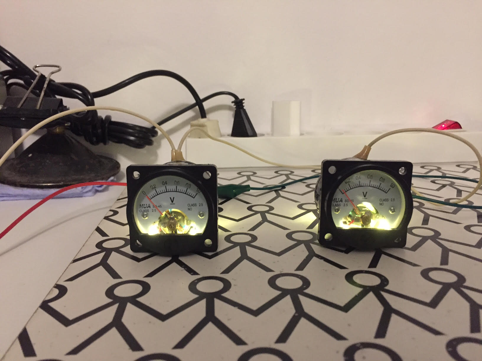

I will let them show bias, as bias in in range 0f ~0.4 - 0.5vdc, so it's perfect for that. But i just dont know if i kill them, when i start up the Aleph, as bias is peaking for a short time around 1-2vdc...
Maybe i will make some arrangement's, so that they are engaged after few seconds (like speaker protection)... Or maybe an resistor in series for damping the peak a little? -Let's see, when i got them, how sensitive they are?
Regarding the light's, i couldent find any with 0-1vdc scale including the backlight, but hey they must be hackable... dont you think soo?
Jesper.
Thanks both
There is something to play with, when they arrive (within 1 months or so)

Yes... i also found this, when i was surfing the ebay/alibaba and the 40 thieves
Anyway you need a driver of some sort for this VU i think, and i have bigger interesst in watching the bias; that's why i ended up with buying 0-1vdc scale one's.
I am sure i can figure out somehow to make light inside the panelmeters! I will for sure try...
Jesper.
