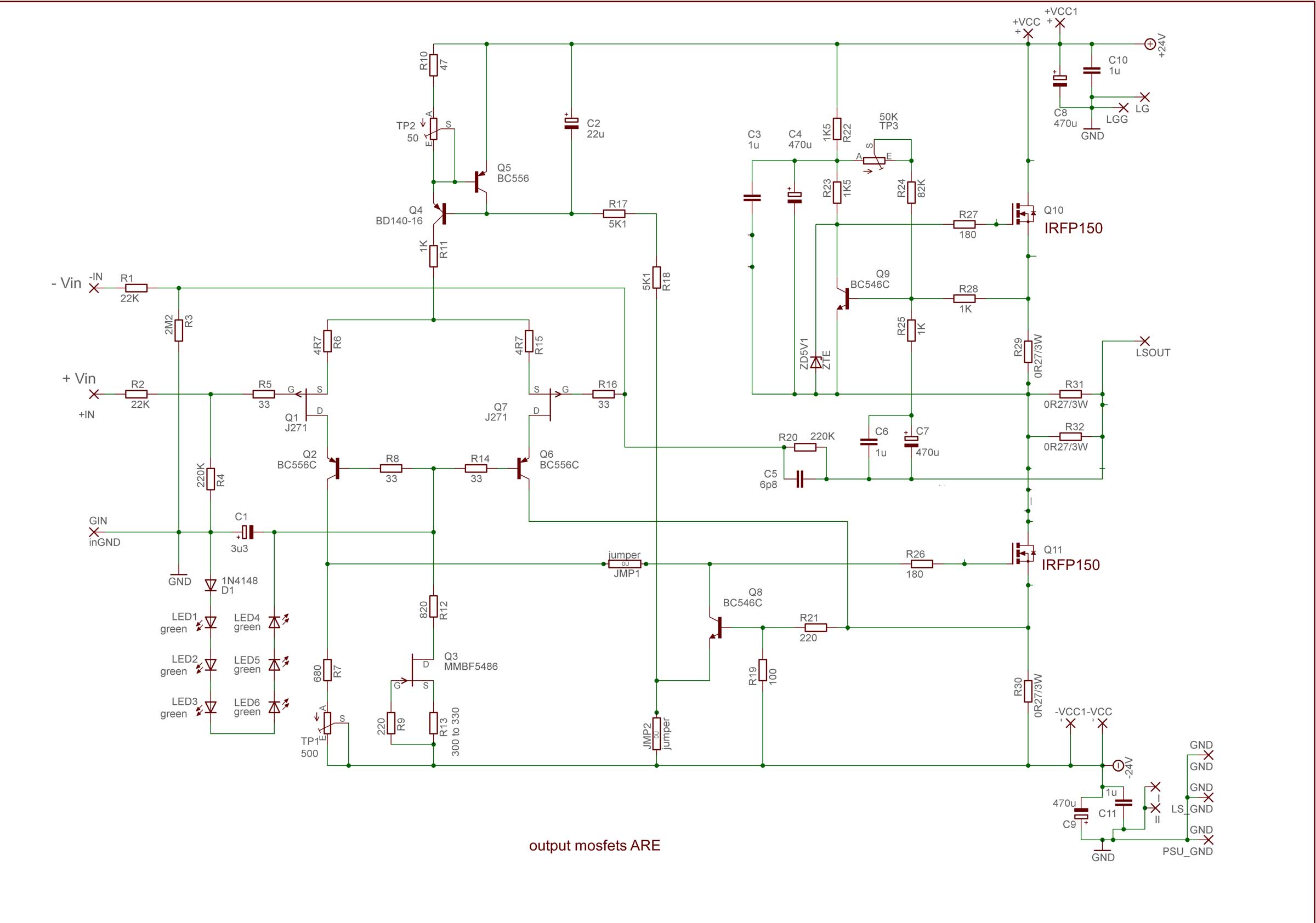

While rebuilding my poweramp (F5 at moment, F6 at desk)... i was feeling that it might be a way better idea to lower the power, and going for smaller heatsinks; also i would like a smaller chassis to be honest.
I think i can get along fine with ~15Watt with my current speakers/preamp. (Speakers 90dB, Preamp DCG3 with gain X 2).
The heatsinks i have now, can "easily" blow away 200W (F5, AlephJ etc.) for a stereo setup. If i split them, i will end up with half of that approx.
So an Mini Aleph, uses around 100W for a two channel setup, which would be fine. -But when i was surfing around i also read about a mini alephJ, and mini Babelfish, -soo this could be very interessting to build i think. -I just cant seem to find good information regarding those?, also the Mini aleph is difficult to find right information about. So i would be pleased if someone here has some schematic, links, whatever about such mini amp.'s :)
I prefer something like mini aleph, but maybee a newer version with jfet's.
Also the babelfish mini i am very currius about!

Thanks.. all!
So this schm. Babelfish it's possible to run this at lower rail's?
Jesper.

as said zillion times , for any mosfet based output stage - do not use lower PSU rails than +/-15V , or you're having trouble due to increased nonlinearity of inherent mosfet capacitances
then use whatever Iq you want , but I wouldn't go lower than 1A
yes , this schmtc can be used for Mini , in which case you can skip cascodes for input JFets ...... or leave them , but with necessary change in voltage biasing
few other resistor values need to be optimized , strictly for rails and Iq one intend to use .....

Also what's written, due to cascoding rail can be lower.
Anyway, if used with 2 pcs. irfp240's running with normal Pass rails :D (2x23vdc).. how much dissapation must i expect?

due to cascoding , rail voltage can be higher
that was at least one reason why cascoding at all
dissipation , P=U x I
I found this.
Maybee with 17v rails it could be good?
Looks interessting i think!
Jesper.
sch is incomplete (missing values)
as I said - take any Aleph schematic , change few resistor values (decrease Iq and rails accommodation) and that's it
Yep; I kindoff understand this, but if we compare the attachment i posted before i see that there is only two mosfets, instead of four which exsist in original AlephJ sch. (attached here)
So i throught (also what i read) that an "mini" Aleph, is both lower voltage rail,s and less output devices?
Am i right ?
Jesper.

pretty simple and effective logic was used in making entire Aleph series - starting from lower rails and dissipation , going to higher rails and dissipation , resulting in broad span of power figures
taking in account that there is sane limit for dissipation per mosfet , it's logical to multiply pairs as needed for particular amp
anyway , as i remember , idea for Mini Aleph came from aspirations to make one in smaller form factor , same as to find use of some leftover parts (smaller heatsinks , smaller xformer)
later , term Mini is stretched to absurd - I remember seeing amps in same dissipation range as Aleph 3 (30) , called Mini
so , make up your mind , decide what you need ...... and ask exact question
this is post #16 , and we just tackled meaning of amp's name :clown:

I wrote in first post 100w dissipations for stereo.
