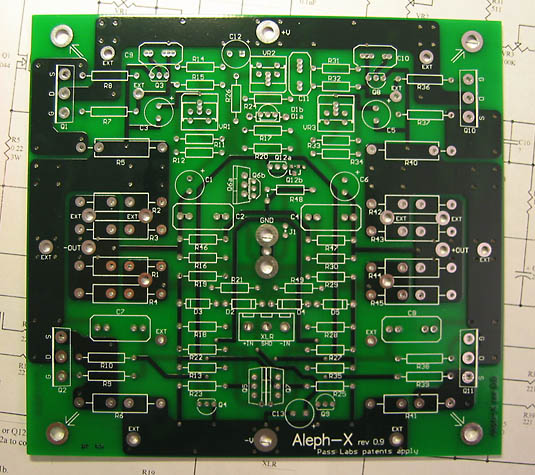

Final board layout isn't fixed in stone yet. There are subtle differences from what's posted... it will support multiple devices (off-board), and has potentiometer fooprints like below. Send me an email pronto if you'd like to get in on the Beta order before it goes out!

Here are the final versions of the Beta schematics, bill of materials, and board layout preview generated from the gerber files.
rev0.9 schematic
rev0.9 layout snapshot

You'll notice that I've provided a number of pads labelled "EXT" on the board. These are there to allow connection of off-board power transistor pairs. I'll provide a proper schematic at some point, but for now, please refer to the Aleph 60 service manual for a diagram showing how multiple output transistors should be connected. Note that the current sense connections only go to one transistor pair on each side of the Aleph-X. These connections must be taken from either the empty pad where Q1/2/10/11 would be installed, or the on-board power transistors should be installed in addition to the external transistors.
Beta testers: I'd appreciate feedback on this feature, and what you think could be done to improve the layout etc, so if you use more than the standard 4 power transistors, please provide me with some notes of your experiences hooking up to the EXT connections.

"They will become extremly hard to solder from this side. Even if a PCB is through plated, I like to solder components direct to its traces."
Uh? I have no idea of what you mean by direct to its traces. In any event the traces for c3 and 5 are on both sides. For the remaining caps I don't remember. The traces and the thru holes are 2 oz of Cu plenty of material to make everyone happy.
Sorry not traces but tracks,
One rev0.9 layout snapshot posted by HifiZen I see only Red tracks (normally top layer) connecting this components. if there is a malfunction in one the through platings, you have to solder on the top layer side to get a connection, and this is very difficult on components with radial footprints like C3,5 and 13.
Claus
Claus
I still don't see your point, the beauty of two or more layers is that traces can run independently from top to bottom, if you require direct soldering to the traces then you limit yourself to single layer.
I am almost hoping for a manifacturing error like that. It would mean free boards. Unfortunately, that never happened to me and I doubt it will in this case.
