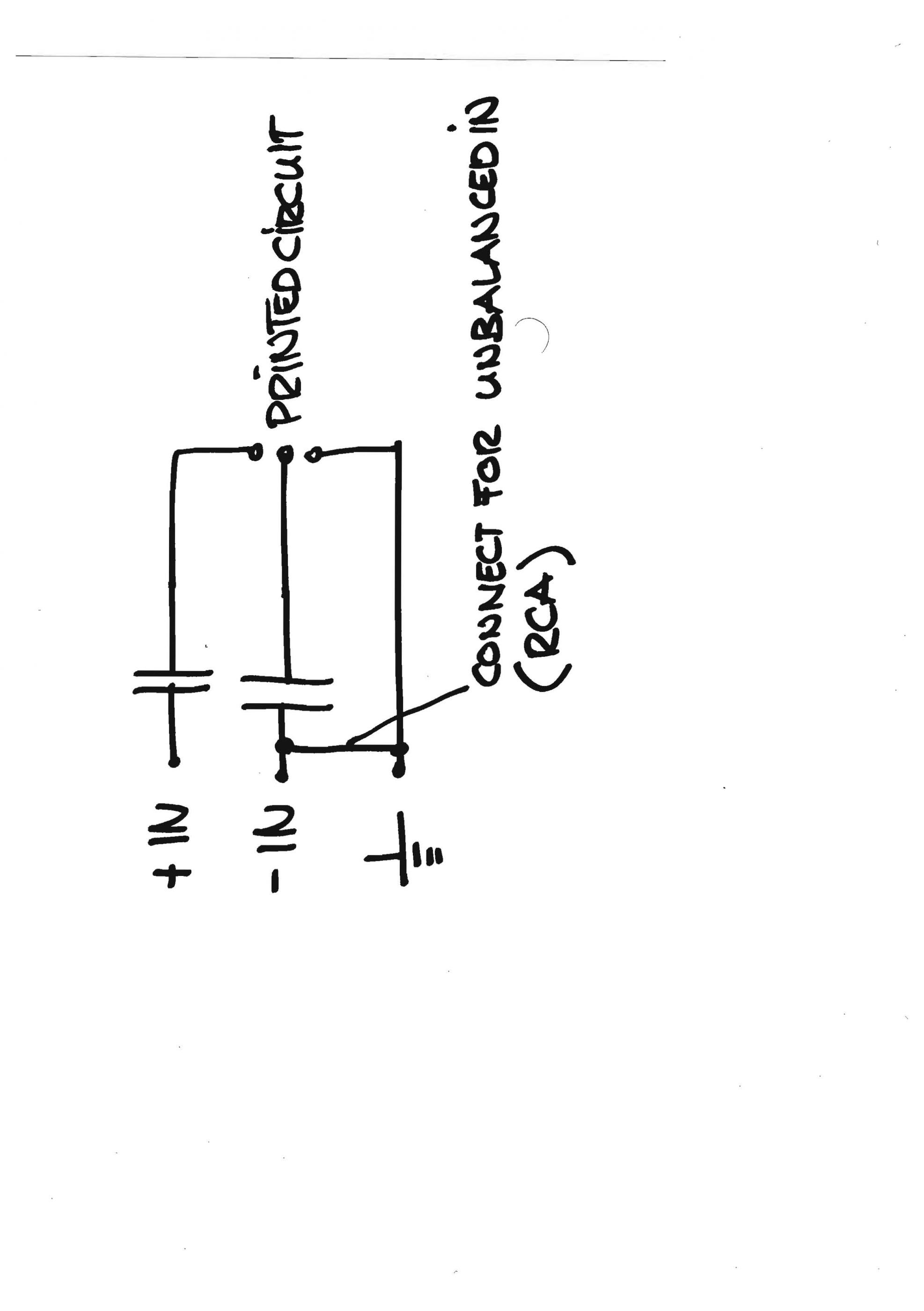

Hi Eric,
you can use XLR only when your function generator is balanced. Otherwise use RCA and connect -IN to ground via a coupling cap (the same as used in the +IN)
only two fets are needed wich should be closely matched. You can use a small pot (10R) as a pair of source resistors to make small adjustmants to the rel. dc offset.
First I would try to solve the problems you´ve got with the 9610´s in place. Listen for a year or two and then change to Jfet´s. This will have twice the fun ;-)
William

When I built my amp, I completely forgot about the coupling caps :eek: I have attached a drawing. Are the caps indicated correctly?
thanks!

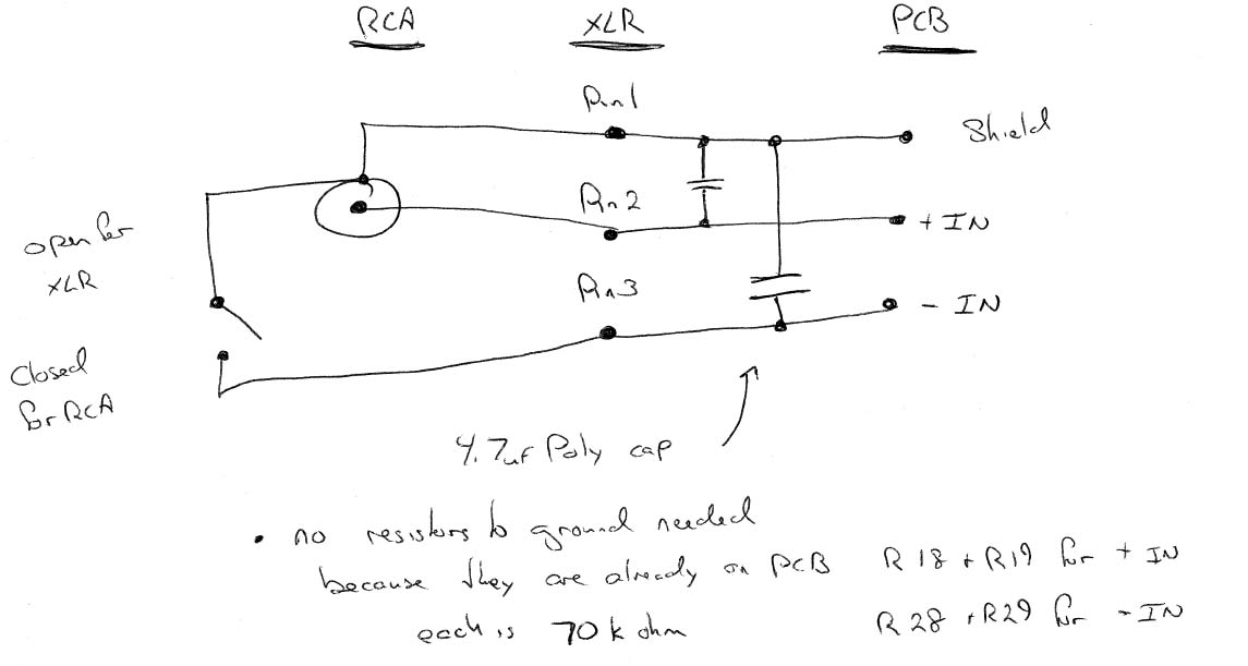

Ooops: forgot to add that the RCA terminal is electrically isolated from the metal chassis. The Shield/Ground input on the PCB is connected directly to power supply ground (zero voltage point at the caps), which then goes to AC mains ground through a CL-60 thermistor.
Yikes! :eek: :eek: Good thing I forgot about adding this in and its not in the circuit yet! This looks better to me and now I see how it actually blocks DC input from the processor.
Thanks for your patience with me, William! As with most of my projects, I get half way through them and think to myself "wow- this just got way more complicated than I originally thought it would be..." The good news is that I'm almost through with this one...

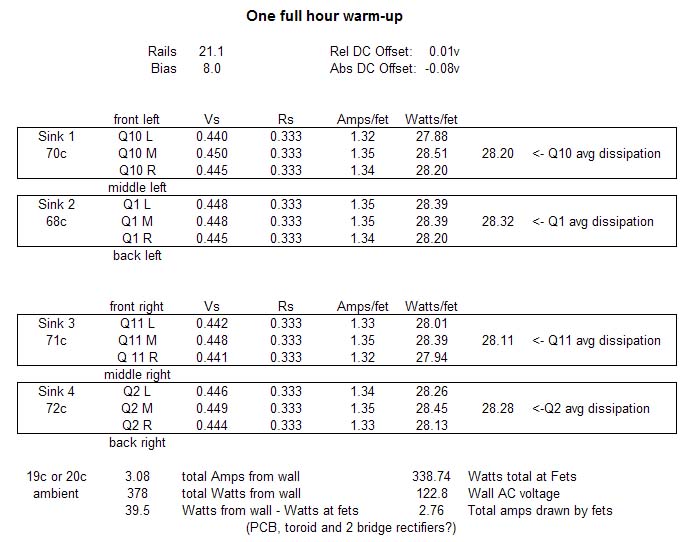

I'm still waiting to borrow a scope for use at home to do some additional analysis of the wave forms, so in the mean time I played around with offset and bias after letting things warm up for an hour. The only thing that I didn't think to check was bias through the front-end differential. I let the amp warm up for a full hour. Absolute DC offset started at 9.0v upon powerup, was at 3.9v by 5 mins, was at 1.86v by 30mins, and at 0.5v at 60mins. At this point, I readjusted bias to 8.0A and reset Absolute Offset to as close to zero as I could (-0.08v). I was then able to measure AC Current Gain at 49.7% on one side and 49.4% on the other side.
Overall, I am using 4 sinks and have 3 mosfets mounted to each sink (designated by L, C, and R in the image). I'm a little surprised that the power dissipated by the mosfets don't more closely match one another, although they are very close. I'm not going to change any of these settings until I can hook it to a scope again to look at the output waveforms. Music sounds nice, but again, I only have one working channel so its difficult to judge.
Heat sink temperatures may not be very precise - all I had was my non-contact infrared gun and I searched the sink for the highest temperature I could find. This ended up being just above the center fet on each sink. I was surprised to find a near 50c rise... Moving to bigger sinks clearly looks like a good idea!
All of my measurements are in the graphic below:
Overall, it looks like the transformer, the two bridge rectifiers, and the PCB are burning about 40w.

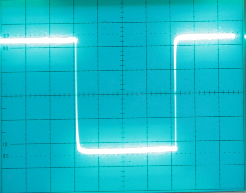

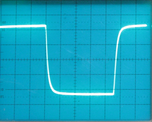

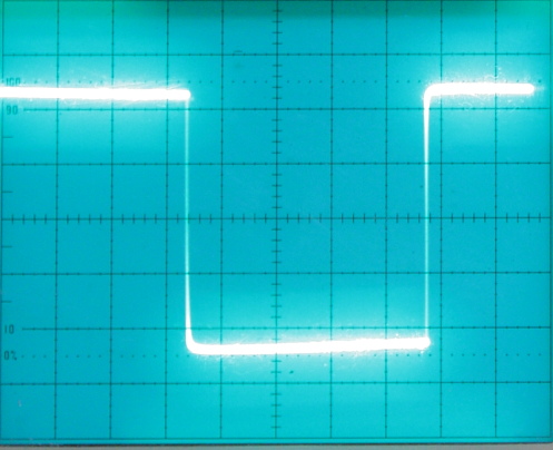

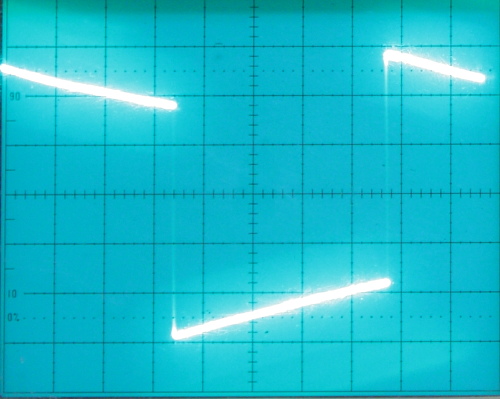

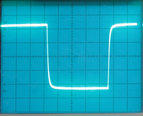

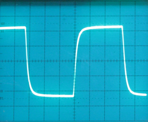

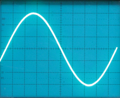

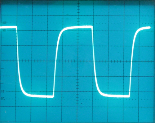

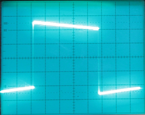

Its taken a while, but I was finally able to do another round of measurements. This time, I used both channels of a 2-channel scope with the scope set to sum. One channel was connected to Speaker Pos, the other channel was connected to Speaker Neg, and the ground leads from both channels were connected together at the PSU grounding point.
Bandwidth -3dB points (0dB point measured at 1kHz) occurred at 10Hz and close to 80kHz. Sine waves are beautiful and undistorted from about 7Hz up to over 200kHz (I didn't measure beyond this point). Here is a 10kHz wave: 10kHz sine IMG_9042.JPG
Square waves are much cleaner than what I posted previously. These were measured into a 4ohm load at 10v RMS (14v p-p). The amp is running at about 8A bias point on 21v rails.
50Hz Square wave below:

Square waves were measured into a 4 ohm load at 10vRMS (about 14v peak-to-peak) output level. Although the square waves look a little funny below about 100Hz and then again above 10kHz, they look noticeably cleaner than those from my Marantz MA500 amps and the bandwidth is wider, too.
I also looked a clipping behavior, which was really very nice. The sine waves were very clean and when clipping set in they just flattened out on the top and bottom - no funny ripples or dips in the curves this time. I am much more pleased with this set of measurements. I think the major problem with my last set of curves that I posted was my measurement method - I just connected the + and - from a single probe across the output resistor which effectively grounded the output of half of the amp.
Is it critical that bandwidth extend higher than the 80kHz I have measured? If so, what can be done to extend it?
Does anything need to be done with the square wave performance (especially looking at 15kHz and 20kHz), or is this a good reference point?
