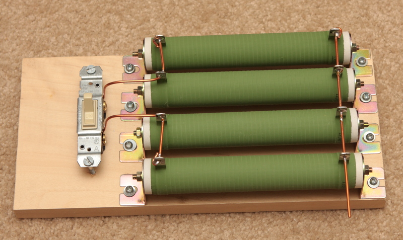

How's this for a dummy load? Just picked these up from MPJA.com a few weeks ago. The board that they are attached to measures approx 6x12 inches
Four 16ohm 125w resistors in parallel. Two at a time (switch open) provides an 8ohm load capable of dissipating 250w. Close the switch and now there are four in parallel that provides a 4ohm load capable of dissipating almost 500w.
For an input signal, I'll use a CD that I have with test tones as specific frequencies and just put that track on repeat while I work. I presume the input signal should be nearly "full line-level" rather than something that comes out of preamp-style volume control that is a low signal (like -30dB or so)...
I'm ready
I'm ready
Nice find Eric. Those resistors I think you're gonna appreciate in the future.
As for the test signal, you will need a way of measuring the output of the CD player. Do you have a true RMS meter?
If yes, you can measure the AC voltage at some 100 to 500Hz with the meter.

I think I have successfully measured and adjusted the AC current gain for the amp. I used my CD player's line level output on the back and just ran this straight into the amp with a 60Hz sine wave that I have on a test disk from when I built my subwoofer. I connected my dummy load and set it to 4 ohms and started my measurements
Using WuffWaff's choice of 1k3 for R13 (I largely just copied his design), I measured AC voltage across the source resistor on one of the paralleled mosfets and the AC voltage across the output resistor. Using the calculations I found in the Wiki and other threads here, I calculated AC current gain at just shy of 50%. Since I am looking to optimize the amp for a 4-ohm load, my target (using the AXE1-2 spreadsheet) is 60%.
I first tried replacing the 1k3 resistor with 1k2, but this took me in the wrong direction and reduced AC current gain to 46.5%. I then put the 1k3 in series with a 221ohm resistor which yielded 57% AC current gain. The last stop for the night was putting the 1k3 in series with a 332ohm resistor - the result was 60% AC current gain, right on target.
The strange part is that my dummy load resistors never really got hot. They were clearly warm to the touch, but I could comfortably grasp them without any trouble. Based on what others here have said, I expected them to get hot enough to burn my fingers...
