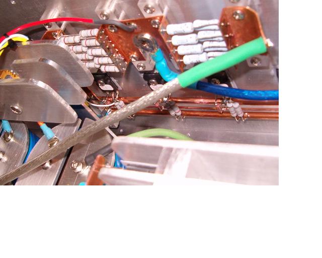

Off Board Sense Resistor
Kilowatski,
I mounted the sense and ground resistors to the heatskink using a copper bussbar. This worked quite well and allowwed me to use many resistors in parallel. These resistor really don't get that hot so where you mount them isn't critical as long as it get some air.
