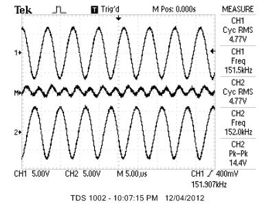

Hi All, I'm finally at the end of the line. I built some Aleph-X amps a while ago and have been battling getting them going for months. The main problem was stability and for a while an inability to bias the amp. Finally put bias problems down to a dead C5 cap. Anyway I'm now 90% there and I'm out of ideas battling my instability issues.
Basically my amp most closely resembles Eric's running about 8A a side with +/-20V rails. The basics of the amp work, as in nothing is bursting into flame and a small input signal is amplified, power supplies are stable, it's drawing the correct current, and I have 11mA going down the input pair.
The problem I am having is oscillations and absolute DC offset, and the two are related. Here's what I've seen so far:
- I power up my amp with V2 set to zero and the amp oscillates at a messy 180kHz + 230kHz. Changing V2 does nothing to the stability. Absolute DC Offset starts at around -2VDC and heads south to around -11VDC.
- I added a 1n C9 and C10 and now when I turn on I get reasonably clean looking oscillation at 150kHz at each channel. However after the amp heats up and the Absolute DC Offset gets below -7.5VDC the oscillations appear again.
- I upped C9 / C10 to 3n3 and now I can get the offset down to -3VDC with lots of tweaking of V2 before the oscillations appear again. Of note is that the amp seems to start up with a higher Absolute Offset now, so from cold start it still seems to take 1+ minute to stabilise.
And now I'm here with the perplexing question. Am I destined to just battle the oscillation by upping C9/10 until the amp has an unhealthily anorexic bandwidth? Or can someone hint at what I'm doing wrong? Schematic and scope capture of bandwidth attached.

After checking the differential pair (measure approx 4v across R23 and R25) as Zen points out, my next thought is that you don't have DC offset (V2) adjusted properly. You say that oscillations begin when DC offset hits -7.5v. Try adjusting V2 so that offset starts high (more like positive 7-10v). As the amps warms up over 30-45 mins, it offset should drift toward zero. Keep adjusting until absolute offset stays at zero when the amp is warm. This should cause high offset when the amp is cold. It sounds like you don't have any oscillation problems when offset stays closer to zero volts...
normally you should set the absolute DC offset when warm. Cold offset is what it is and depends on the used zener and McMillan resistors. In my Aleph-X it starts up at around +8V.
C9/10 are around 3n3 or 4n7 in my amp (there must be a thread where everything is written down)
Did you use wirewounds as source resistors?

Definitely adjust the DC offset to zero after warm up, as William says.
Another way to tame oscillations is to increase the gate stopper resistors on the output MOSFETs. This will help to limit the bandwidth.
Your output gain stage with IRFP044 has about twice the transconductance of an output stage with IRFP240 with a similar number of FETs. My guess is this the cause of the oscillation. Larger source resistors could help. That's just a guess; someone else should weigh in on this point.
Looking at your schematic, it isn't clear how you wired the parallel sets of output transistors. For example, R8 should only connect to the source of Q1 (and not Q3/Q5/Q7). Similarly, R10 should only connect to Q2 (not Q4/Q6/Q8). You probably wired the output stage correctly, but if not, this certainly could cause instability.

Wow I'm amazed at the quick responses.
Zen, pictures coming soon, no camera here at the moment. And yes 11mA through each of the input stage. Measured 22.1mA out of the front end source.
Eric, oscillations start as my amp APPROACHES zero volts absolute offset. At -7VDC it becomes stable.
Wuffwaff, I've got 2x 1ohm low inductance wirewound resistors on each source. No input caps installed currently, but I did try with them, and connected to a preamp with output caps, and currently inputs shorted to ground with no change in offset or response. Interesting that you needed 4n7 caps to get your amp stable? Maybe I'm overreacting given how I've read most people haven't needed them and it's just a feature of my choice of parts.
kropf, sorry I mocked up that schematic to keep track of the parts I'm playing with. The amp is wired up as per Blitz's 100w schematic except with 8x IRFP044 a side rather than 6. Sense line is only connected to the first MOSFET in each group. Do I understand your post correctly that the increase in number of MOSFETs also contributes to potential instability as does the choice of IRFP044 over the 244? So maybe with my choice of parts I just need to reduce the bandwidth with caps and all is good then? Times like these I wish that my analogue design lecturer spoke fluent english .
I've actually gone brute force and added 4n7 to C9/C10, and 1n5 to the caps on Q4 and Q9 collectors to the output. That has stabilised the amp. I was under the impression that this is a bandaid for a mistake I made, but the more I read the more I think my amp just needs it for stability, and that the values aren't so uncommon. Certainly the additional caps are in the Aleph30 schematic. Is there any major sonic issue with setting the amp up with these caps?
Anyway with the thing stable I twiddled V2 and now have my offset issues sorted as well.
