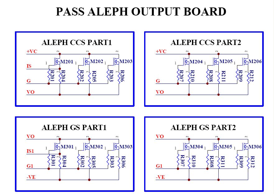

Hello follow diyers.
Just wondering if someone have boards to sell?? I bought the aleph-x from jims audio and now that I'm aware the copyright issues I'm a little embarresed, but the board are almost done with expensive parts.....
anyone know if the parts will fit the original boards?
ps. did donate to make my mind at ease .
thanks.

schema:
