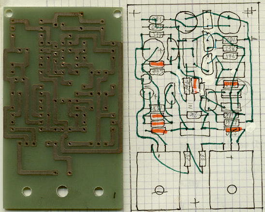

Here is a best I can do for now. The layout and artwork. Components side is mirror view (it means you see traces). I placed 7k5 resistor in parallel with 5k trimer in place of R4 at the collector of Q1. This allows for DC offset adjustment and it's pretty stable.
The real artwork is probably on my old computer which my wife took to the office, so it's hard to say when I will be able to get it ( at my convenience).
I used dry transfer method for that board, so it is not too perfect.
