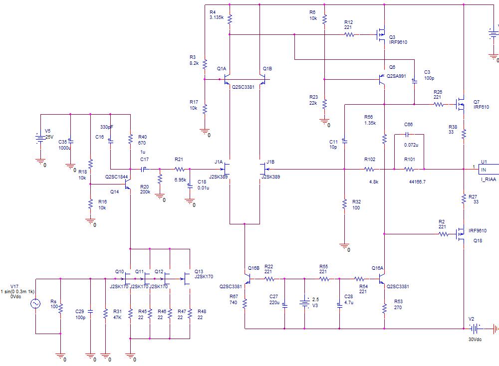

P.S. i would also like to split the RIAA in two as Analog suggested 75uS constant with a LP at the input of the MM and the other two constants active at the negative feedback network loop

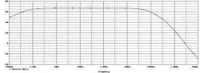

Ok i am done with the design of the RIIA.
The network is splitted 75uS in front as passive config and the other two as active.
I will attach the frequency response.
Spice show a very stable behaviour in frequency.
I will have to build the circuit to see if it is really stable or not.
Please any advice and tips are very welcome.

Riaa looks very good. I hope you want mind a volt or two at output now and then. Or most of the time. You seem to ignore my post about the three choices but this won't cure the dc behaviour. A more sensible approach would be to discuss which of the three is least detrimental for sound.

Stefanoo said:
Since the resistors i am going to use are Naked S102 and are expensive i will have to verify if ALL the gate stop resistors are REALLY required.
Stefano,
I think you are moving in the right direction. I am not a fan of using servos. I think it's very hard to design them in a way that doesn't color the sound of the original circuit. The standard technique of using an op amp for the servo has this problem. The use of a DC blocking capacitor on the output is less objectionable than using a servo. Personally, I found the use of the 2 x 220uf a better choice than using an output capacitor but that is a personal preference. It would be interesting for you to experiment and see which one you prefer.
Regarding the expensive resistors, you don't need these everywhere. Many locations will be fine with standard good quality metal film resistors. For me, the critical location was the RIAA network and rather than use expensive resistors like the Vishays, I used good sounding surface mount Ta resistors. I like to think of these as a poor man's naked resistors since the case and endcaps are already removed. You just need good eyes and a steady hand and you can solder these into your network and get very good results.
---Gary

analog_sa said:
If you short the elecrolytics there will be a significant temperature dependent offset at output. A coupling cap will certainly block it but it will still eat from the available headroom. It may become a real problem with age .
You are right, there is some big miscommunication going on here :)
lets line up a little bit:
When i talk about the 2 X 220uF i am referring to the 2X 220uF on the RIAA (C1 and C41 original schematic)
On the schematic I have posted, as it's shown, I only use a coupling cap between MC and MM stage.
RIAA is split in two as you suggested.
This way i achieve a 0.001db theorical error till th amp doesn't start to fall off.
When you mentioned the DC stability issue, I am assuming you were referring to the 2 X 220uF C1 and C41 in the RIAA, right?
When you said: "If you short these two caps" you meant to say if you pull them off the circuit, right?
That is why I have said, if you pull these tow caps (C1/41) off the circuit and thus short the 100ohm (R21) resistor to ground, you will get a very bad RIAA equalization as those two capacitors also contribute to form the other 2 time constants.
You mentioned that without these two caps (like the circuit I have posted) it won't be possible to trim the output DC through the simple resistor anymore, since the DC output would be fluctuating due to temperature variation.
So i have included on the circuit an output coupling capacitor that will fix the DC at the output.
Nevertheless i understood you mentioned as quoted that the output coupling cap will be stressed and maybe become faulty.
Please let me know if i am still misunderstanding something here.
They don't contribute anything to riaa. As far as riaa is concerned they are a short circuit.
Joined 2002
If you want to get creative then you could turn this network into part of the RIAA. If you keep the 100ohm resistor and change the capacitor to an inductor then you could use this as part of the RIAA network but still have DC stability.
A quick calculation shows that the 50hz time constant needs a 318mh inductor and the 2110hz time constant needs a 7.32mh inductor. Either one of these would be possible and might make an interesting alternative to using capacitors. Putting a resistor in parallel with the inductor gives you one more knob to play with
---Gary
Hi Gary. Sorry, bit i don't understand how the inductor would help dc stability. At dc it is pretty close to a short.
Oh, i guess you mean replacing the existing riaa network. This may actually work. Too bad good inductors are hard to find, difficult to use and expensive.
