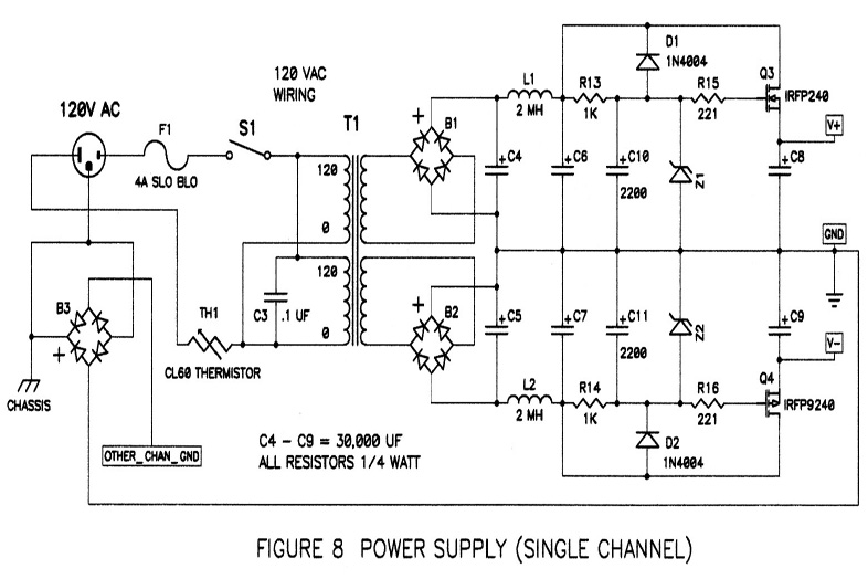

Dose anyone know what the Relay part number is in the 'Power Switch - Rush Current Limiter' schematic for the 'inrush current limiter for big transformers'?
or is the 'inrush current limiter for big transformers', I am using 600VA with each AJ-X mono amp, not required?
Thanks for your help.
What device are you referring to? All you need is a CL60.
I am referring to the five Relay Switchs noted 'FINDER FIN40.52.9' in the following schematic PowerSwitch.pdf , are these 'CL60'(s) ? or is there another part number I should be looking for?

adding a Choke to a CRCRC power supply
I am concerned that there is no Choke on the Aleph JX power supply, file name PowerCaps.pdf , I am thinking of adding a 8mH coil to the power supply with more capacitors, making it a CLCRCRC, is this a stupid thing to do, because I am undecided about which one to use because I have an understanding of how the CLCLC works and do not understand how the CRCRC can do the same thing but I have been lead to understand that it dose, or is it just cost effective, so I thought I could just combine them. Is this ok to do or will I have some problems other than making it cost more.
(33kuF+33kuF)+8mH+(33kuF+33kuF)+1.5Ohm+(33kuF+33kuF)+2.5Oh(33kuF+33kuF)
I intend on using the 33kuF=33,000microFerrids because of price and I was lead to believe that it is better using twice as many capacitors of lower value than using one with high value, can someone comment on this please before I purchase my parts, I will be purchasing my parts as soon as I recieve delivery of my eight 2SJ74-BL transistors.

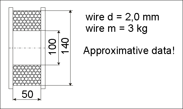

The 8mh coil will be HUGE.......
About:
you may be right, the 8mH coil is big and expensive, but I was influenced by Nelson Pass(s)Zen Variations#5 page7 power supply with a 2mH coil I thought it said 10mH that is why I chose 8mH first, it was my mistake thank you for drawing my attention to it. and I was also influenced by www.kk-pcb.com/power-x.html Aleph X power supply which uses a 1.8mH coil. I will use a 1.8mH 10awg 0.14Ohm costs $72.97, at Solen Solen Electronique Inc. Dose anyone know of a less expensive coil that will work?

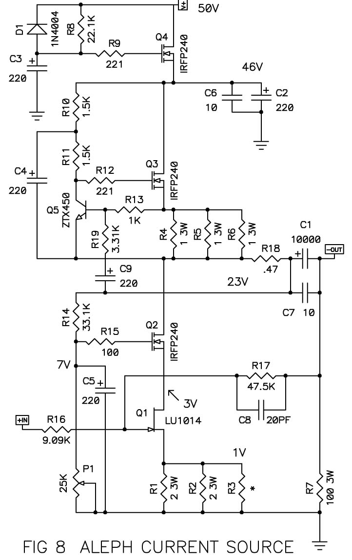

Are the transistors on this schematic power supply required or do the CCS transistors on the AJ-X do the same thing?

Oops, you are speaking about PSU choke, mine is for speaker X-over - without core...
Sorry!

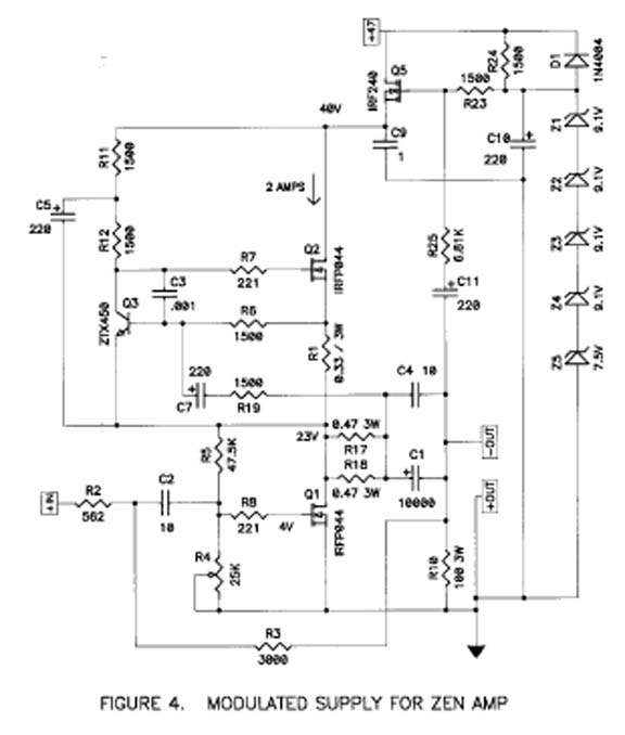

May I suggest that you study all of the Zen articles more thoroughly before you attempt to build this unit. You would be wise to explore the operation of the Aleph current source very thoroughly, maybe even build a Mini Aleph, before you attempt the X amp. Knowledge is free, but it requires a step by step approach and takes some time. Building this unit is quite different than baking a cake, the AJ-X does not use CCS in the output section, it uses Aleph dynamic current sources.
I do appreciate your eagerness, but please study and learn, we are all still learning.
Best, Bill
error referring to the CCS and the Aleph
Yes I have studied all of the Pass Projects, some of them I should read again. When you said "it uses Aleph dynamic current sources", is this similar to the "modulated supply for a Zen Amp" Page3 Zen Variations Part3 ? I know it is in 'Zen Variations Part9' I was not thinking when I said "CCS", I meant IRFP240(s)used for its modulating power supply, I think this is correct,is it? I have been thinking of it as being a CCS power supply that modulates, I know it dose not make sence because a CCS dose not modulat, I will begin to think of it in its own way of working without thinking of CCS first, I dont know why I have been doing that.
Thanks for pointing that out so I will look over the Pass Projects again now that I have a better understanding of what I am doing, I will probibly make more errors but I have been trying, but I have not been thinking clearly lately.
Best, Bill
