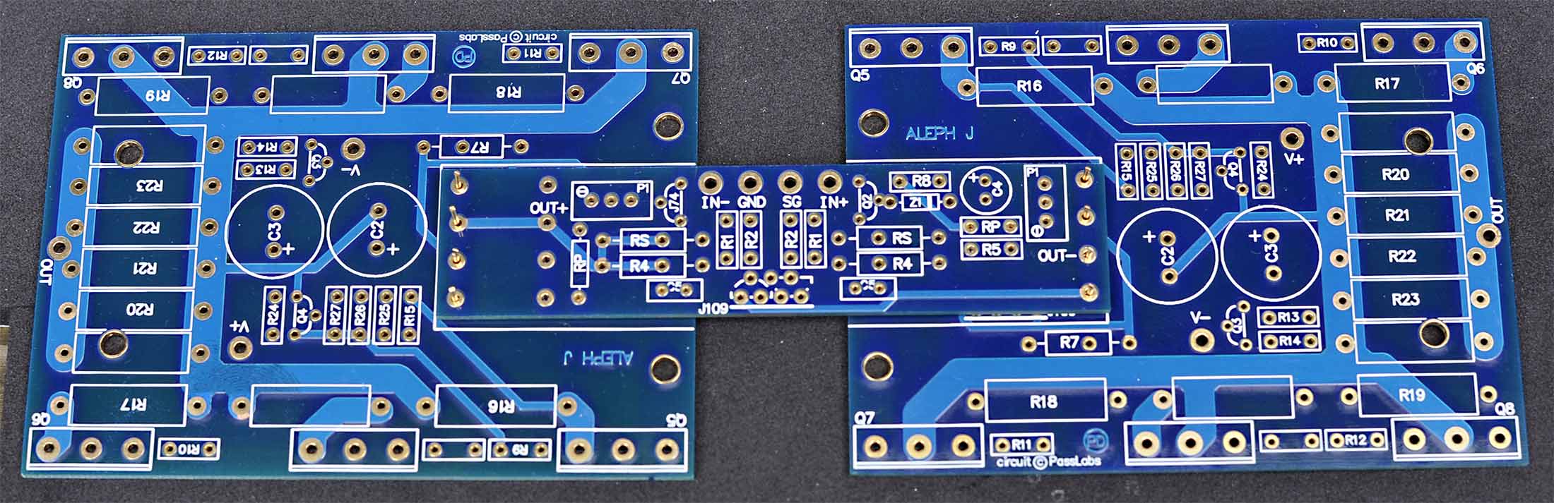

"The additional mosfet pair is for people who need more power; it's only an option but since the board size allowed it, why not keep it?"
I thought these jfets can load max two pairs of Mosfets .
For more Mosfets we (2x3) have to cascade jfets, dont we? javascript:smilie('')

It could, if it was enough space. You may still manage to drill some holes, if really needed.
However, why complicate things, when the the X-Daughter board mounts directly into the pads on the two output boards (using pieces of wire)
Previously, there were complains that the boards were too small, now we have a single, full size assembly

I used cut-off wires from film caps to mount the daughter board on my Zv4j. After several are soldered, it is sturdy enough not to need the mounting hardware.

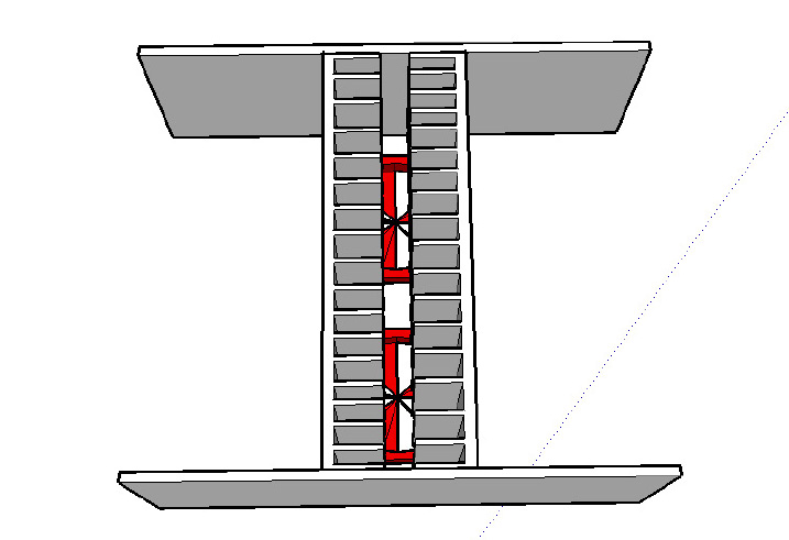

The Conrad MF35-151 is good for about 107 Watts at 30deg rise. Since I already have them on hand I am consider using fans to increase the dissipation. Does anyone know how to calculate the additional benefit of the fan.
I am considering a chassis layout with the heatsinks fin to fin essentially creating a bit of a chimney with 2 fans pushing air through the bottom. Will this work? Any thoughts please share.

2sj74 pin config on board
Peter, sorry for prior post- I accidentally sent it midstream.
My question is, how should the 2sj74's be soldered to the board?
Holding the board vertically, the holes on the board look like this:
o o o
o o o o
I saw the picture of your populated board, but still can't see the pin configuration - any way you could graphically show what pin goes to what hole? I know this sounds like basic electronics for dummies, but please bear with me. Thanks!

I haven't used fans myself but Papa has said in the past they are very effective. I'd definitely use a couple thermostats (belt and suspenders) for safety in case you lose a fan.
