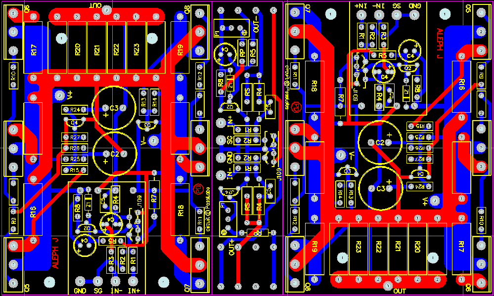

This is the latest board revision:

Yes, that's ONE board and the price will be approx $18.
This is good for a stereo Aleph J, two of them are needed for stereo AJ-X. Copper will be thick enough, as with my other F amp boards.
Lead spacing on R1 is 200mil, which is good for Caddock MK132 and Dale CMF50. For Vishays S102 you need to "spread" the pins slightly, but I never found it a problem.
