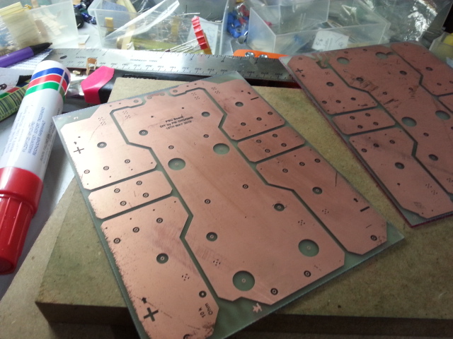

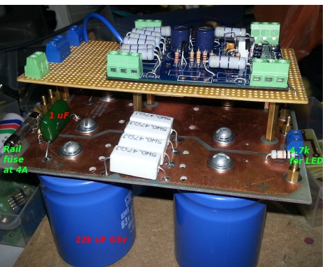

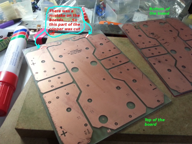

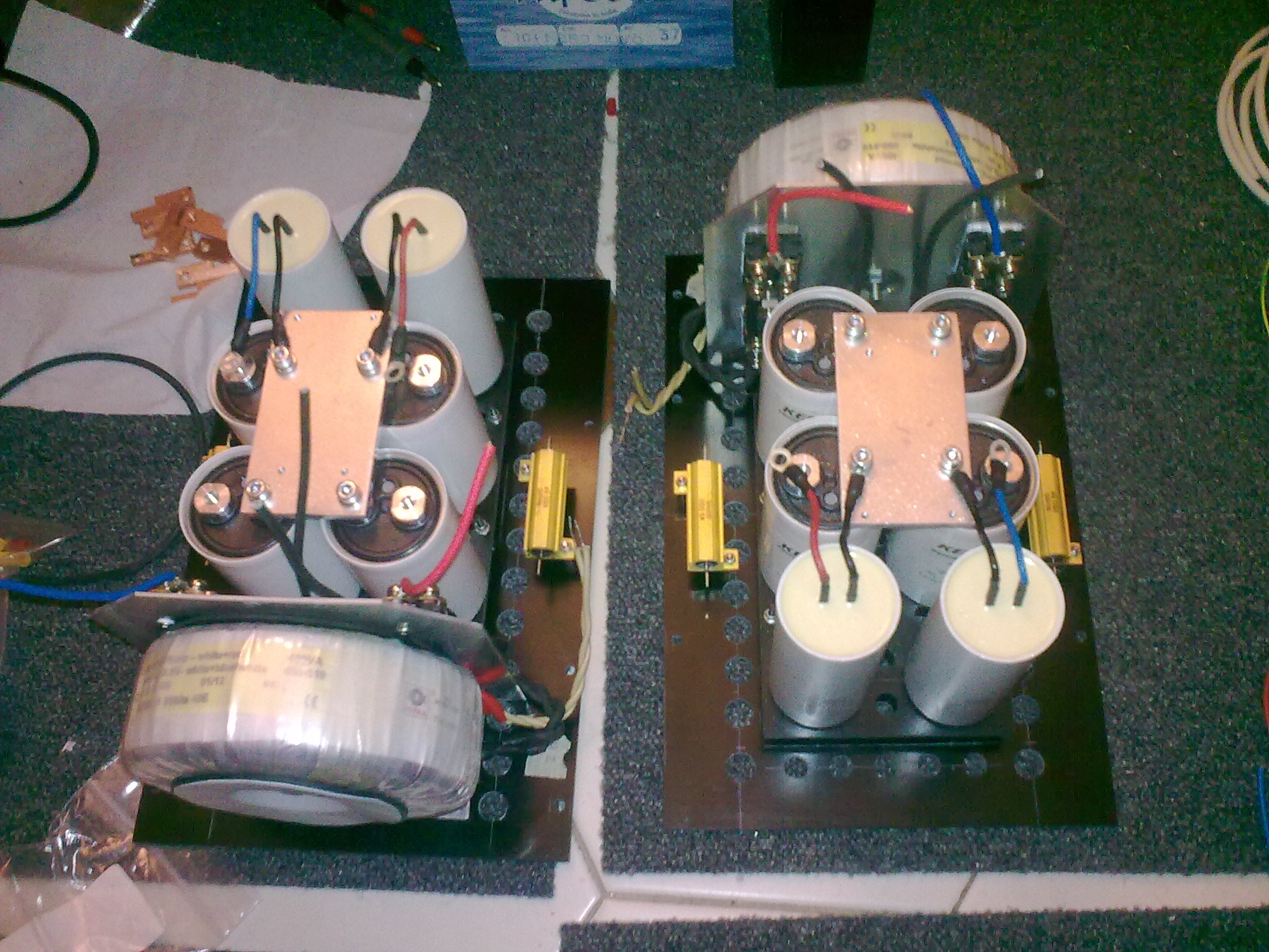

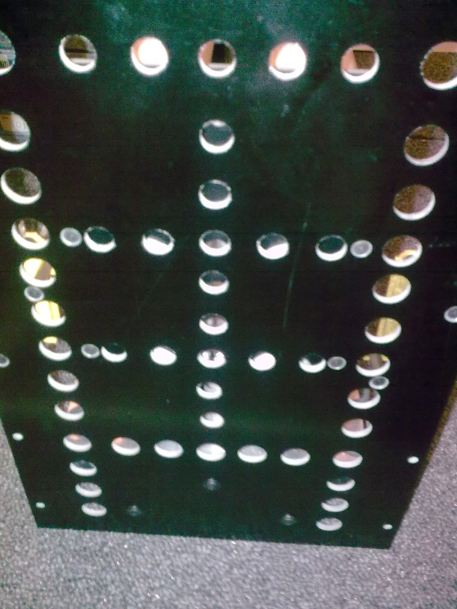

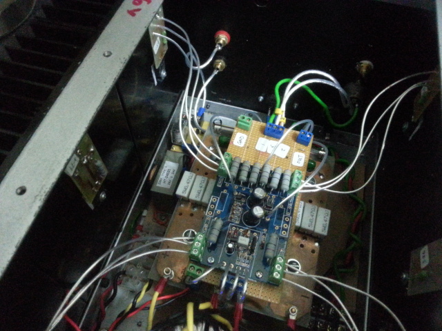

the bottom has same lateral holes as the top plus some holes in the middle(same holes you can find on the board that holds the caps as you can see in the 3rd picture)
I was thinking to use some 5mm distantials between bottom and fixing system.
what do you say? will it do the work?

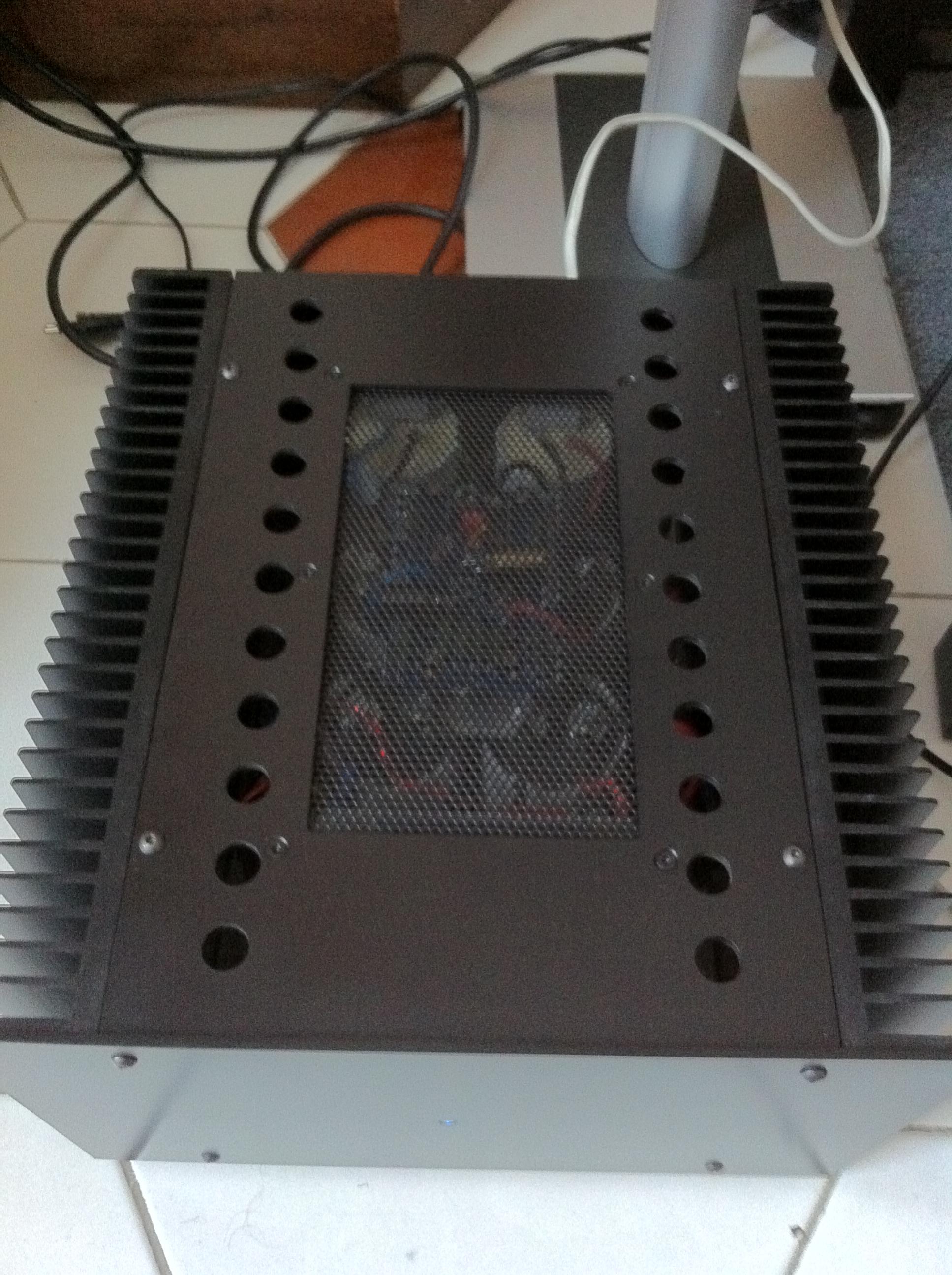

top is almost 5 times more opened than the bottom
better than the other way round
that perforated plate looks very open

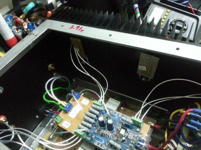

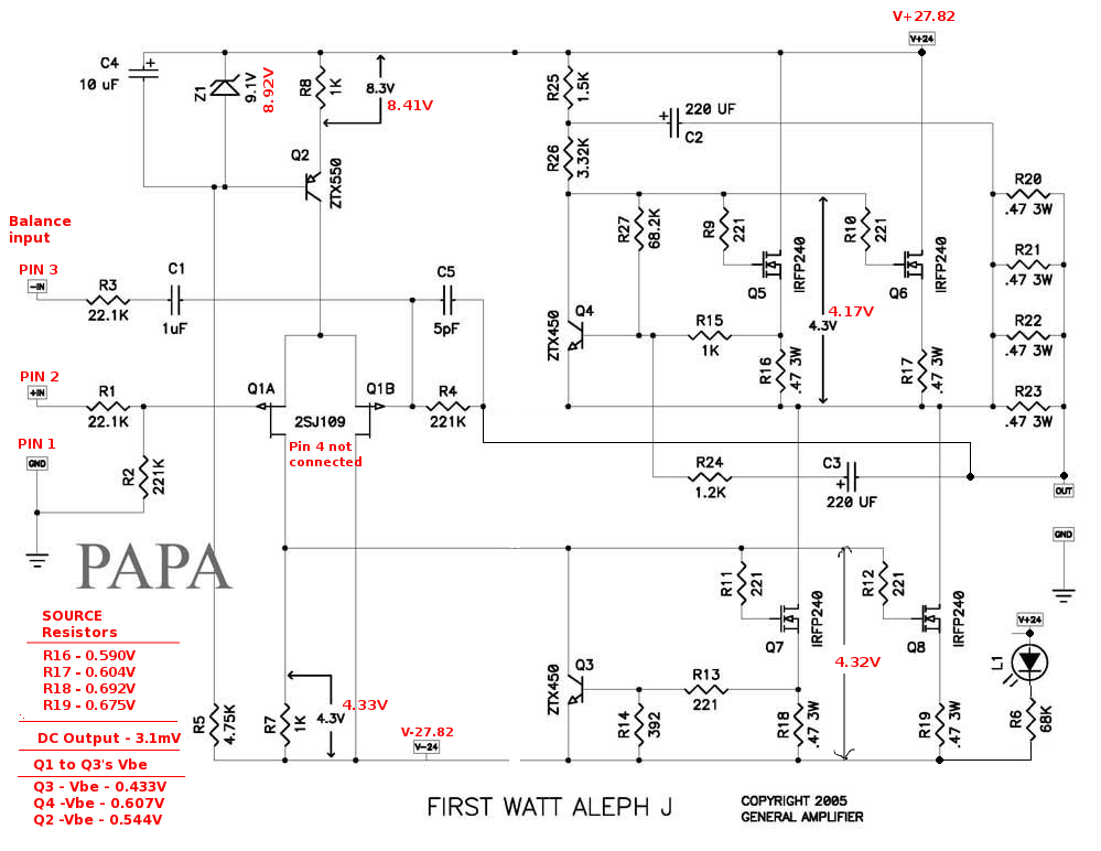

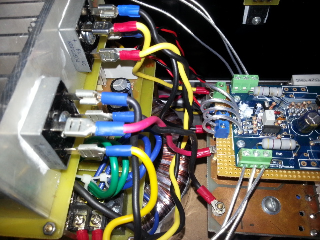

Hi All,
I have a problem with my mono Aleph J, which is very similar to Anilva's. Please see the attached measurement (in Red)of my Aleph J. The only thing I am not sure about is the Q4's measurement.....which seems out of place. The sound from the Aleph J's will distort when the volume is increase....just around 1/4 turn of te volume knob only. The other things that I have noticed is the heat sink is not heating up well and the rail's LED (i have a LED in place at the power supply rail since Peter's board doesn't have one) stays on at least 15 seconds after I have switch off the power supply. Thank you in advance.

judging by voltages across source rsistors , you're having decent Iq ( around 2A5) which gives around 135W of dissipation with 27V rails
however , taking in account what you wrote for PSU leds , something is wrong - you can't have 130W of heat and cold sinks , same as slow dying LEDs with 2A5 Iq
pictures ?
pictures ?
- Aleph J Schematic
