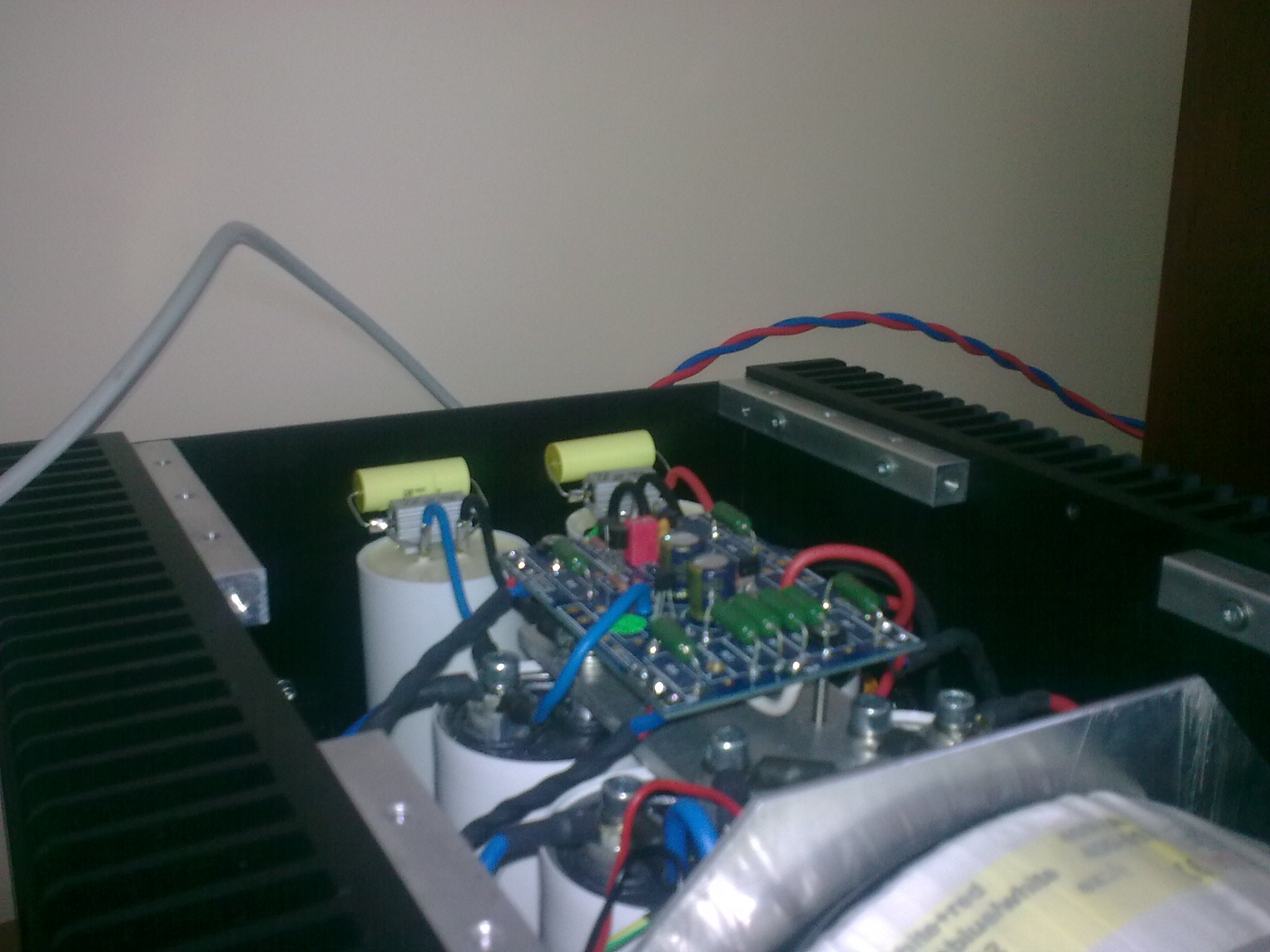

mmm...no they are not except few seconds after turn on but after..dead silent, the trafos and speakers too (ear @ below ~3cm distance )
forgot to mention that at one trafo the turn on noise is greather than at the other that practically has it very low almost insatiable
could this be due to secondary windings that are tied missmatched ? or it doesn`t count this...
I am content with the actual comportament of the J, sink temperatures below 50C, trafos 40C(on their aluminium support are mounted the rectifier diodes too which have a temp of ~70C) all these are measured without top plate at which I am still working for better convection venting.

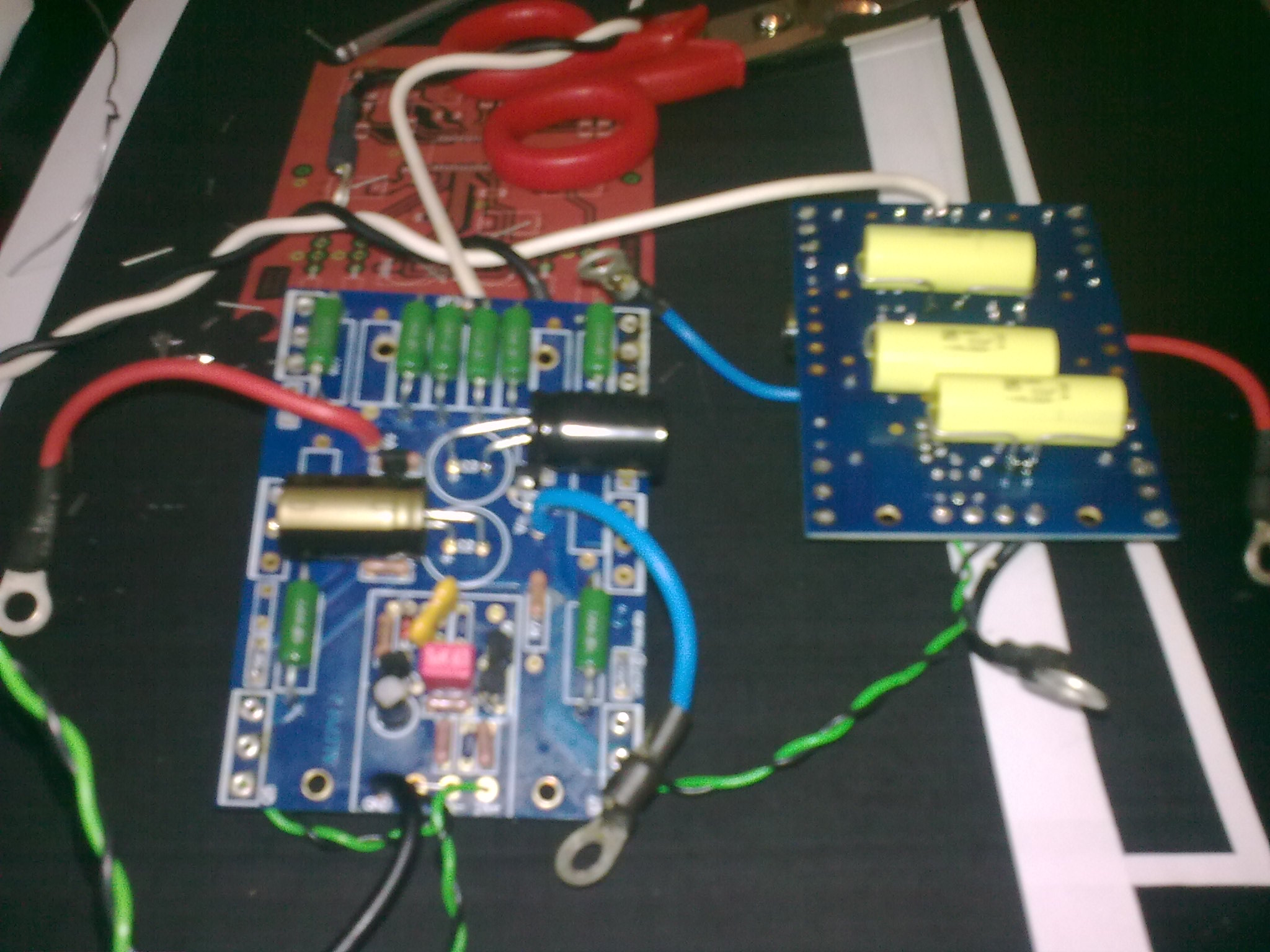

I replaced original panasonic fc that I was using with elna silmic II and bypassed them with 2,2uf mkc as Master Zen recommended.the new caps are already burned in , since when I got them untill now, when I decided to replace them(almost two months) I kept them @12V, filtering my dac ps, which consists of lithium cells.
my dc offset is somewhere @ ~50-60mV.I was using pots for offset adjustment and got C1 shorted, don`t know exactlly which of these got my offset oscilating ~80mV and for this I renounced at the pots and unshorted C1.now my offset oscillates only few mV , below 10.
the bias will remain the same 1.6A/fet , don`t want no more to hear from pots in my very stable amps
what I can say about the sound is that is marvelous, seems like these caps are making a difference
THANKS ZEN
