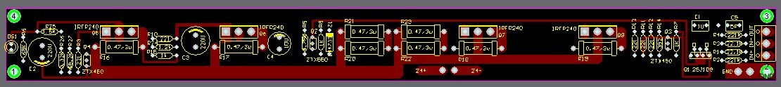

my drawing
looks like your IRF devices will be on the located on the heatsink in the same fashion as the board will be. Meaning that the board will be mounted on the sink by holes 1, 2, 3 and 4. It looks like ground goes to one of the 4 mounting screws for the board. If you ground that screw/bolt and then put it into the sink and then if you attach the IRF devices to the same sink you may short the mosfets. Maybe I am seeing it wrong, but thats what it looks like to me. Even if I was insulating the mosfets this would make me nervous.
Uriah
It can not be short! I can seperate the bolt from the sink!

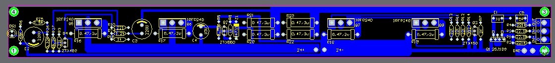

my drawing
Interesting trace between R11 and Q7, adventurous guy.

Can you give more advice?

he sez that mosfet gate resistor must be situated near mosfet gate .
more
1st rule of pcb design : do not run a high current trace directly in parallel with one that leads to/from a high resistance load.
R11 is low resistance, but the input impedance of Q7 is definitely not.
You'd be in knee deep doodoo if Q7 was a lateral MOSFET device. (in particular with gate stopper R11 at such a distance from Q7)
